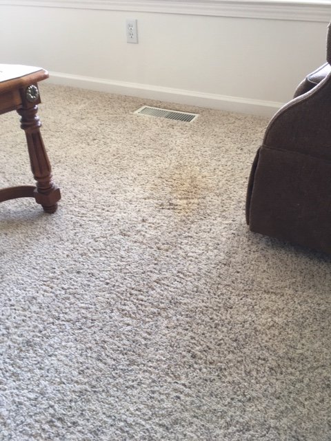

Ever notice how fresh coffee spots are harder to get out than old ones?
116,256

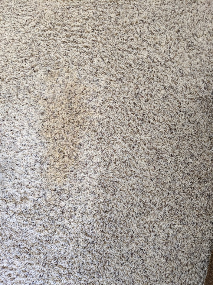

two day old Folgers Black Silk...
Soaked it in 40 for 30 minutes,cleaned with UPE, rinsed, soaked and rinsed two more times and this was it soaking again..
Left it submerged in 40 over night....

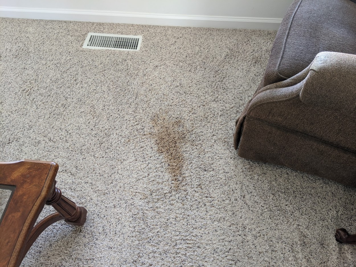

Well, fook..
I can't recall a time when the overnight covered 40 volume trick didn't work..
But he just sent me a photo and it doesn't look any different then after rinsing...

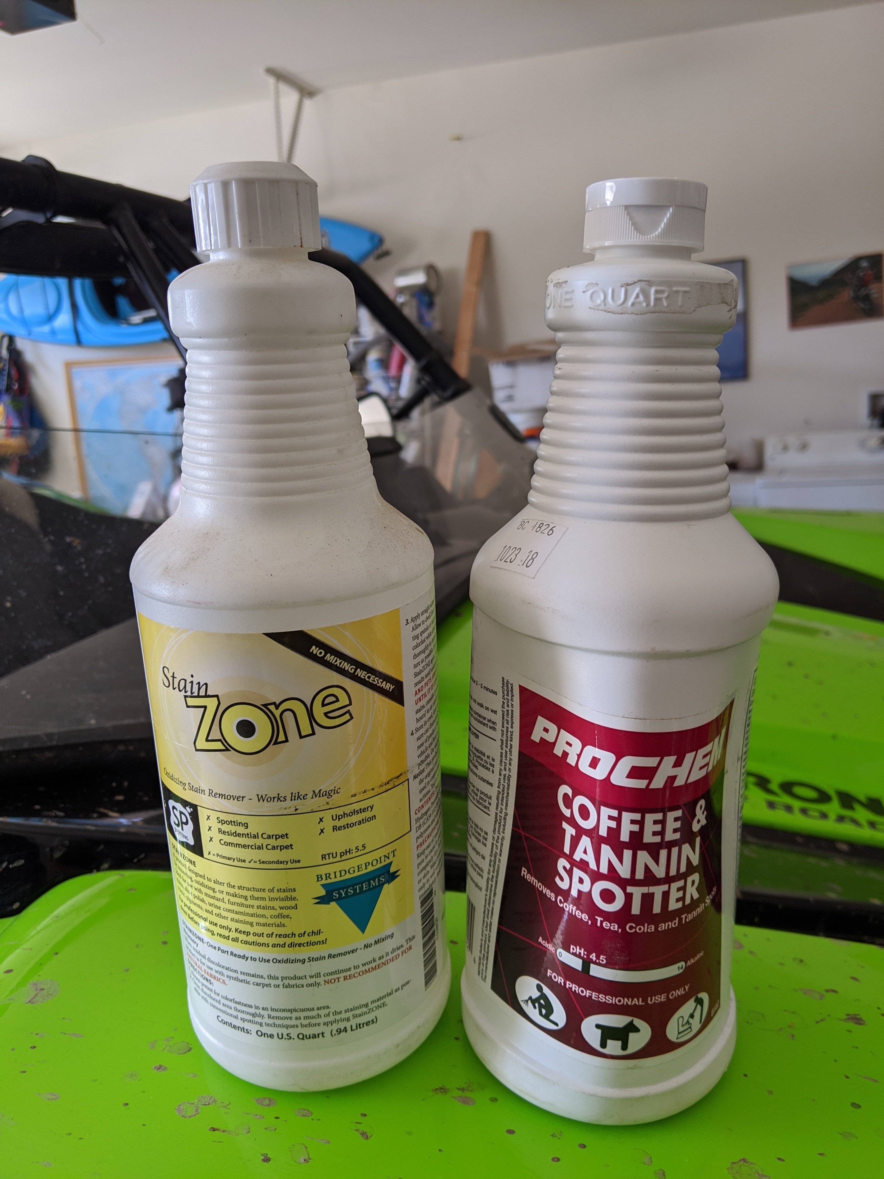

I have these two products, what would you use and why?
6,544
Bc
There’s dye in that coffee stain.
I’ve removed curry (turmeric) with stain zone before, BUT, because it is peroxide based, it needs to be fresh. I followed Bridepoints stain guide, and used that, and a UV light....
But WTF do I know....
