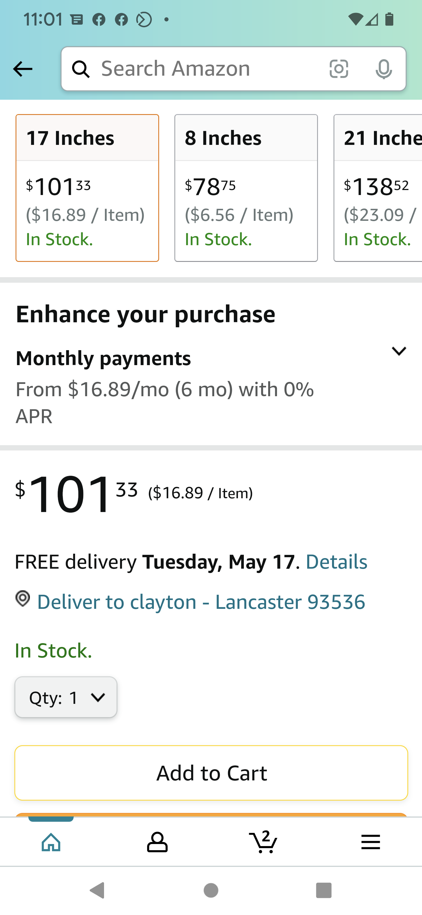

17" Microfiber Scrubber Carpet Bonnets | 6 Pack Amazon product

That says they are unavailable. I tried to order from Excellent Supply, but when I was at checkout, estimated shipping was àround $500.00 usd.

I was able to add it too cart

Amazon ad say not available if you expand it
They seem to be back in stock.
It goes based on your address.. 48 states it'll send.. Hawaii unavailable.. If I use a friend's address in Las Vegas, it'll sell and ship..
I'm sure you being in Canada is the real issue.. When I search for things, a lot says unavailable but if it's a 48 state address, soo much more options show up.. It is what it is..
