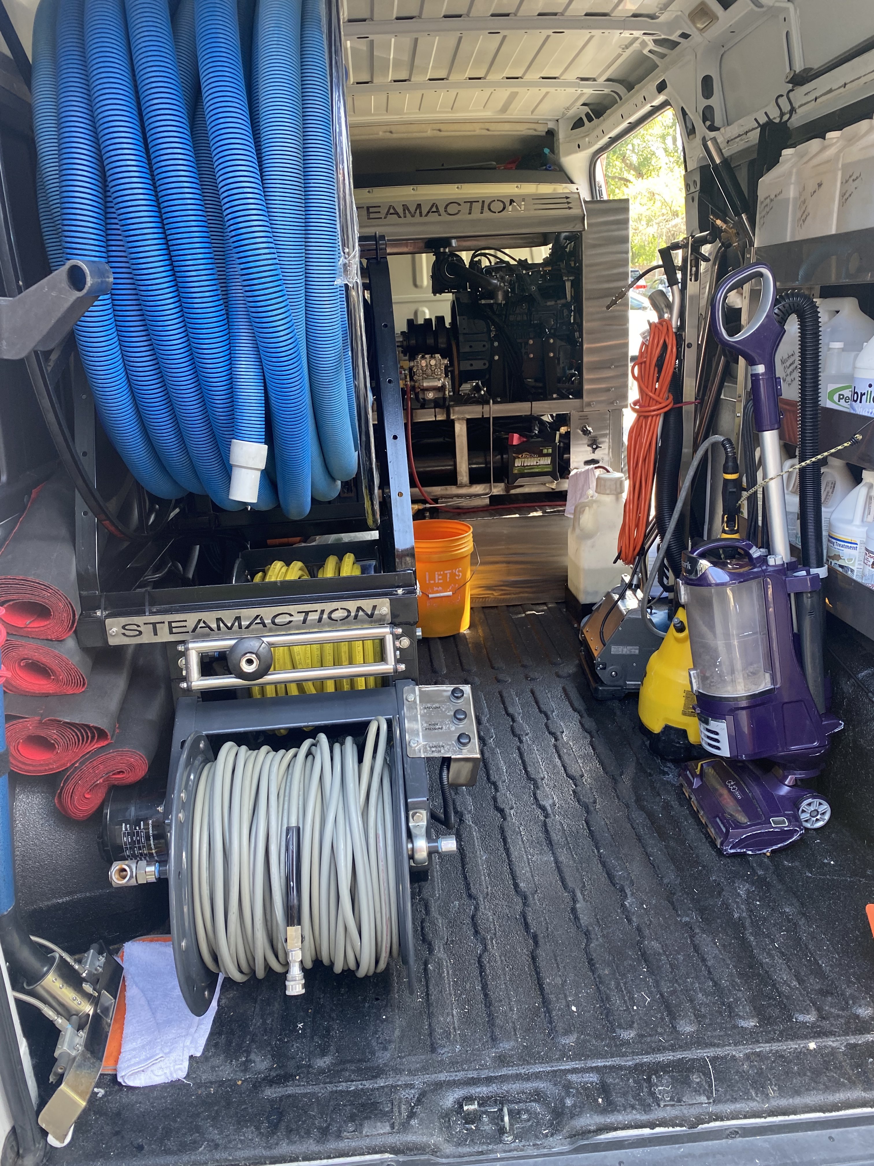

It's a must have for owner ops. You're wanding all day, the last thing you want to do when you're tired is roll up that vac hose. I waited 14years before I bought mine. don't worry about how much it costs. Just get one. The one from steamaction is the most impressive. And there's a dude in Atlanta that makes one similar. I can't remember his name. Someone on here can highlite on that. He made crappy garagemade truck mounts before he switched to hose reels

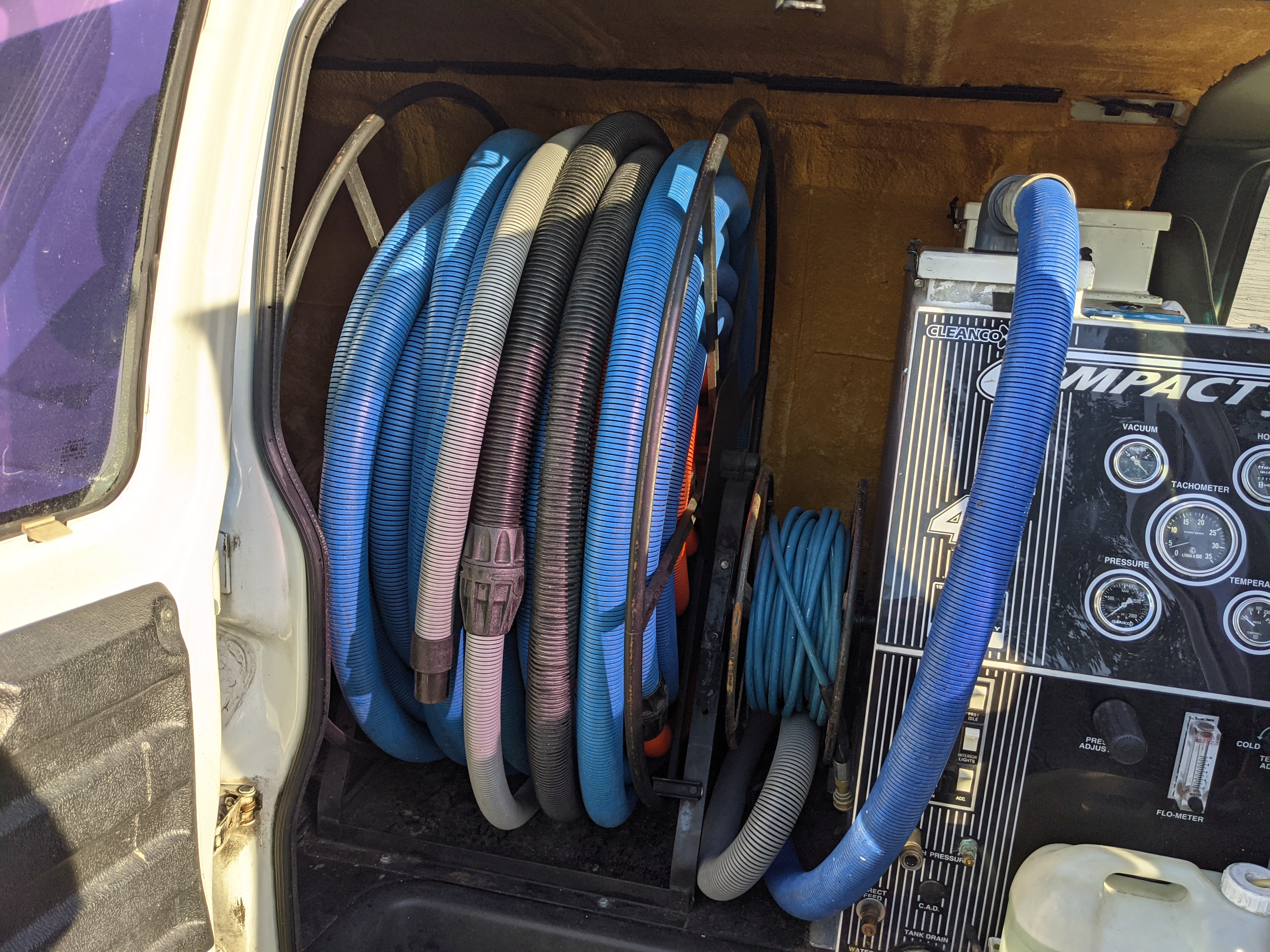

In my opinion, an electric reel is one more thing to go wrong. I am 63 this year and have no problem rolling up hoses on a manual reel. Hell, on my other truck I don't even have a reel. I coil and hang my hoses. Takes no time at all. Electric reels are for wimps and nerds.

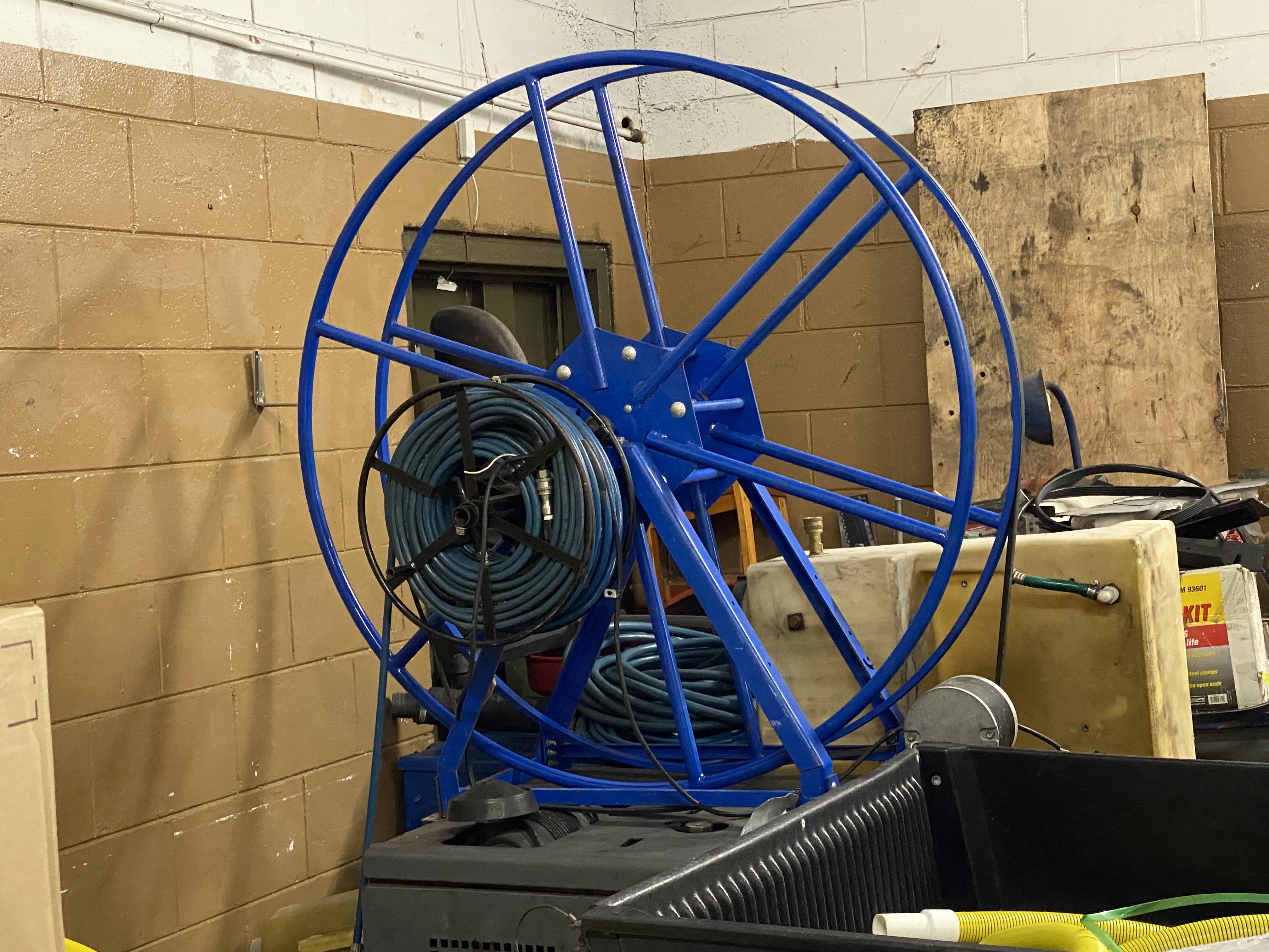

well I guess Im a wimp and nerd. I tore a back muscle after a long day of cleaning back in the day. Electric hose reel is like putting a glide on a wand.
Best electric hose reel is a Water Pond, hands down. Comes with a free water tank! IMG_3868(1).jpg

Doesn't make sense that you tore a back muscle rolling up the hose on a reel. Probably tore it on that long day slogging the wand but didn't feel it until the end when you had to wrap things up. My reel is right beside my side door. It's well balanced and easy to roll.

I found a screaming deal on a water pond a while back, like 2k for the 6k unit but could not find a way to make it work in my van without completely ripping everything out and putting it back together. Maybe on the next van.

For a 20 year old van, it's in great shape. The reel is so easy to turn I don't need any help. Different if your reel is mounted deeper in the truck. One of the things to think about is, what happens if your electric reel malfunctions? Blows a breaker or fuse? How difficult is it now to manually roll up your hoses connected to an electric drive motor? Can you easily disconnect the motor from the reel?

Disconnect the belt and it's just as easy as a reel without the motor.
FB7777
You have no idea what you're talking about.
So Hagopian doesn’t churn their trucks every 5-6 years or have electric reels?
Im not the clueless one there Mr broke truck Chuck 😂
Regarding your heap…. Your picture confirms EXACTLY what I’m talking about
Your Debby downer ‘what if’ scenarios are why you fly solo and are afraid to expand ( more likely intellectually incapable )
Electric reels rarely if ever malfunction… which is why most successful operations utilize them
$6200 today in 90 degree heat and all 3 electric reels worked flawlessly :headbang:

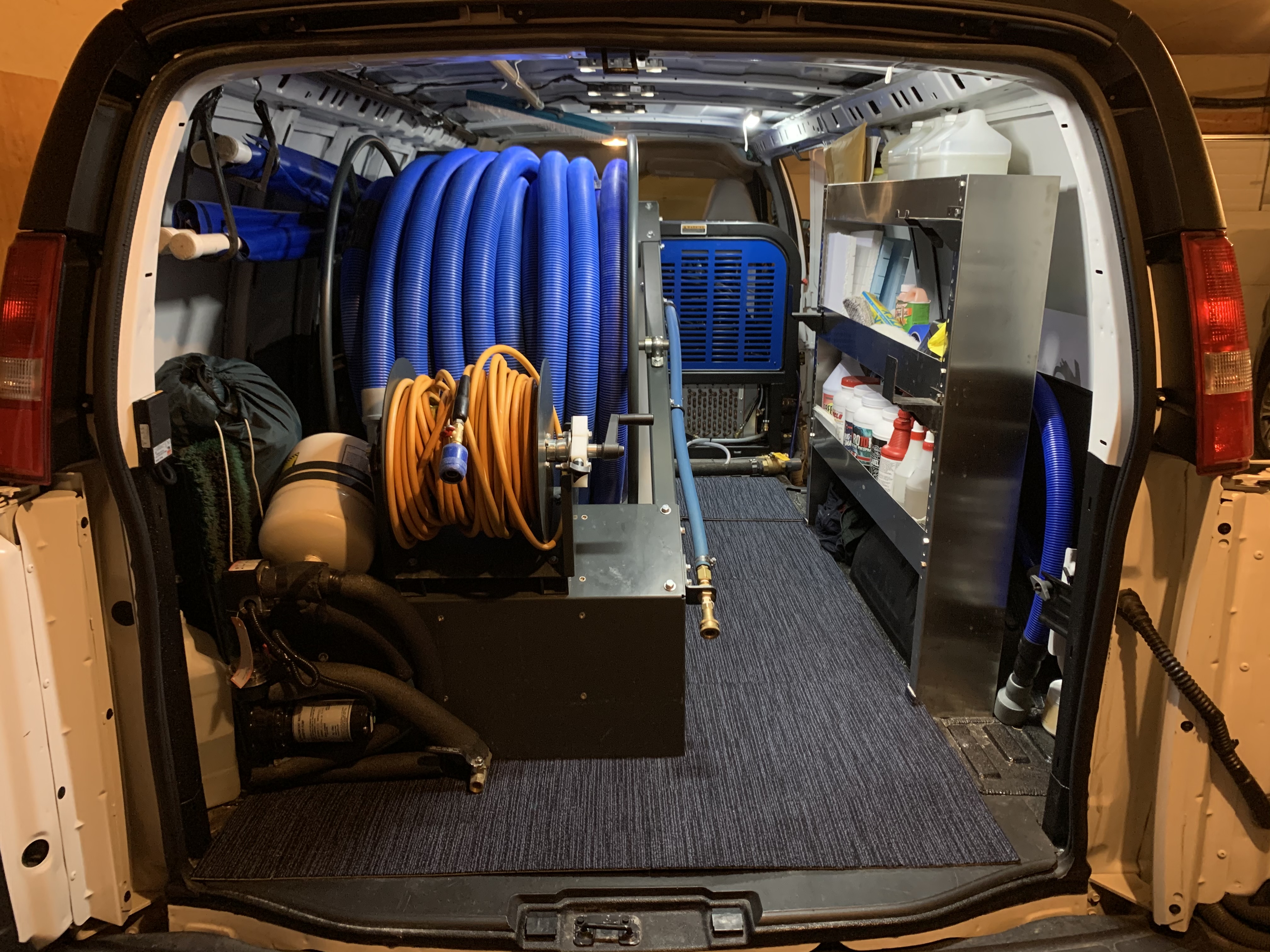

In 7y ears of my diy powered hose reel, I had to push the 25amp breaker in 3 times to reset it.. When I had it manual, I hated it because the slide-in TM was right there..
If you can afford it, get it.. If not, carry on.. You’ll get it done one way or another.. But why work harder than you need?
Guys still hand-coil/carry their lead hoses in.. The reel just gets them to the front door..
