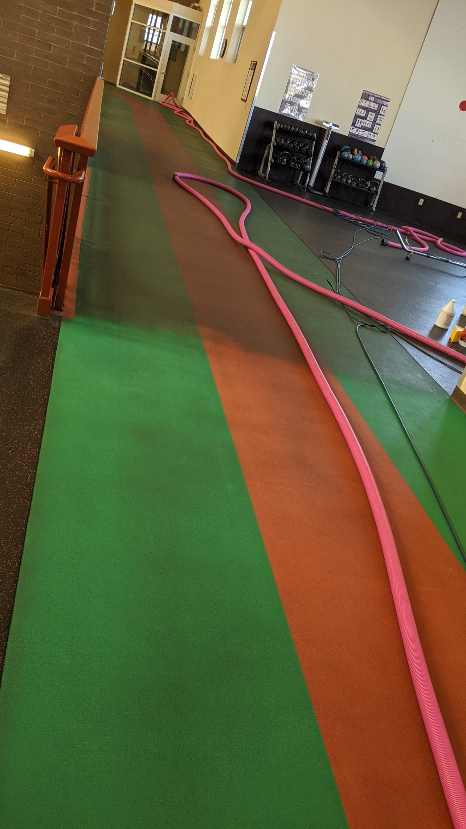

Done rinsing the rubber floor now I need to buff it off
116,254
Much like a white Olefin, this fn rubber track is blotchy.
The closer it is to the parking lot the worse it is they re slurry the blacktop and it gets so much foot traffic it's unbelievable we got all the grease and grime off but the left behind blotchiness is driving my ADD nuts
I got to go back on Saturday and try and fade it in pad it out or do something... and I have limited supplies... looking for suggestions of something I can spray on and run a microfiber or cotton pad it leave behind and possibly have them run their Zamboni over to rinse out

How about an alcohol boosted neutral pH cleaner?
sometimes less is more..
hard to say without being there, but would water mopped on and redpadded over even it out?

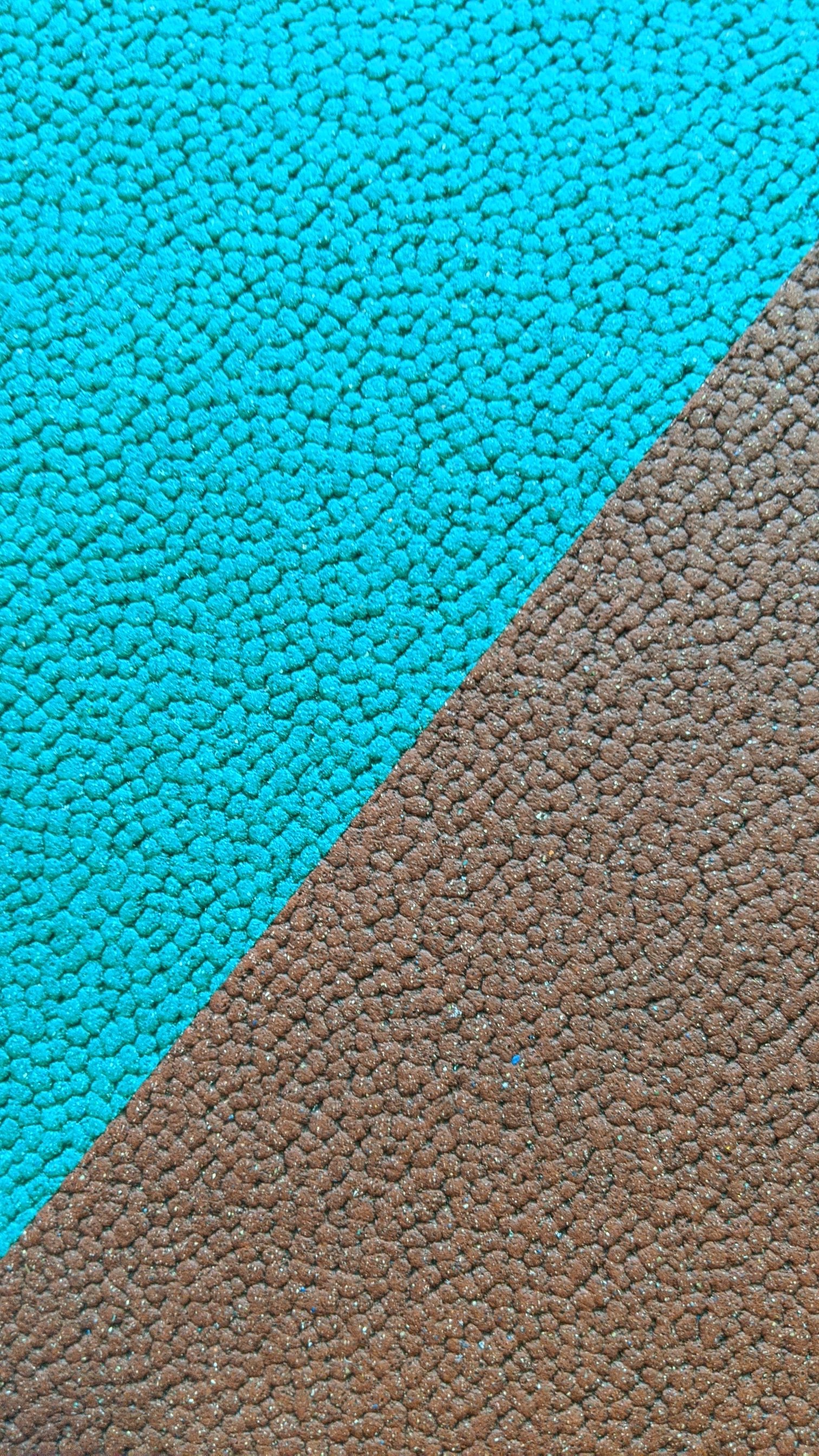

116,254
The worse area, nearest the parking lot...

Could that be asphalt walk off. If it is, very hard to remove. Petroleum braking down and being tracked in. Maybe a citrus with a good rinse and speed dry.

That black top is being absorbed into the rubber compound.
I say it's permanent and if you keep going it will further damage the surface. They need sacrificial mats at the front of the building to slow it down. Try a small area with wd-40. You can buy that in gallons and possibly add it to your prespray. ARGOSHEEN for padding options

The asphalt residue could be a great motivator for the account to need quarterly cleanings, at least at the building entryway.

I told you what to do. And you do know that they get wear patterns like carpet.The top layer gets sheared off and causes distortion. You can work yourself into a frenzy trying to fix unfixable.

@Mikey P Did you try UPE? Seems like the the perfect time for "it's cleaning power adapts to the soiling at hand" claim to shine.
