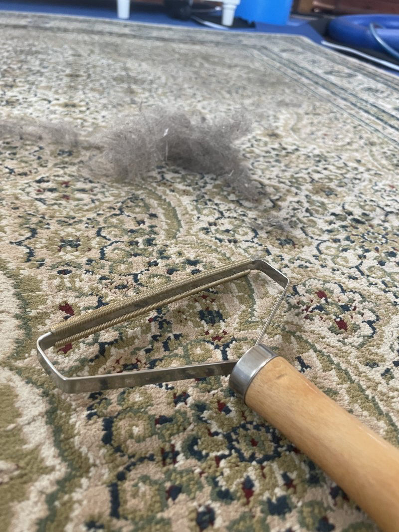

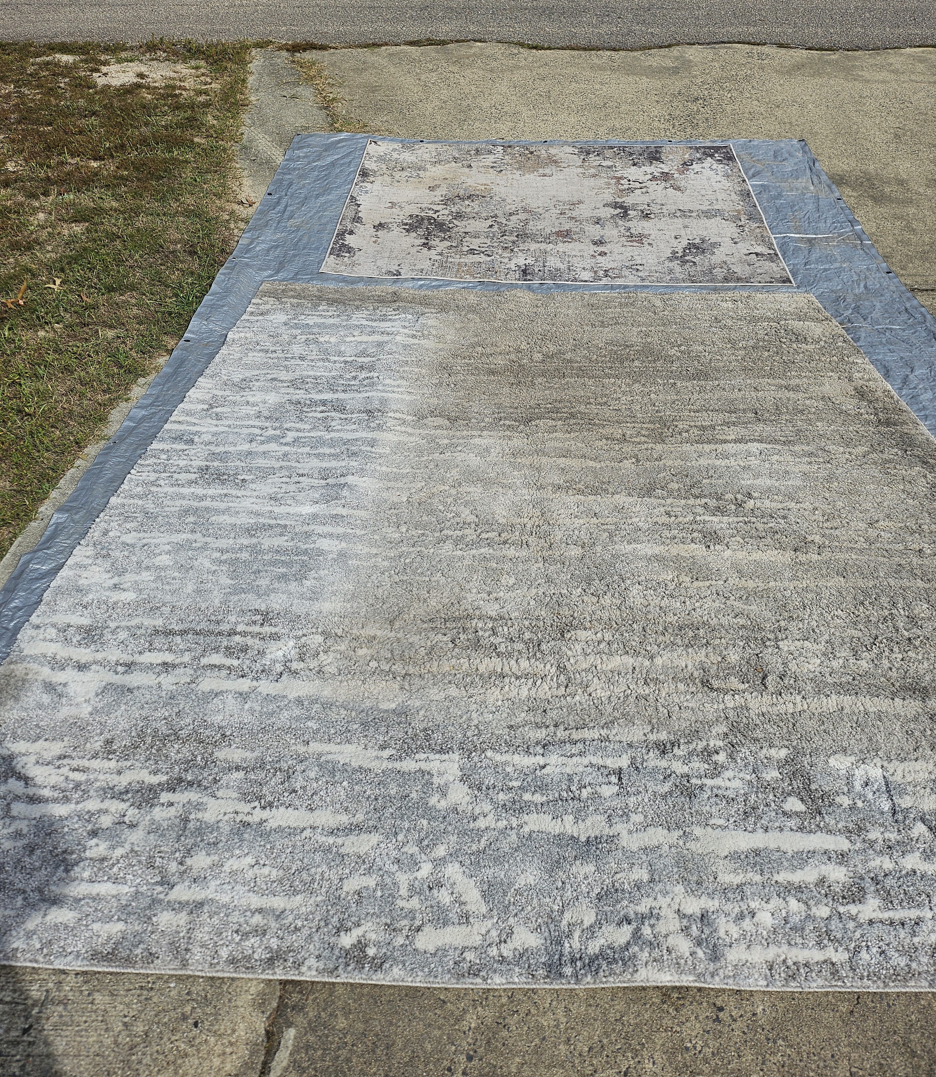

How are guys handling years of dog hair on rugs and carpets? I recently cleaned some neglected carpet and rugs and I let them know it will need a follow up cleaning to really get it 90 percent or better clean. Also they would need to vaccum a few more times over the next few days to get the majority of the dog hair out. Now to be transparent my rates are pretty basic and I'm only running part time so I'm not offering full blow life changing cleaning at the moment but plan to in the future.

I see some guys using hair removal grooming tools. Any input on that?

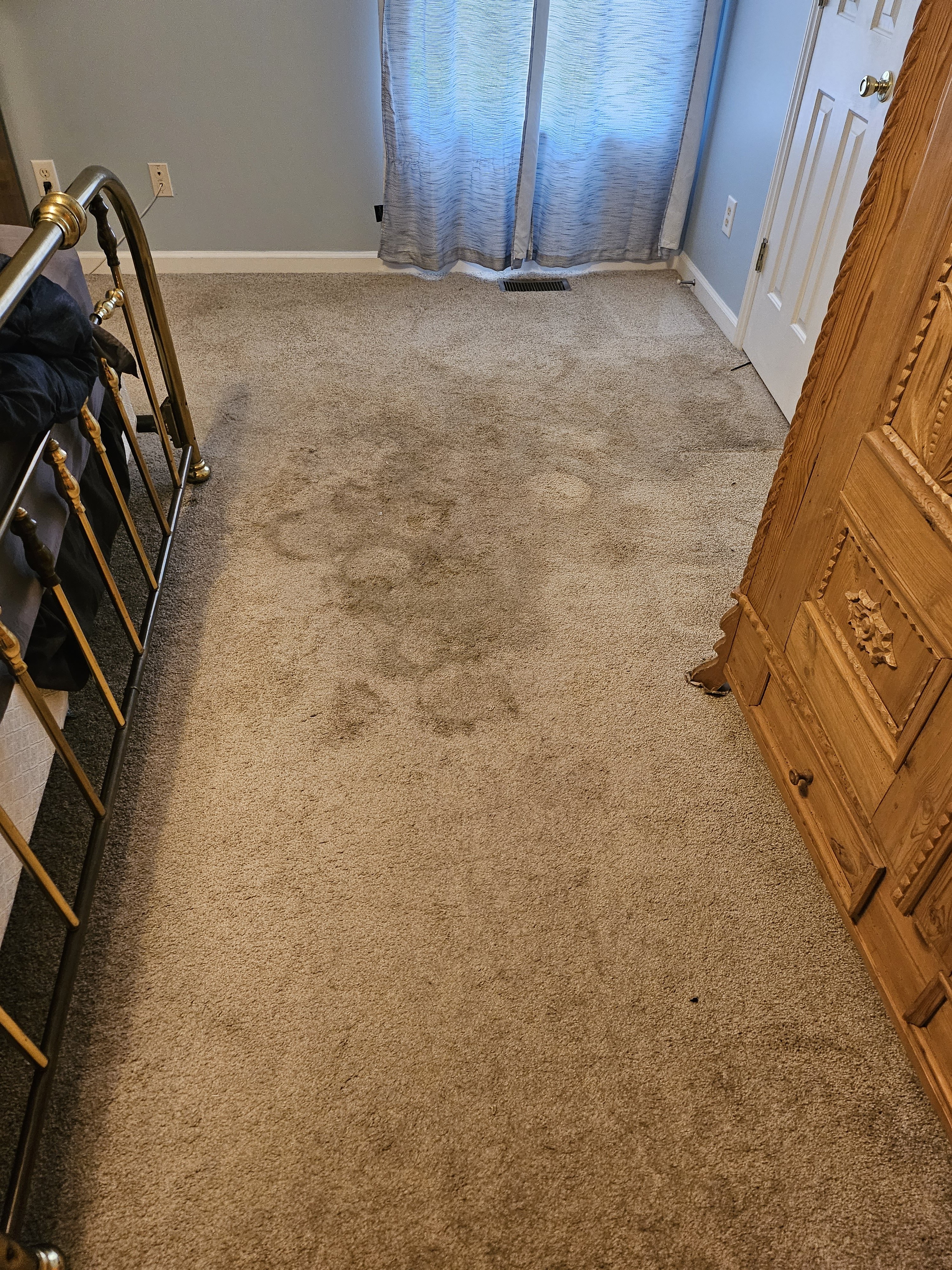

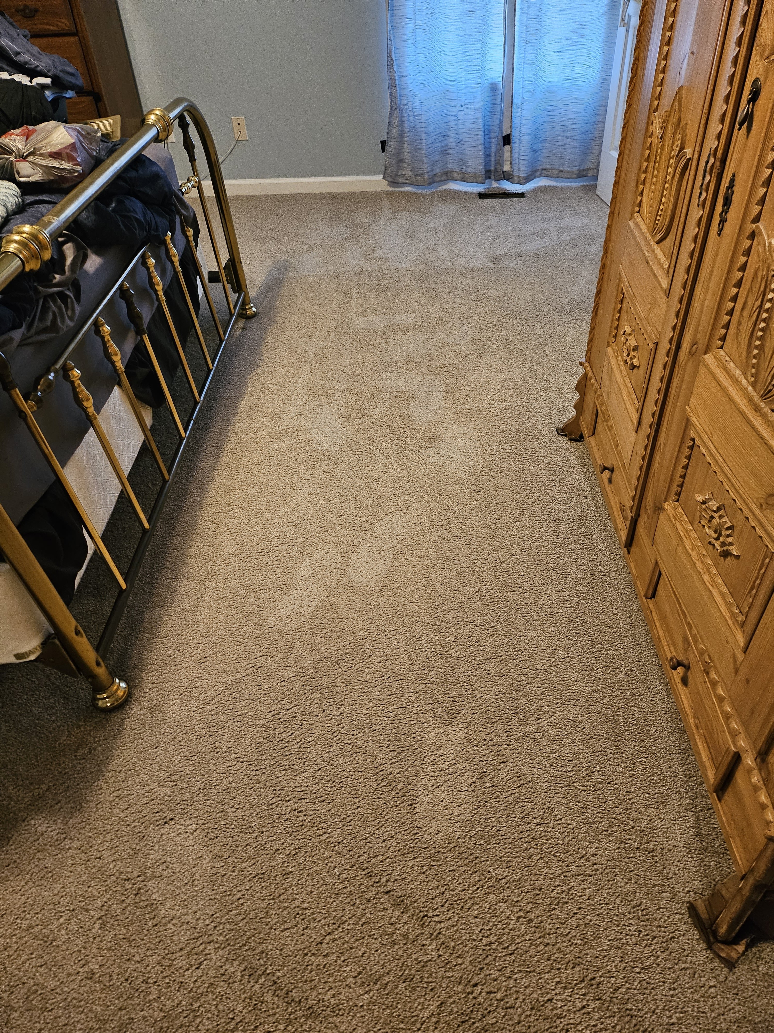

No offense, this is business. If you are just breaking intoi this business, just be aware you are planting your seeds. It may be your plan to clean for only this kind of residentioal cheap work. But I guarantee there is money in striking distance. There has to be, because its expensive anywhere to find a place to live or invest in.
Now is your chance to do high end result work. Separate yourself. Before I stepped foot into someones house that I did not know or was not family, I got IICRC certified. Then new equipment, then all in. Even if you dont go all in, you can still do premium work. Such a little investment in yourself and equipment ($) for the high end results.
It seems what you did with the rug was average, to good. Nothing for the customer to brag to her friends. If that bedroom didnt wick back at all that looked pretty decent. This would have really helped you with the rug. It will get em all.
I tried attacthing to a rake stick, it was a Pia, didnt work good, hard to store. As is works the best for me.

Hsaiiae 60" Adjustable Long Handle Metal Pet Hair Remover, Pet Hair Rake, Rug Rake, Durable Carpet Rake for Pet Hair Removal, Lint Remover Scraper for Rugs, Mats, Couch, Stairs, Black https://a.co/d/gdsL1jt

Thanks for the tips. Doing this part time only for fun until well in the future before I jump back full time. This is more of a experimenting phase so I can perfect my craft. I'm currently charging average to good rates bc there's not much competition around me. I'm more trying to create a customer base. I'll have to grab one of these. Ik I've seen others use them and wondered how well they worked.
I've seen these numerous times but wondered if they worked. That's why I asked on here to see what guys are using that have been put through the test. Have you used this one?

Gotta love the I cleaned it with some products from the store and got most the stain out... like alright thanks for making my job harder lol. So really just vacuuming the hell out of it is the best way. Those hair removal tools worth it or not really?
