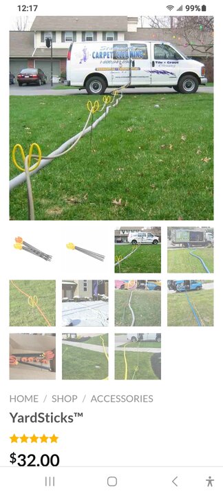

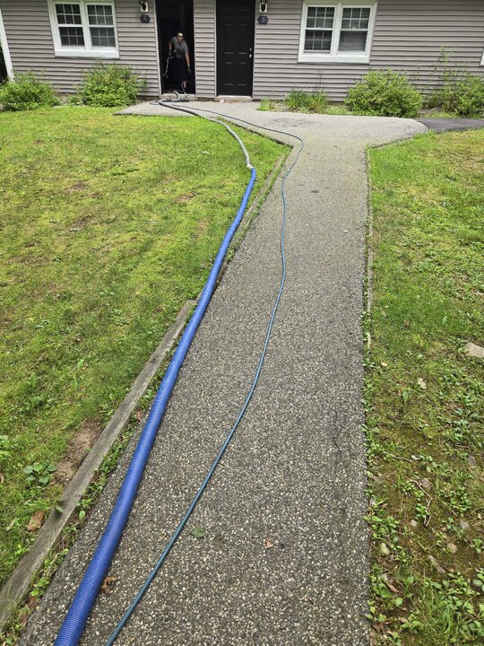

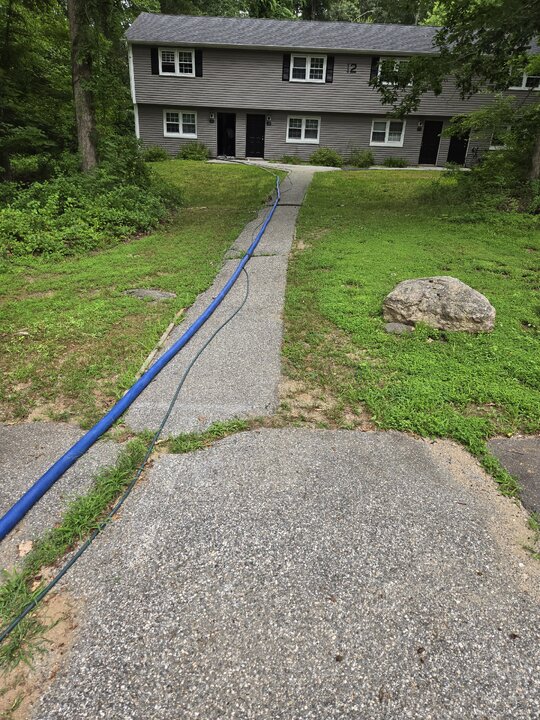

or something to keep the hoses off of grass? I order them neatly when I setup a job but then I walk out to the truck and they are all over the place. Once I get my new heat exchanger installed I am concerned I'll walk outside to discover burnt lines of dead grass across people's yards...

I personally don't have any on my van but they're on my list for my next wanders order. I live in the country and dont run into manicured lawns as as some cleaners do. When i do i at this point lay out 50 exrta feet of soulition hose. Where i live believe it or not alot of multi million dollar homes have gravel driveways but there are those times where a couple of sets of these would come in handy. But i would think you still have to be sure that the slight pulse of the pump doesn't make the hose sag and still burn the grass. I did however many years ago loose a good customer because i burnt a bright yellow strip down there brand new sod lawn
I've already noticed a few spots we've been at where we'd have to cut the heat once it is fully functional because there would be no way to avoid laying solution line on the grass. Those stakes look sweet. I'll keep em in mind!
