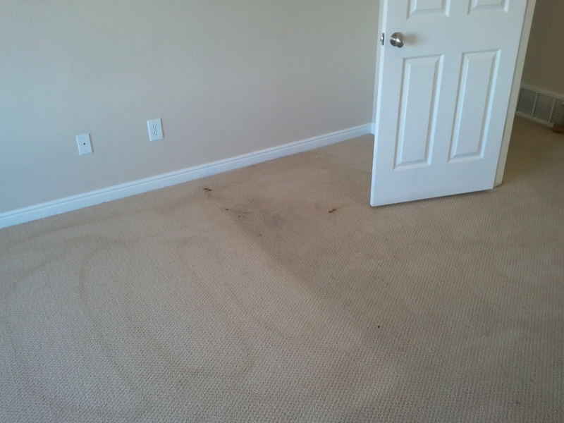

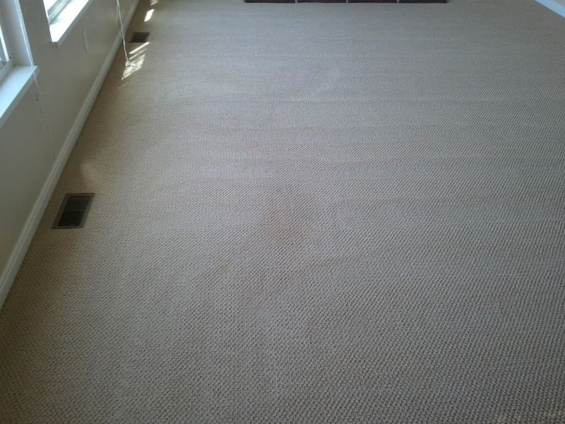

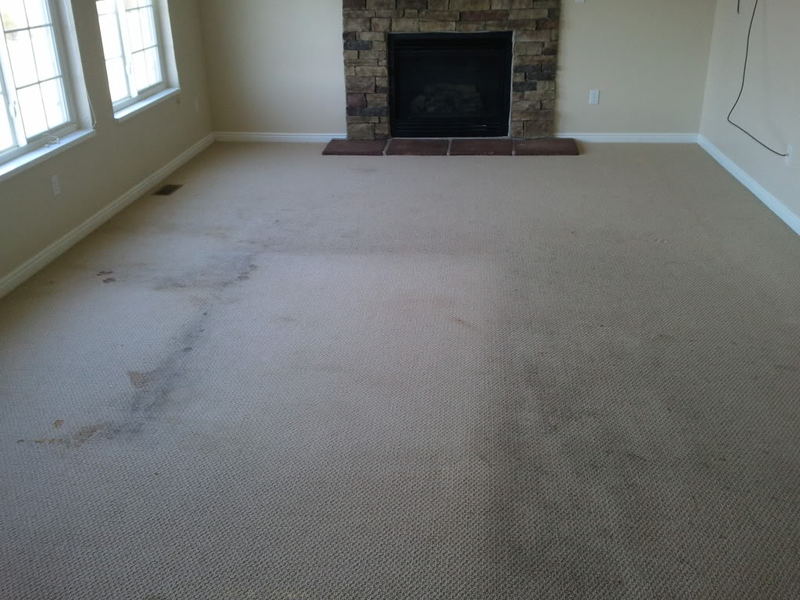

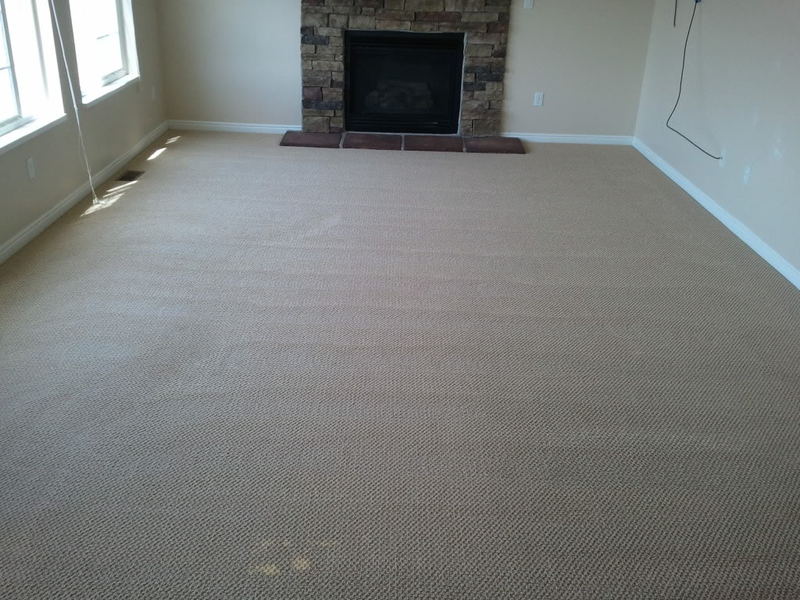

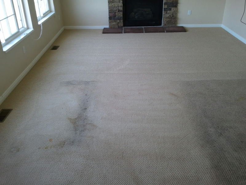

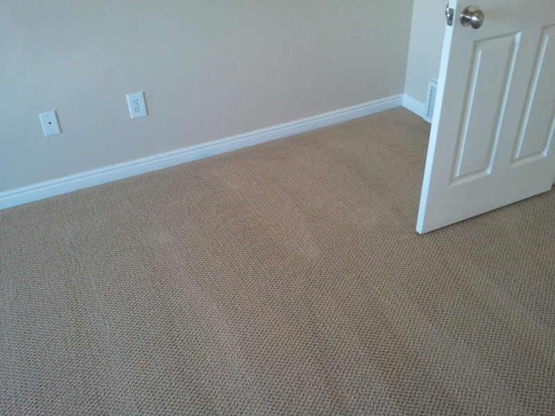

Now that i can enjoy both....i see the HUGE benefits of both....here is a house i just did...Saved them 1000s.....4 yr old carpet (2.5 really because its been vacant. but TRASHED)
6 oz a gallon of Cobbs Power max.....95% of the spots/stains came out...with just Cobbs....And no i still dont fart around with the reds and yellows...besides they lightened like crazy
Family Room.....she thought for sure it was going to need replaced.....they showed up just as i was starting this....and their eyes all but popped out
pretty swirly's why take them out????
oh Freshy water rinse to 8) 8) 8) 8) 8)
Look down 2 posts....these pics sucked
