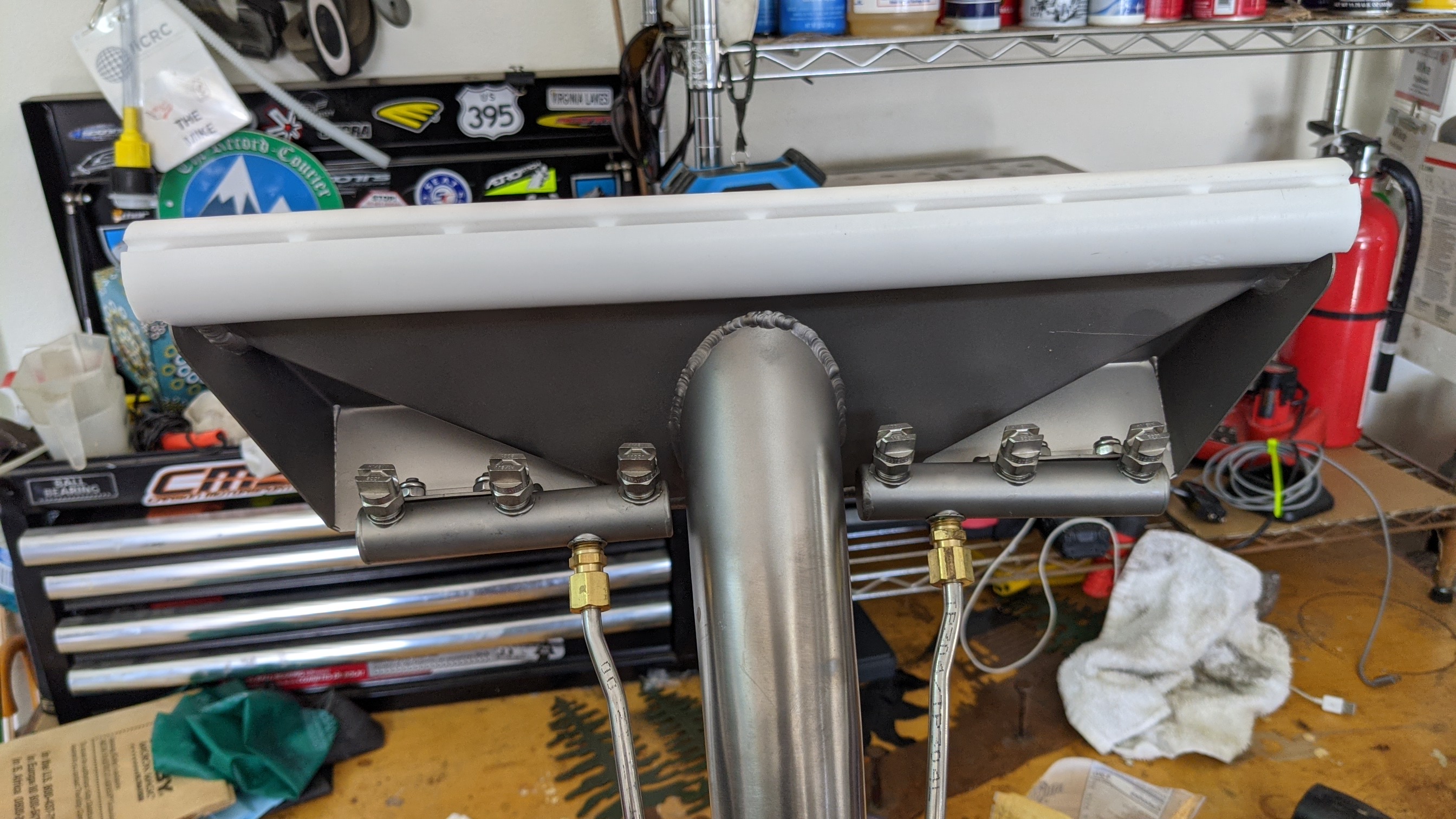

Do you ever take your wand Glide off to clean cruddy carpet?
14,202
Yes, Heavy soiled astroturf for added agitation and picking up larger objects that the vacuum cleaner didn't pick up
116,229
2/14 SSti is going to get a good shagging..
our Ti was notched for quick change slot n hole.
so cleaning gritchit got rinsed off fairly regular .
If it hadn't of been notched, I doubt it would of gotten taken off much if at all
I’ve never cleaned a carpet so bad That I felt the need to remove the glide. And I’ve done some crime scene worthy carpets.
you don't know what you don't know.
Unglided wand cleans cut pile (in particular dense/quality cut pile) deeper/better
I read this thread wrong though.
I was reading
"do you take your glide off to clean it" (the glide)
we didn't clean with the Ti unglided.
(with the exception of side by side evaluations I've done)
Too much of a man killer to push w/o glide for whole jobs .
for ungliged, we'd grab the flush monster floodjet Steamway wand
(or AW29 if jet distortion was a concern )
or just roto scrub it first

I haven't found that unglided wands clean any better. I think that's more of an illusion because it's harder to push. A glided wand is so much easier to pass repeatedly over a particular spot or traffic area.
