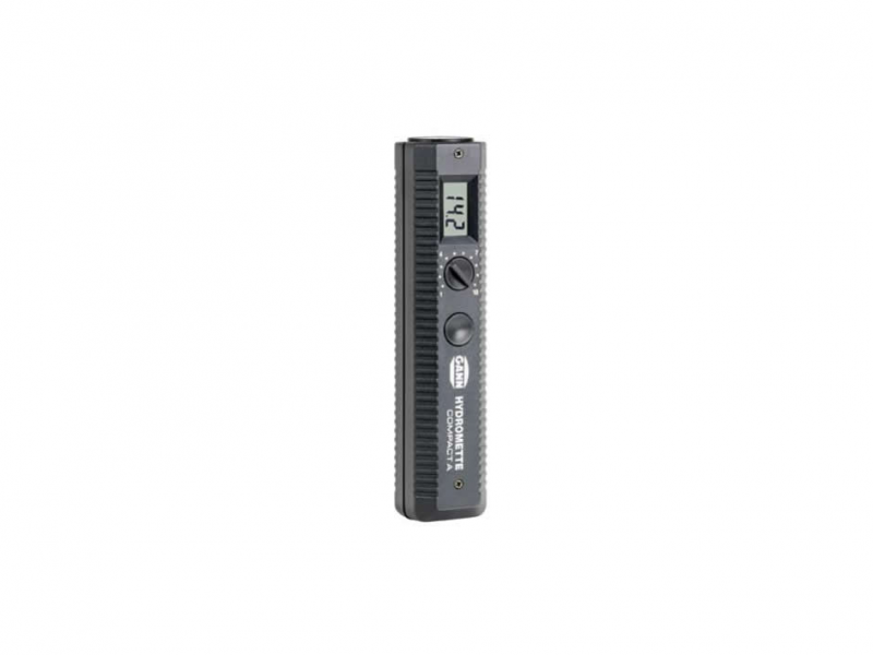

Gann Moisture Meter G2020
Gann Moisture Meter G2020 ‐ COMPACT A
Order# 2020
Use to measure finished hardwood flooring materials Digital readout Measures materials 1.5” thick Readings are in % of moisture content Separate seƫngs for different species of wood No cables, no electrodes.
Order# 2020
We have the Gann with the electrodes. It also measures deeper than a Tramex.
Reactions: kmdineen
