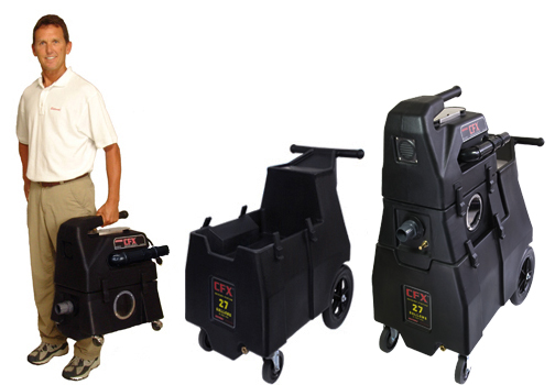

Ever heard of the CFX?
I hadn't until this week.
You can run a 360i from the pod all day without dumping or filling.

Re: design the perfect Portable and John Laberbosa will buil
Actually it would look a lot like this:

I have been thinking of switching from my TM to a Rotovac CFX. I would set it up outside the front door and run up to 100ft of hose into the house.
Why I haven't:
I would have to use cold water unless I had a heater.
I use a Turbo tile cleaning tool which wouldn't work
