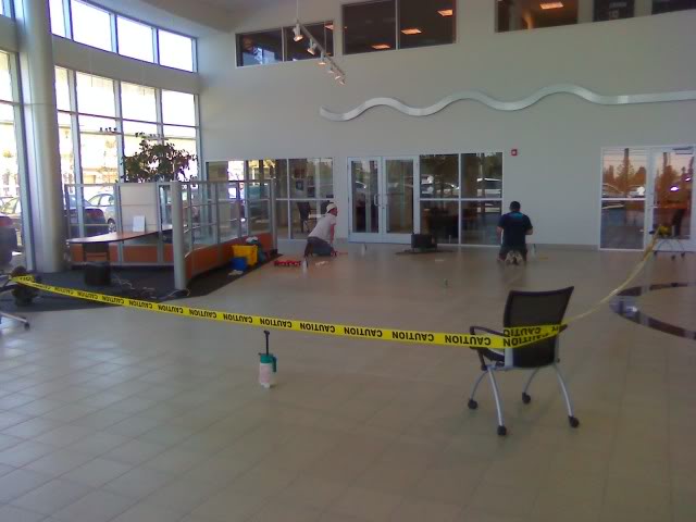

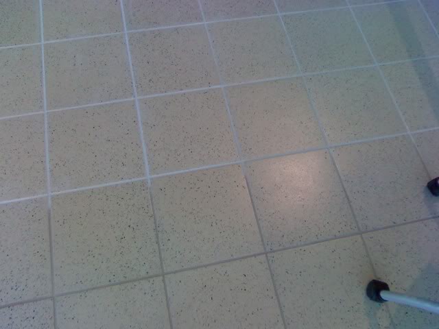

3 of us cleaned a color sealed 632 feet in about 3.5 hours.
We wasted considerable time trying to get use to the Shamwows.
Thick cotton towels are just plain faster in my experience.
Only 5368 feet to go.
Pics were taken before we buffed off the haze.

So once you get rolling I wonder what production will look like. It's a real eye opener. It looks like doing larger areas should be at least a two man job.

I find that we get the best/speediest results by using a Costco Cotton towel first then follow up with a Shamy to get the dried stuff off. Wiping up every ten 12 by 12 tiles on average
When we're done with a large area we use encap pads and some very diluted Neutral pH cleaner to get the haze off followed by a white pad to get rid of the wheel and foot prints.

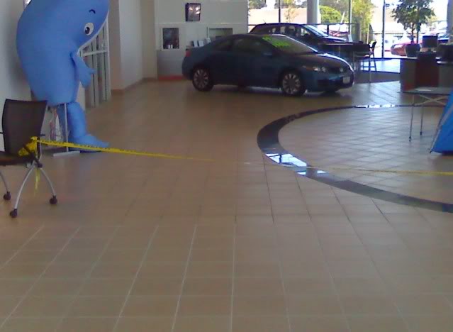

By the looks of the pics, I would have to say no. I have mainly stayed residential, I think my biggest job was something like 1600sqft plus 2 1/2 baths and 1 tub surround with seperate shower. 3 guys (including me) took 9 1/2 hours. All showers were color sealed.
