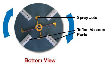

OK, I'm going to give up all future profit from this invention - because I love you all so much.
(And know that everyone will steal it anyway and force me to sue... or threaten to sue... or just whine about the bastards...)
This is actually a pic of an existing Rotovac head to give you the idea. Take any rotary head with HDPE sliders, or cram HDPE sliders into the slots on any rotary tool you have, and use it for rug agitation in your flooded, soapy pit. Stop killing yourself with a third-world scraper on a stick!
This idea is actually the slumdog version of the roller head I wanted to make for rug pit agitation, but an industry patent troll has already patented any possible combination of roller and carpet cleaning, so this is the next best thing.

What is a HPDE slider?
High Density PolyEthylene. The tough but slippy plastic used to make everything from oil-free bearings to wand glides.
Got a video of this in action?
I did a video of my roller head for the patent application as a proof of concept, but not the same thing. I actually started thinking about just using rotary glides when I saw Keith Studebaker's HDPE glides for the Hoss at MF S'Cruz a few years back.

The thing every rug cleaner knows is that brushes work from the top and don't really do a very good job of getting impacted soil up from the base of an Oriental rug nap, compression does. A heavy rotary tool + a compression "blade" = dirt removal.

Compression Compresses. It does not remove. Actually pushes dirt deeper in, compressing it into the base of the rugs foundation. It looks like you'r getting dirt out but you really are not. Snow works too. Take a really old dirty 90 line, Sarouk, or Bidjar and please tell me how you can compress dirt out. As an example take a really dirty sponge Squeeze it really tightly...fill it with more water then squeeze it again. More dirt why, "compression removes?" not really. Soap, detergent, surfactants, suspend soil,water rinses suspended soil away. Robert Mann extensively uses a rinsing"pressure washers" action also awesome aggitation the water actually opens the pile up and flushes dirt out, what i saw the ringer used for was for ringing out moisture to either re-clean or pre-centrifuge. Now I'm not saying you won't get some dirt out with that crazy devise. Probably get a lot of repair work from it too. But a scrapper used properly will do more.

I think Brian got his plastic acronyms confused, not that it matters..
https://en.wikipedia.org/wiki/Polytetrafluoroethylene
His theory (and practice) of using a glided RE for pit agitation is something I'd like to see tested more. Not to offend Brian but arnt you the company that wont let your on location techs use glided wands? :headscratch:
