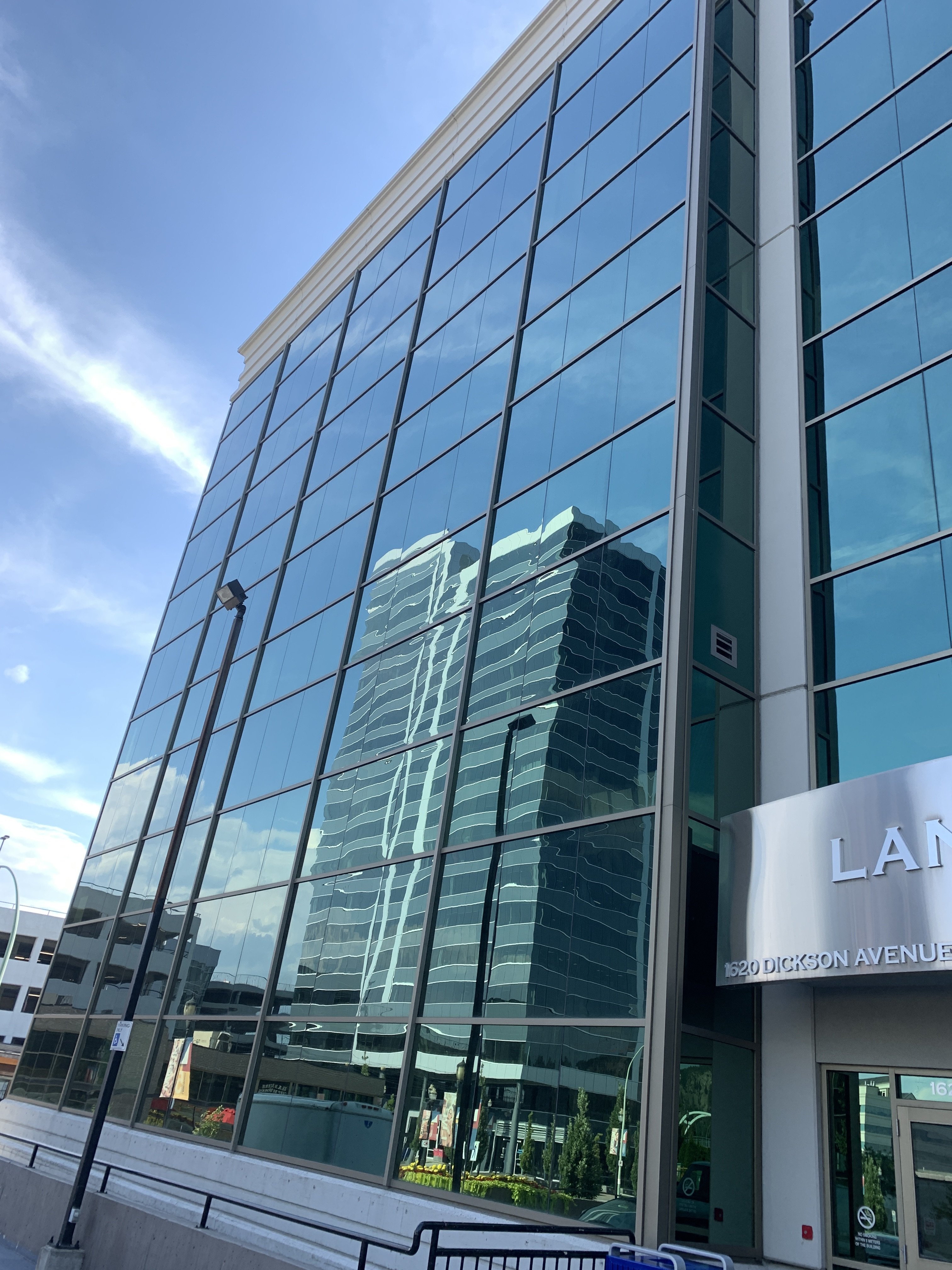

Funny you should mention this today Ron.
I’m taking a break from encaping 28,000 sqft right now.
The last time I did it, I used my CRB, and my helper was walking behind me, cursing, picking up the ‘carpet poops’....
This time, solid prevac, and CIMEX....
