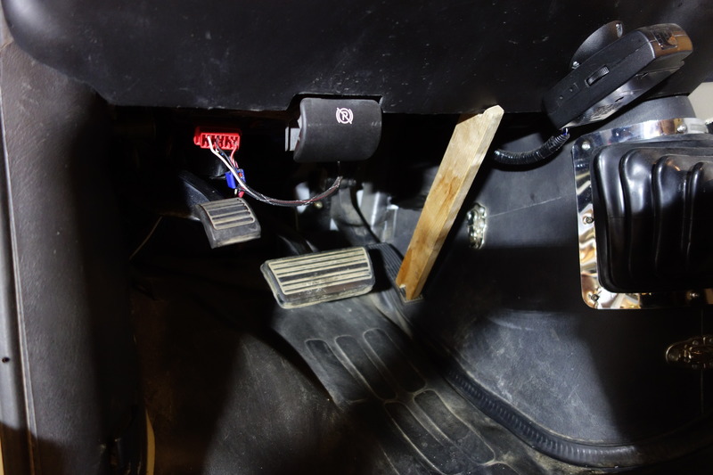

It's that red thing above the parking break in the pic..

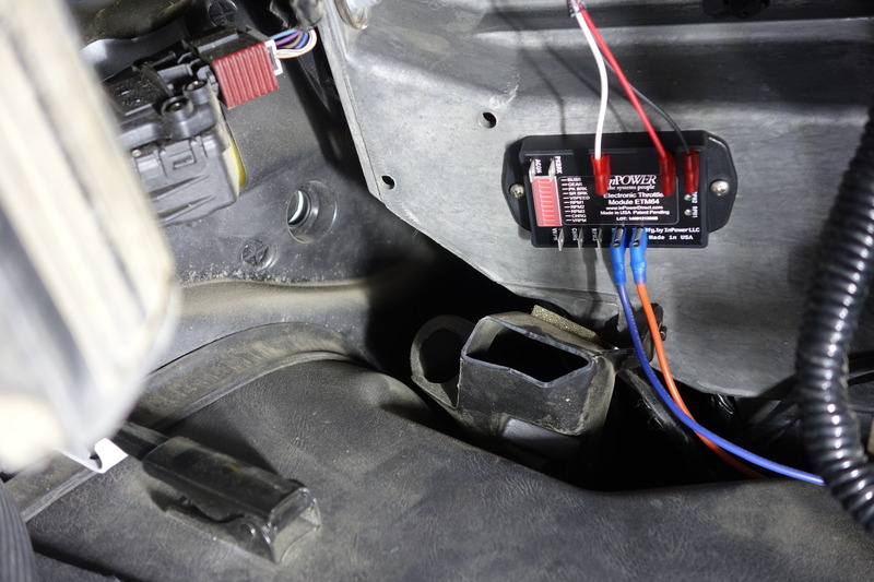

The red plug (in the first photo) is connected to the GMC ECM . That is what a mechanic will plug his diagnostic equipment into when he checks your vehicle for codes. The leads coming out of it go to the Cleanco electronic throttle module. Its mounted above the gas pedal.
Install a push/pull throttle cable to the unit. Infinite speed control.
Not sure how that would work, tying into the efi on the 6.0 litre and running it to the panel on the Cleanco?
We just had to make a small adjustment to the speed of the unit. There are a couple of small set screws below the red cap where the black lead terminates. The blower was spinning at 2450 rpm on the carpet setting. We upped it to 2850.
