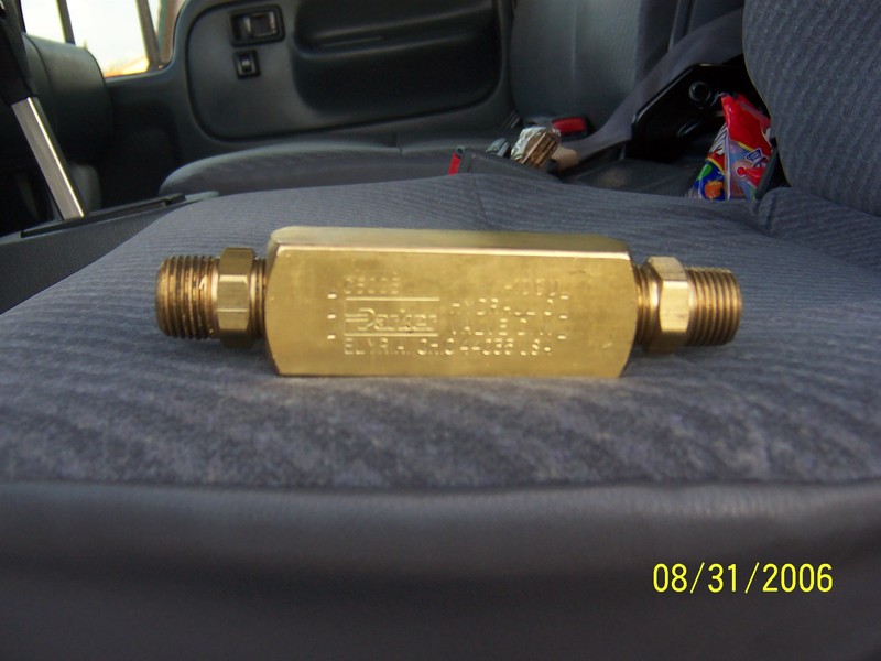

Actually he had to call me to get the answer because he did not even know there was a check valve there....
If you get this one from windtrax......you will never ever have to worry about it again...thats what I put on mine...

As soon as I saw the diagram I recalled that part and its function. I had that one you got...
It failed too..
