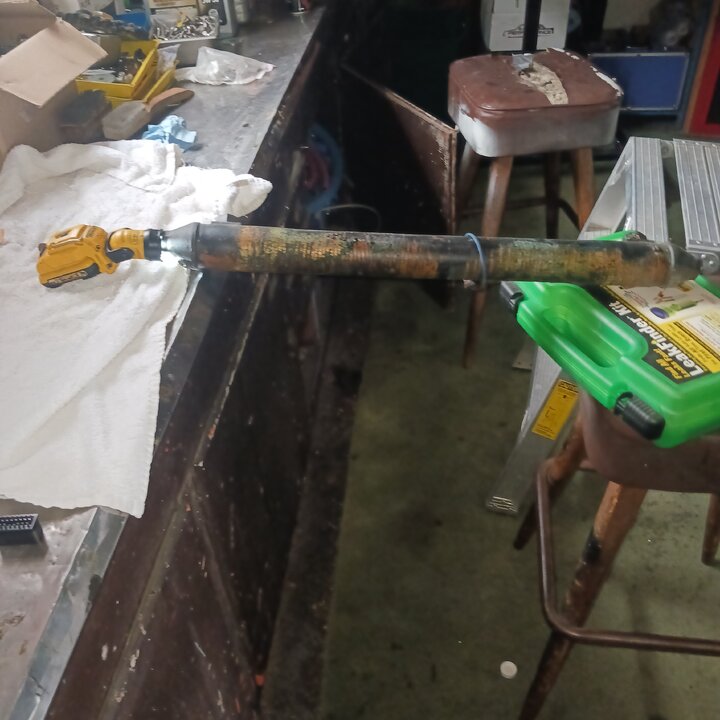

You're being very helpful. In one sense I already knew what was going on when the bolts were spinning in place, but on the other hand I refused to believe they just thread the bolts through the metal waste tank at the factory rather than welding a nut on the inside or something. And all 4 bolts just spinning in place seems too stupid to be real, so I figured it must be me. But it's pretty simple and I'm looking right at it. Maybe I'm just whining...
First of all i believe your wastetank is aluminum so if they welded bolts or nuts they would have to be aluminum and even if the tank were stainless or just steel what if you stripped the threads or worse broke one off ?? Trust me you'd be bitching more about that than a bolt spinning in the tank
Forgive my pace of comprehension here but, how are stripped threads or a snapped bolt any worse in this instance than a bolt that is now just spinning freely? These bolts that are now just spinning freely are slightly loosened, so I'm a bit screwed as they will not be sealed anymore and water will just come leaking out around them it seems. And if the only solution is to cut the heads of the bolts off then drill out the shaft, how could that be better or worse? Seems like all those scenarios put me in the pretty much the same dung pile... maybe I am missing something?
By the way if I cut em and drill em out. Could I just get some rubber washers and a lock nut and bolt the new heat exchanger on in the future? I suppose there are a few ways to do it. I just want to keep it simple and not think about it for at least 5 years after I fix it. One can hope.

Well if it were a welded nut it would be aluminum and strip easy and if you were lucky and have a set of taps maybe you might get one more use outa it. Now if it were a welded stud again it would be soft aluminum and if it were to twist off you'd eighter have to find some aluminum threaded stock and have it welded on or drill it out and put a bolt in like you have now. So in my opinion you already have the lesser of the 3 evils . Now common sense dictates that if the bolt is spinning you don't have to drill it out. Simply cut the head off and use your crescent wrench as a hammer and knock it out . I personally would use a real hammer and maybe a punch. Butttt having to explain this....... next to reinstall i personally would get some stainless bolts that are the correct diameter and are threaded all the way then eighter cut some rubber gasket or rtv the head put the bolt thru and use a nut and lock washer to secure it to the tank then mount the new heat exchanger to your brand new water tight mounting studs. But thats just me

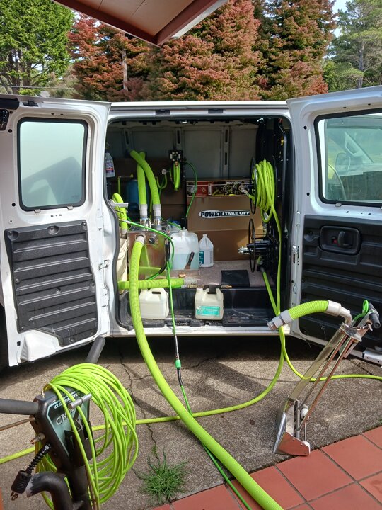

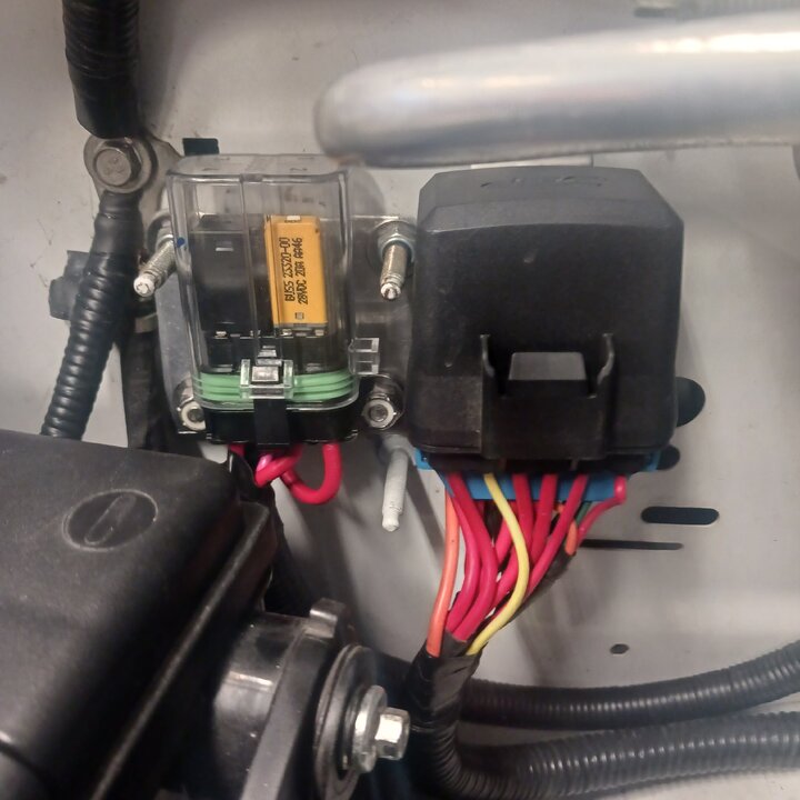

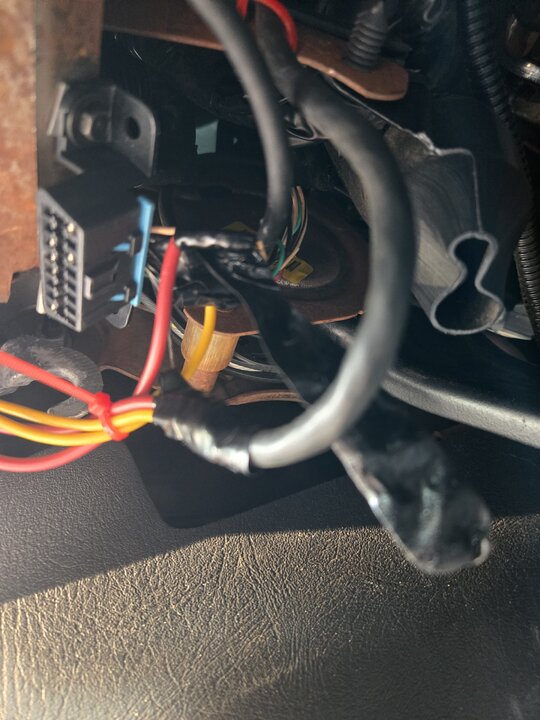

20170328_215327 (1).jpg IMG_20161113_154756631 (1).jpg 20201101_082403.jpg 20250119_140446.jpg 20250524_133823.jpg 20250119_140822.jpg 20250524_133808.jpg 20250524_133814.jpg 20250119_140715.jpg

I'll cut the bolt heads to get the heat exchanger off tomorrow afternoon. And I'll pick up some plugs at a hardware store to plug the coolant lines for now. Ordering a couple pressure regulators tonight. Hopefully when they come in I can install one and start using this thing while I figure out the heat problem.

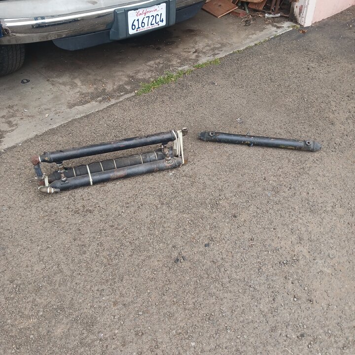

Thanks Dwain. I thought it was going to $1500 or more. $900 would be a relief to me. I'll get on it. And hopefully tomorrow the 4 bolts holding the exchanger on behave differently.

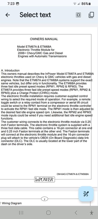

I just had a thought, Blue Baron used to and maybe still does make an all stainless heat exchanger for hydramaster ptos. Is was touted as higher quality and much higher pressure rated than the copper ones . From what I've heard i myself wouldn't buy a machine from this company ive heard alot of complaints about him but i have heard that they do make a great heat exchanger that will retro fit a hydramaster pto and its rated at 3500psi where as the copper ones are only 900psi but i personally won't run um above 500 and i have 4 bad ones setting on my shop floor because o went a little higher. Might ask around on this and other fourms if your interested and see if you can a few people that has um and see what they say. There's also a bunch of YouTube videos on there heat exchangers

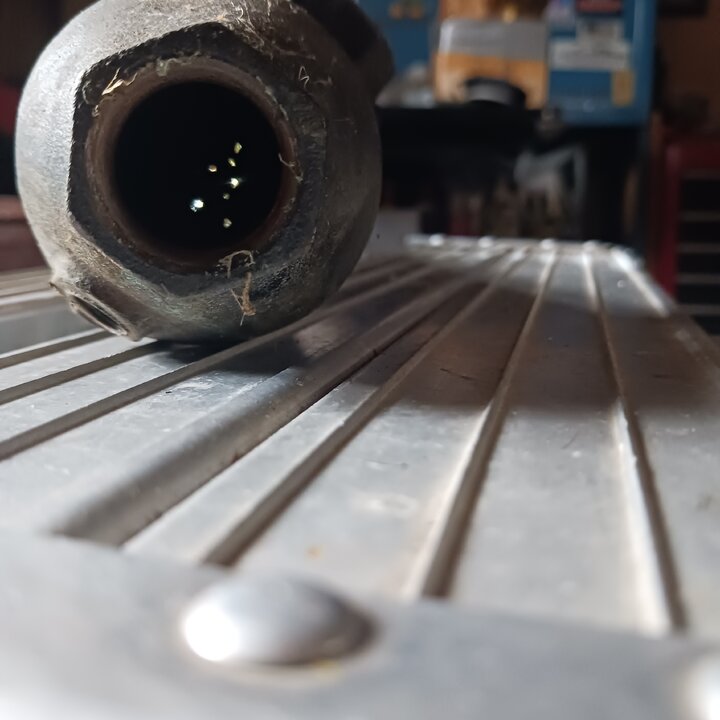

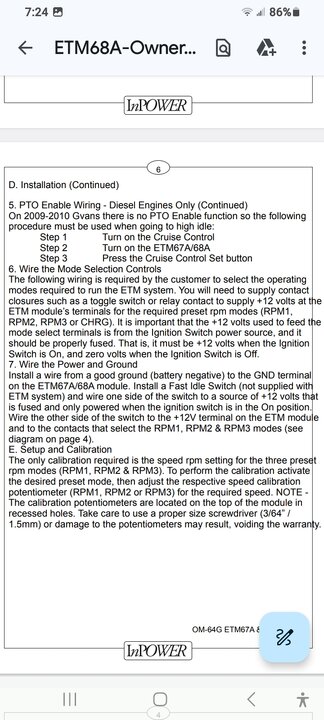

Screenshot_20250623_202515_Chrome.jpg Screenshot_20250623_202525_Chrome.jpg Screenshot_20250623_202542_Chrome.jpg
Reactions: Bryce C

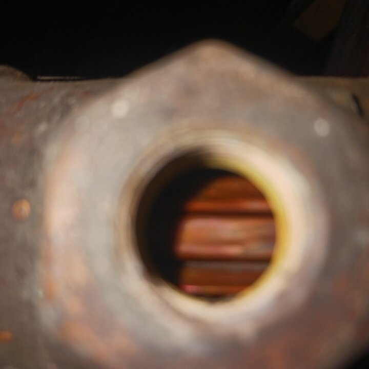

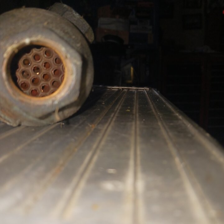

Thanks guys. I'll read more about them and then call these folks once I get my heat exchanger off the waste tank so I can look at it the way Dwain showed me. I have a feeling the small fresh water tubes are crushed. The previous owner of this tm had the coolant still hooked up but all the fresh water lines removed and bypassed from the heat exchanger, probably no flow.
I like the idea of stainless steel small tubing inside with a much higher psi rating! Hopefully the mounting bolt locations are or can be made on these upgraded heat exchangers in such a way that they line up with the stock CDS heat exchanger, so I can bolt it in the same location to the waste tank.

I called TTI fabrications and I first received the coldest "hi" one can imagine when calling a business. I thought I may of dialed the number wrong and got some random persons cell phone. They asked that I email them some pics of my heat exchanger, so I did along with some measurements right away. 24 hours later I hadn't heard anything so I call them again. The phone just keeps ringing and ringing, nothing... 2 days later still no response.
I called Peter at Blue Baron and he called me right back, and he was helpful and enthusiastic. Looks like I'll go with Blue Baron. About $1700 with shipping for the heat exchanger. Seems like it will be built to last, all steel tubing and fittings, 3500 psi rated, and he told me I can use it on coolant and exhaust heated systems... I sense this thing will last a long while, could maybe transplant it truckmount to truckmount for some time.
