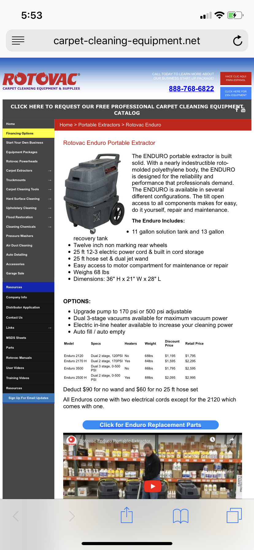

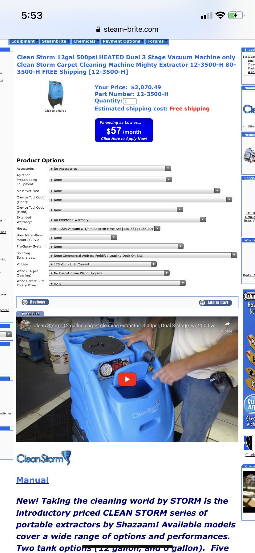

Hi every one I’m new to carpet cleaning and I’m looking at different types of machines. What’s your thoughts, on the clean storm 3 stage 500 psi with heat? I thought it was good for the price. I was gonna buy this or the rotovac enduro with 500 psi and heat. They want $2,350 for the rotovac and $2,070.49 for the clean storm.
