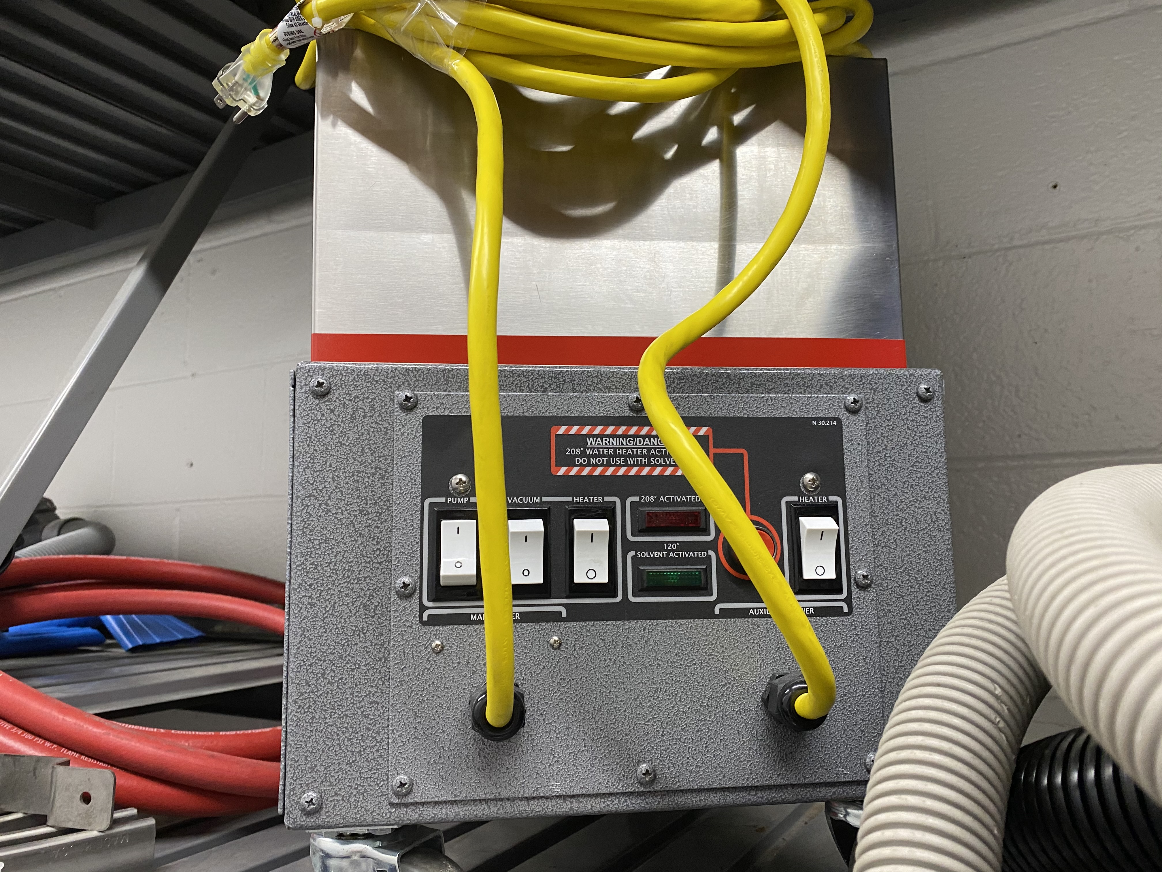

As a safety feature.if you use a us products or klernritr.
Remove heater fuse.
So as to not inadvertently turn on a heat solvent.
Whilst distracted or performing the service work.
Stay safe an profit.
