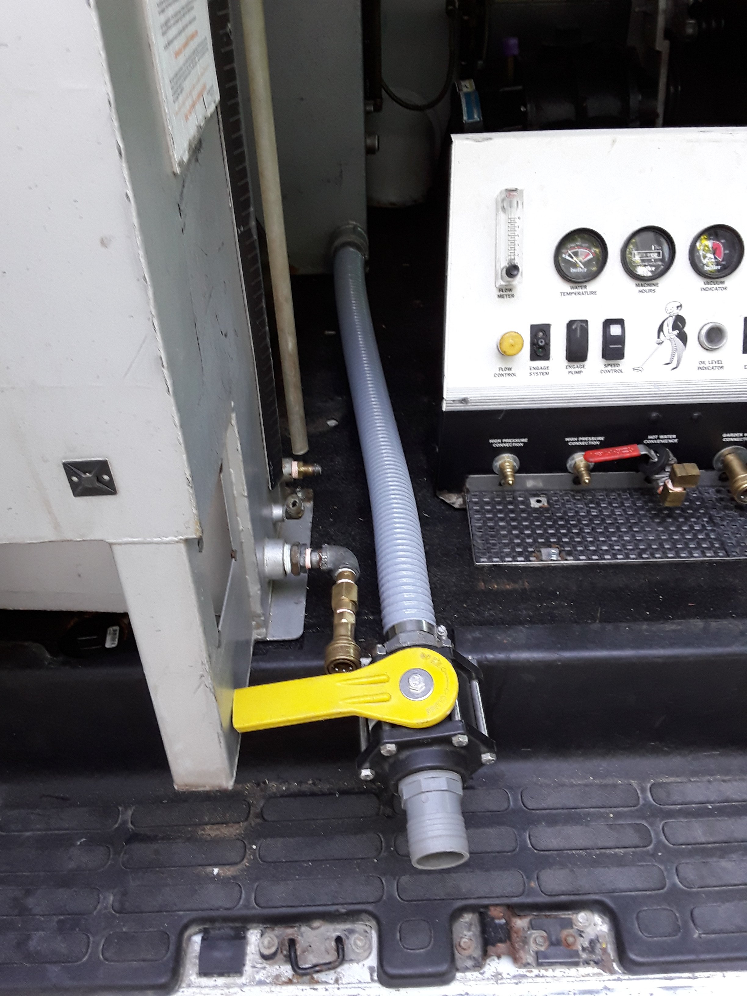

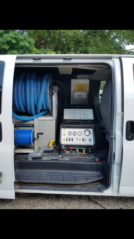

I got a Butler and the drain seems to be partly plugged. I have the 210 waste tank and it is a L shape and I can not see the drain from the top when I open it up. What is the best way to unclog it? I tried really filling the tank up a few times hoping that a few 100 gallons of water would force it out but no luck not sure how or what is plugging it up.
Any idea or advice?
Notice how the drain it curved or snaked; so stick something in the drain is not the best option either.

I would take that piping off. You really don't want it draining all over the place under the van. Replace it with a 2 inch vac hose. That way you can direct into a clean-out when dumping. Then you can run a snake or coat hanger into the plugged drain.

Well I got it out it was a combo of lint, large lego and a toothpick flosser that was plugging it. I did the reverse vac with and had it suck up the water from a hose a few times then did a job and suck the fresh water tank half dry to flush it out good and it came out.
