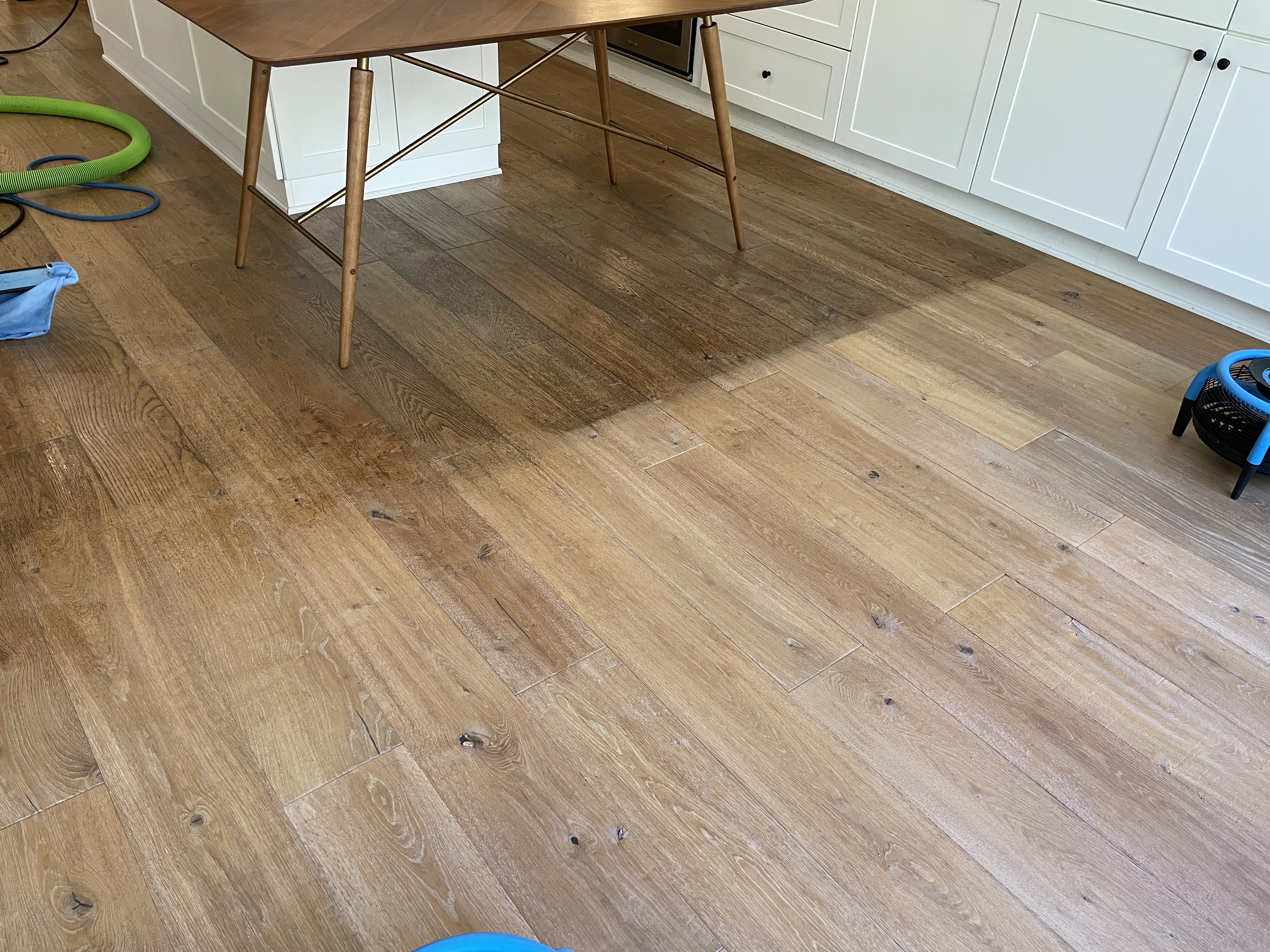

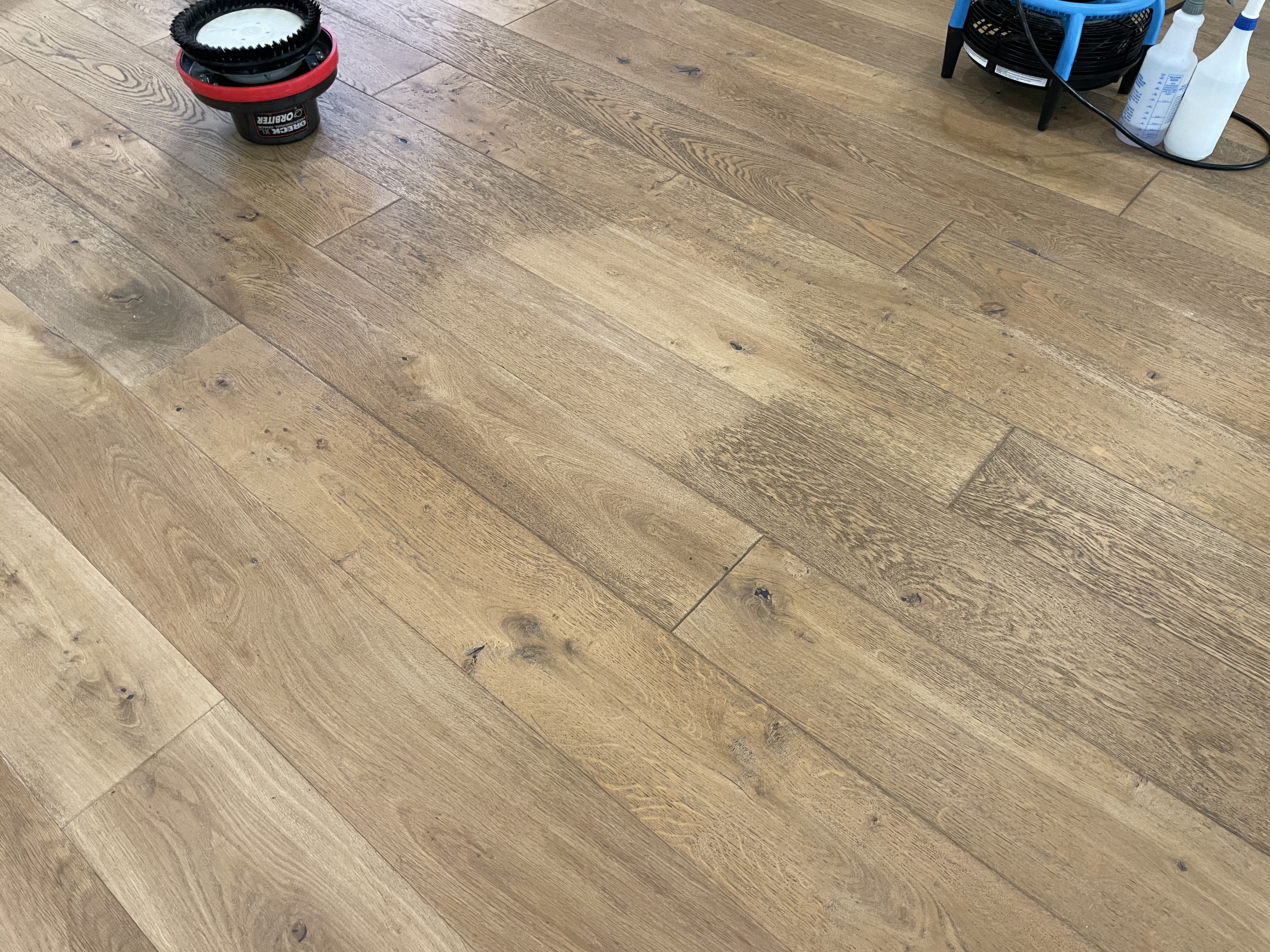

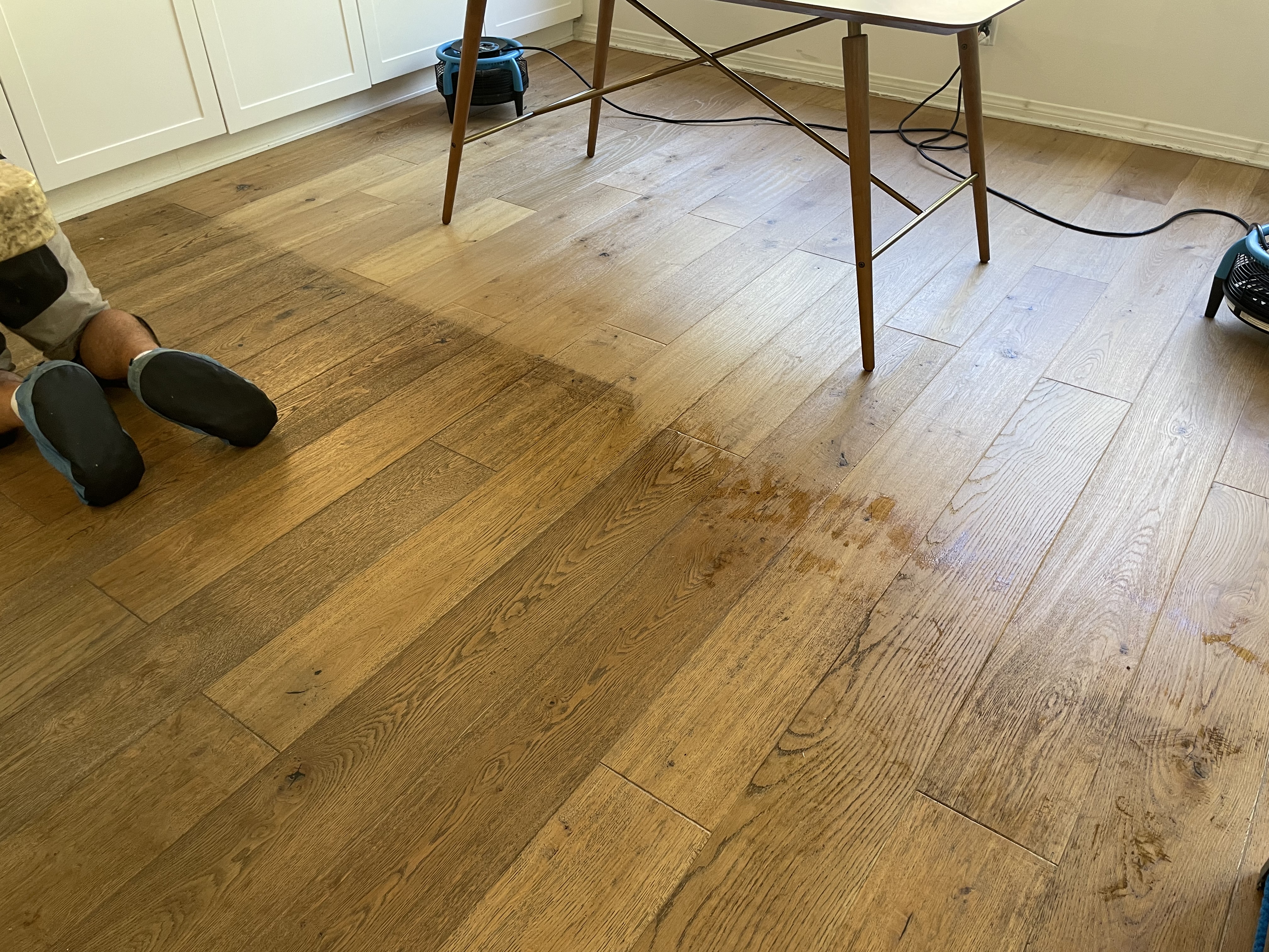

Demo spot with oreck orbiter black carpet brush and basic coatings dissolver, then rinse with squeaky and dri pod.

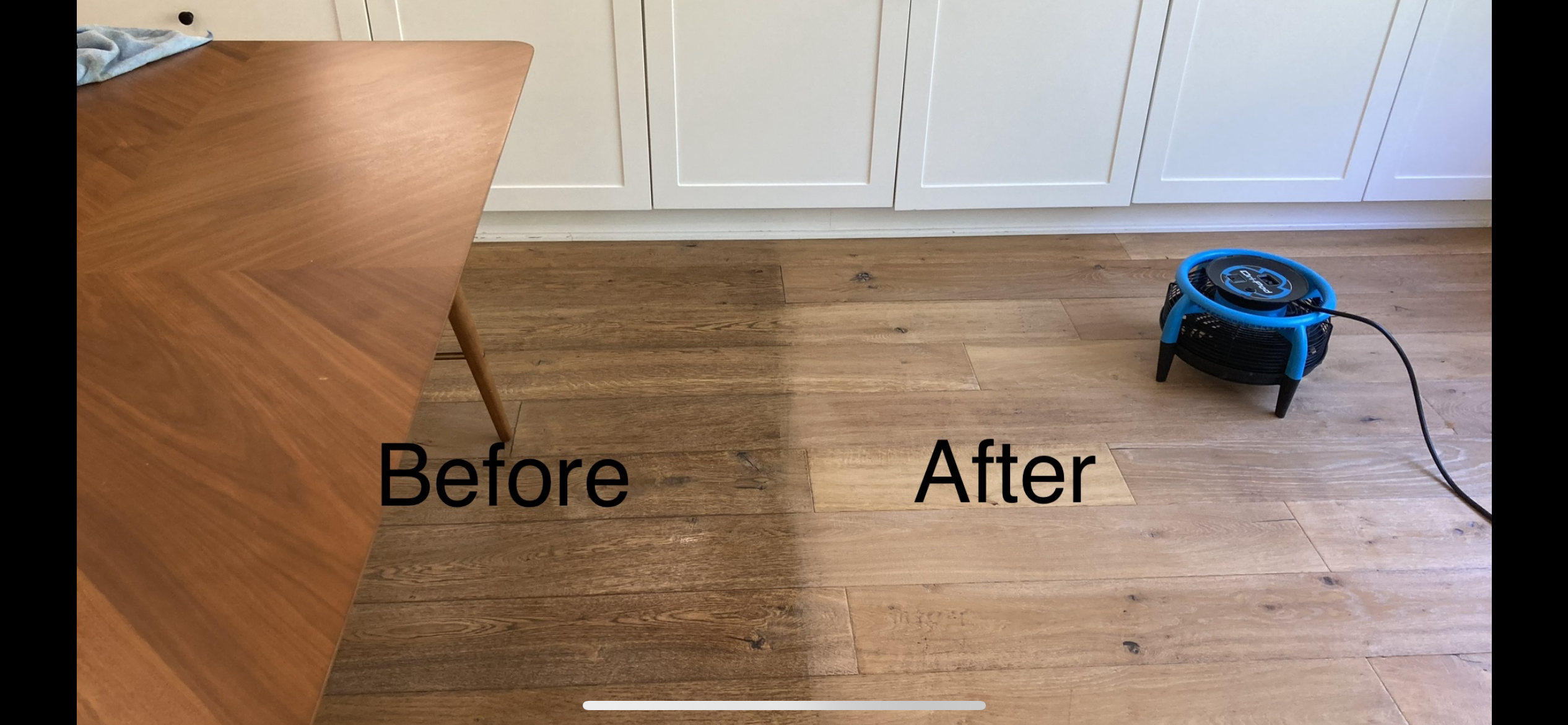

Brush Pro killed it!!

IFT is a perfect cleaner for filthy wood floors (as well as LVT / LVP). And then follow up with Squeaky. Keeping your moisture level under control is paramount for wood too, but it looks like you have that well in hand. Nice photos by the way! We started selling a few of the Basic Coatings items. Our customers love their wood care products! https://excellent-supply.com/collections/basic-coatings
