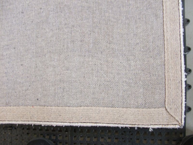

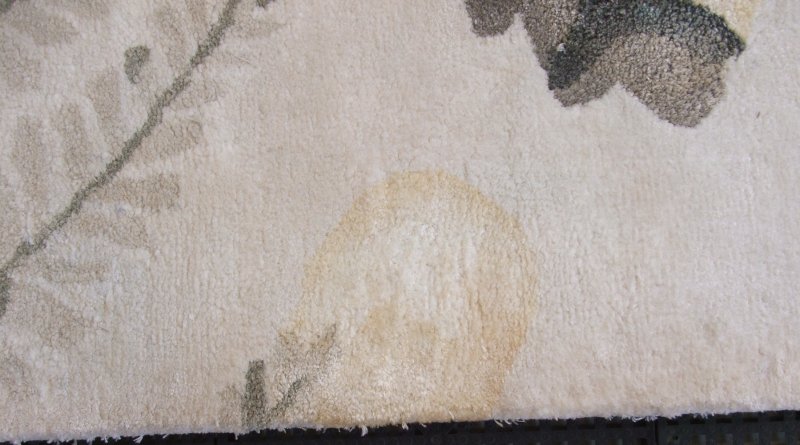

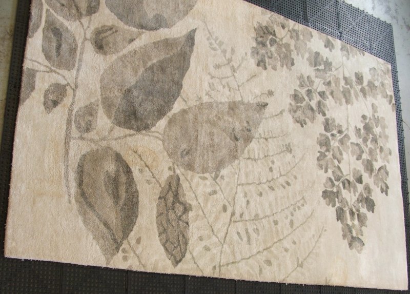

According to label 100% viscose - made in India - hand tufted enclosed pic of full rug , backing and heaviest stain. Think staining is accentuated by fibre distortion as intensity changes dramatically depending on view angle.

The distortion or color Hue change based on which direction its viewed from is a natural characteristic of viscose.
When using sodium meta-bisulfate to correct the browning of the face fiber it can trigger the latex to cause browning on those types of rugs if the latex get too wet.
As for the staining it looks like pet/urine stains. I'd Pre-spray it with CTI last step or urine pretreatment and flush it really well.-- but I'd first - inform the customer of all the problems with such a rug and that she should have lowed expectations and get a signed waiver.

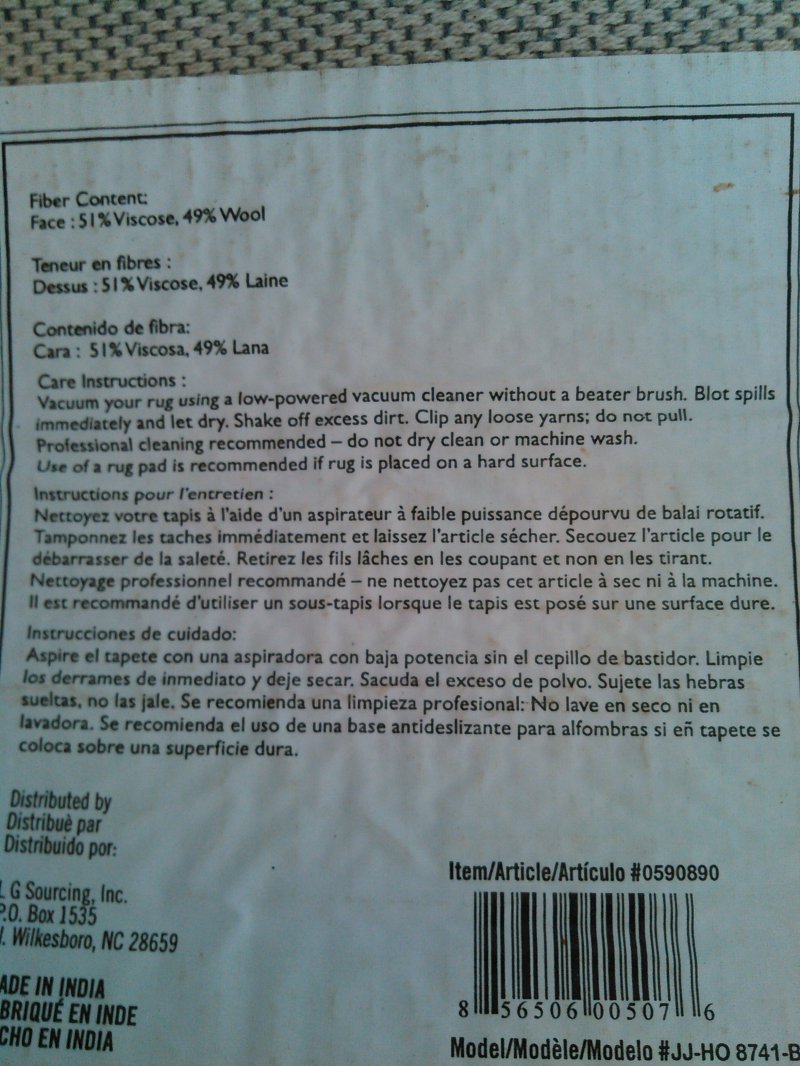

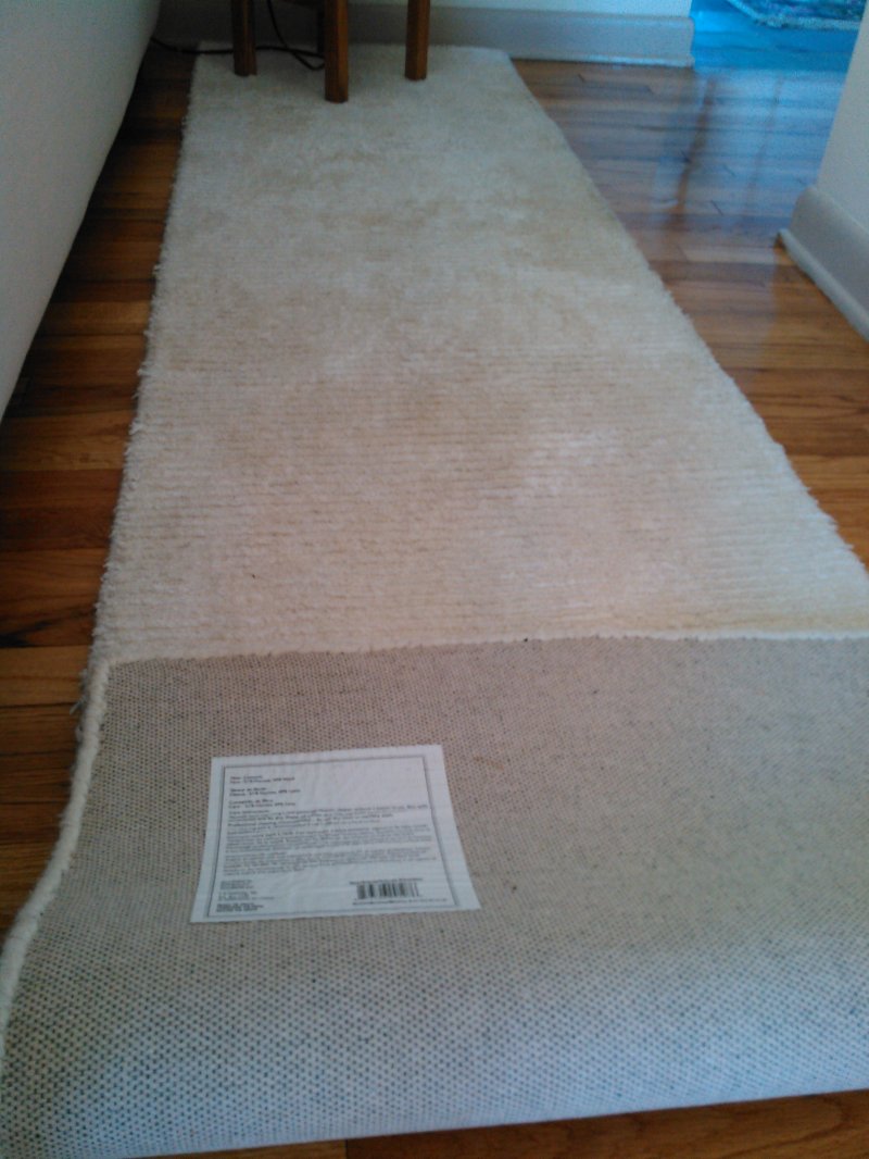

Not sure if it's because of the wool in it but the care instructions say not to dry clean.
I've wet cleaned it a couple times. First time it yellowed a lot. Second time I finished drying it face down. Looked a lot better.

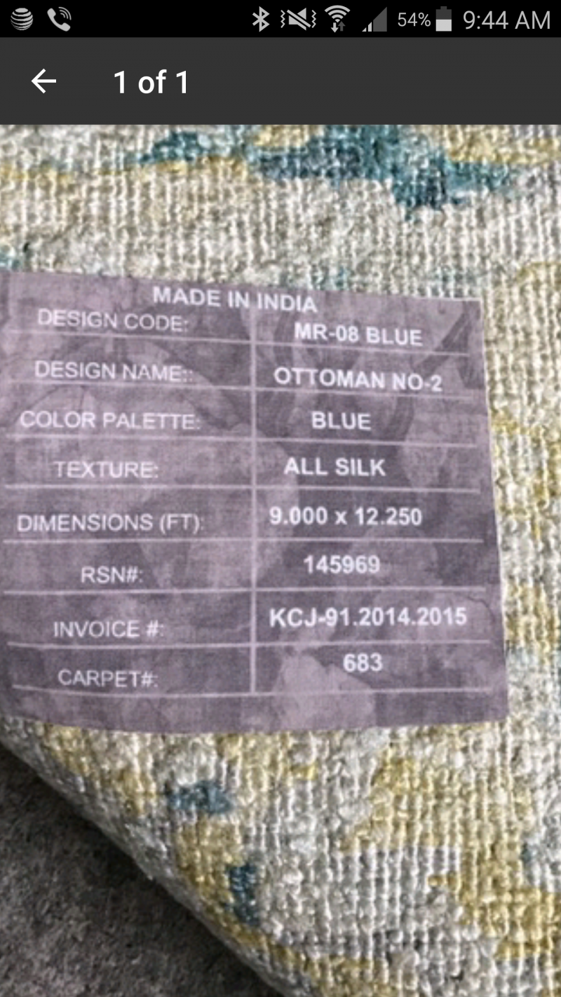

Here's a new version of missing leading the buyer:
I had to inform the owner that Texture doesn't mean fiber; his rug is viscose.

I don't know about in India, but in Australia, TEXTURE is defined as: the feel, appearance, or consistency of a surface or a substance.
Texture IS NOT a fiber.
