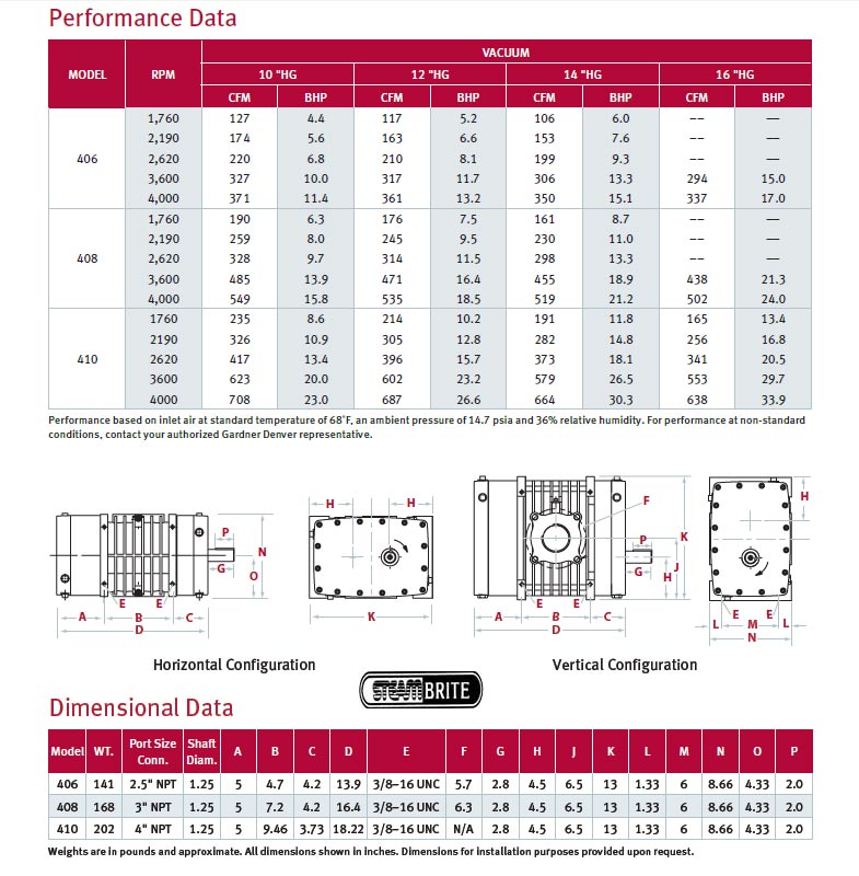

Thanks Fred. Am I mistaken that the Peak set up moves more air than the 370? Just to double check, the 650 is a 408, not a 410? Can any of the blowers spin a bit faster without damaging the blower and improve performance?
Yes! We've done it. However there is more potential gain in fixing other plumbing restrictions.
Idk. I would assume increased room and potentially less restriction would allow for more cfm
410....I put 408 by mistake....will edit
you could provided the horsepower is still there at the desired RPM. The increased load/heat/etc would likely wear out components faster

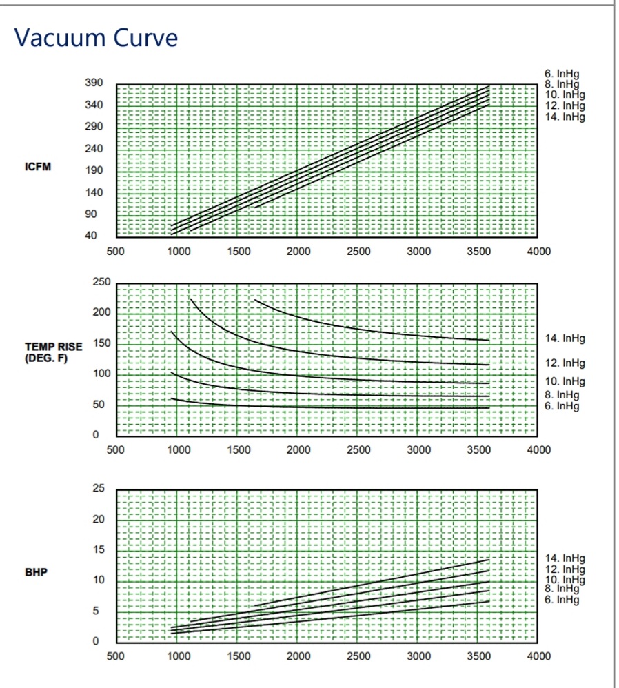

NO. The faster you run a blower the hotter its exhaust, largely due to the compression of exhaust gasses.
again only going off what I've read from old posts.
but thought the rationale was higher airflow less chance to pick up blower heat, therefore cooler?
higher Hg the blower is working harder (more heat) less airflow (more transfer of heat) theories are wonderful things

If you restrict the exhaust of a PD blower the temperature rises proportionately. Thus many post blower designs severely do just that.

The only restrictions that those two models have is the first 50ft of vac hose connected to the tm. Just get 25-50' of 2.5" hose if you're looking for more suction. Other than that...adjust the hg up to 14" from it's current setting, and get a rpm gauge for the 370 to make sure it's set at 3k rpm on the engine. Suction on those two truckmounts is very good as is. I've seen both directly on the job. No need to do any more
