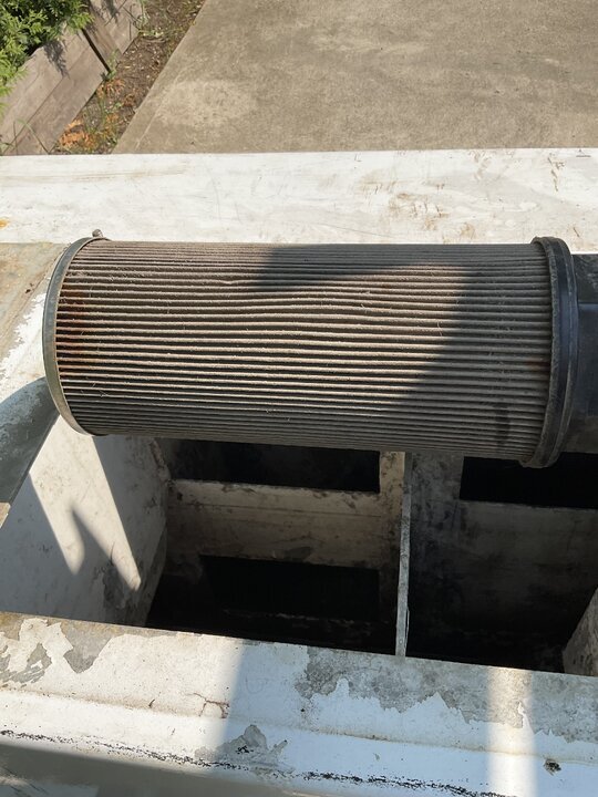

I had a big job to do today.
So, last night, I pulled the blower filters, filled a 5 gallon bucket with very hot water, put 2 cups of industrial degreaser in the water, and one cup of 99% isopropyl alcohol.
I put the filters in, and let them soak overnight. When I got to the shop this morning, I found the water was quite grey. I then scrubbed them with a brush, and put them back in fresh hot water for another 1/2 hour. I then rinsed them under hot running water.
Now, I usually clean my filters every other day, and thought that was good enough.
Boy was I wrong. Doing a long soak was like having a new machine.
We did a 425’ run today, and the suction was incredible.
I’m going to run this system once a week. I guess it’s a filter ‘deep clean’.
Try it, you’ll be very surprised how well it works.
Just food for thought.

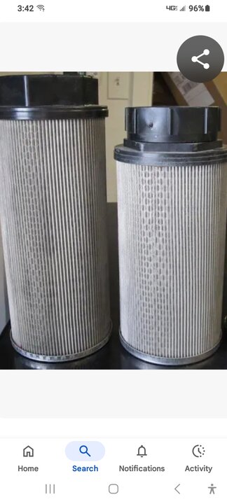

My Cleanco has 2. I’ve upped the girth and length of both filters. They are simply hydraulic oil filters. You can get them at any industrial supply store that caterers to the heavy equipment supplier. Eg; tractor supply, or excavator supply store. I also increased the micron by 5k n’s…. WAY better suction.
Zero detriment to the machine.
Finally you’ve given me some useful information! If it turns out to be true I might give you a break on a future DAP.

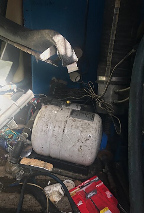

This is what sets Dan off.
I remind him:
"Guys that have messy trucks are the ones that have the most trouble. Guys that don't care about the inside of the truck are also the ones who don't change oil, repair things before they get bad, let their machines freeze, etc. Most of your income comes from guys who have messy trucks"
(Food for thought isn't it?)
I remind him:
View attachment 131183 View attachment 131184
I suppose the operator of that truck may not be ready for a conversation about shoe covers.
I remind him:
I wouldnt say they don't care. I could be wrong.
This is hard work and when you struggle with your health especially when others don't see it nobody understands.
The guy with the messy truck might appreciate a kind word and a little help.
Some of struggle more than others.
Reactions: Jim Pemberton

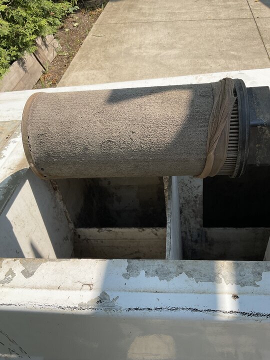

Last night we did a combination of tile & grout, upholstery, and carpeting.
The T&G was the last thing I did. It’s was a commercial space, and the janitors that take care of the space clearly use the ‘glug glug’ method when mopping the floors. I went through a gallon and a half of defoamer.
My ‘super suction’ TM was reduced to nothing more than a whimper…
Even though we didn’t get back to the shop until 11PM, I pulled the filters, and soaked them again.
Today, I was back to having a fire breathing dragon, with all the suction I wanted…

12,621
I see those guys too.
We sometimes clean up the truck, do some gratis work, and work out more frequent maintenance visits at reduced pricing. There should always be compassion when you have the flexibility that a small business like ours allows
“Pizza Truck” is part of a fleet of trucks belonging to a poor businessman who pays little attention to these things. We once sent a truck back that was full of urine filled water bottles.
Reactions: they live
That's just gross.
Im sure you have seen a lot of different scenarios i couldn't even imagine.
