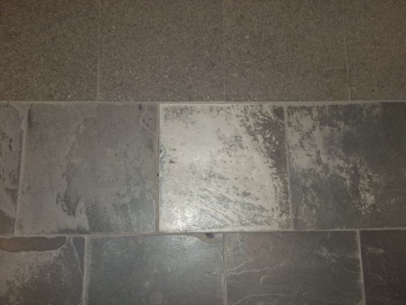

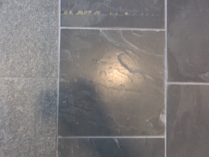

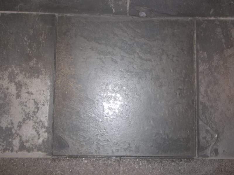

We come across black slate that is very old and worn. On this test tile I used stripper, rinse, then acid, then rinsed again, dried it and then applied and enhancer. I was only able to get it back to gray and I know it should be black.
I uploaded a tile that was close to original one that I stripped and enhanced and the after picture after I enhanced it.

I hope you did that test area in a corner and not in the middle of the floor.

Be really careful enhancing stone that has been sealed before as you can "enhance" brush marks and other quirks that were once hidden and now belong to YOU!
Strip it an extra time or two to make sure you get as much of the topical out of the crevasses or is it crevisis?, as possible

Looks like it is coated quite heavily-needs a good stripping and possibly run a nylo grit brush maybe 180 grit.
Then use a high quality color enhancer to turn it black.

I agree with Mike.....I have never seen a totally "black" slate......being natural stone it is obviously going to have "varying" tones / color.....also I do recommend using a 175 floor machine outfitted with a "medium bristle" / blue sometimes grey in color depending on the manufacturer....however, be very careful in the abrasiveness of the brush (eg. Nyla or map grit) as they can put " swirl marks" in the stone just like Mike is referring to that could be hidden by floor finish.
Also as Mike said....it might take 2-3 stripping to get it out of all the crevices.
So do a test panel to determine the labor costs and then charge accordingly.
Stone Pro makes a good enhancer that works well on slate.....be careful not to use the Home Depot crap that is a "sealer / finish" that can streak horribly.

I last time I did a black slate I sealed it with STT CE with great results. I don't think they are around anymore though, when I went to the Easy Stone class Cameron and Ted showed me MB-22, it's clear, thick and odorless like the STT, CE will probably get the same results.
Feb 5, 2013
527
Southern California
cameron demille
I think you meant CEX 100. It is very similar. Also Stu's MB-21 Ultimate.
