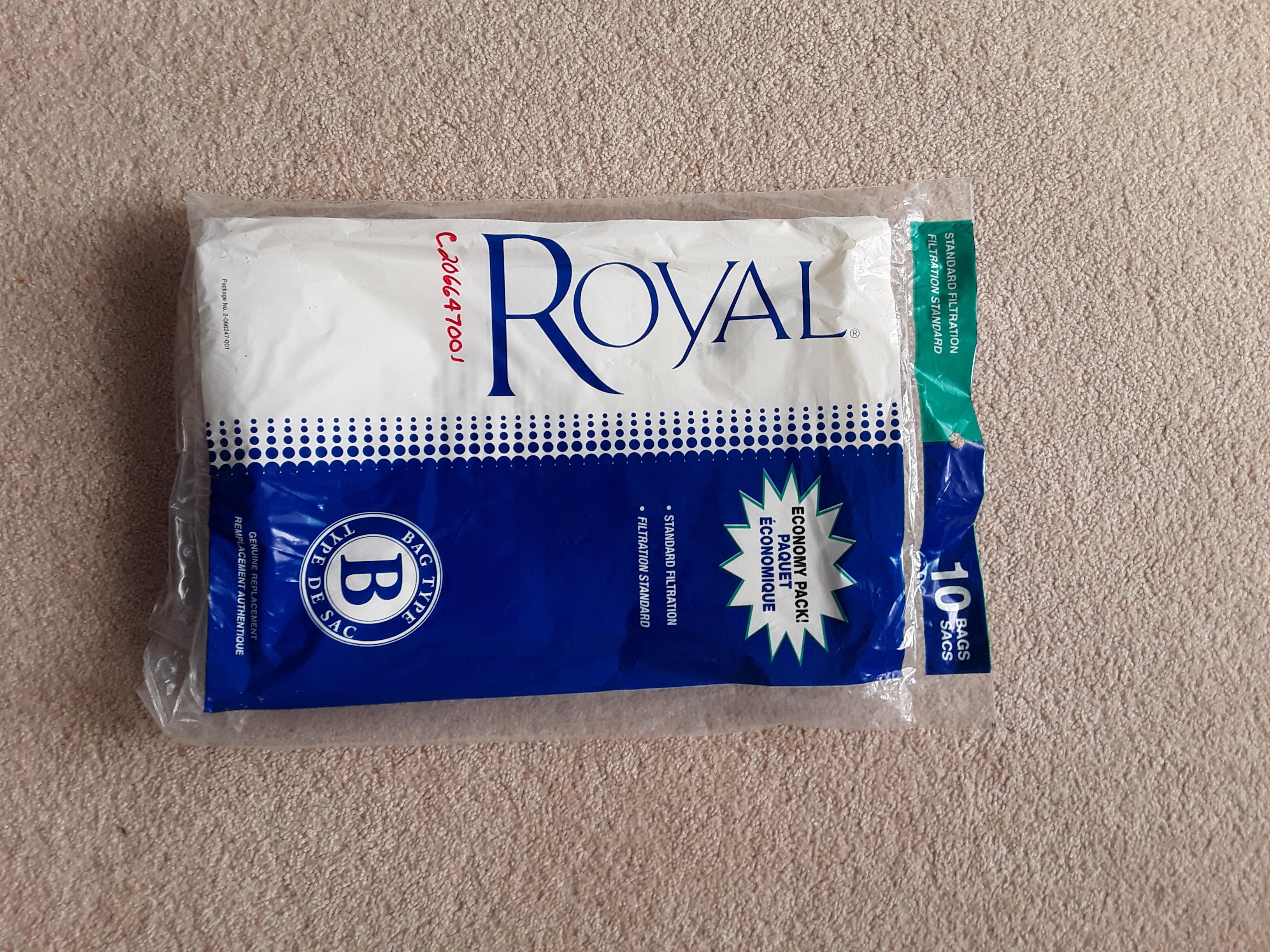

The Certified machines use the Royal Type 'B' bags. I get them from a local vacuum repair shop. The Nildor Company in Bolivar Ohio is a good source for parts.
I have 5 Certified machines and schematics for original part #'s.

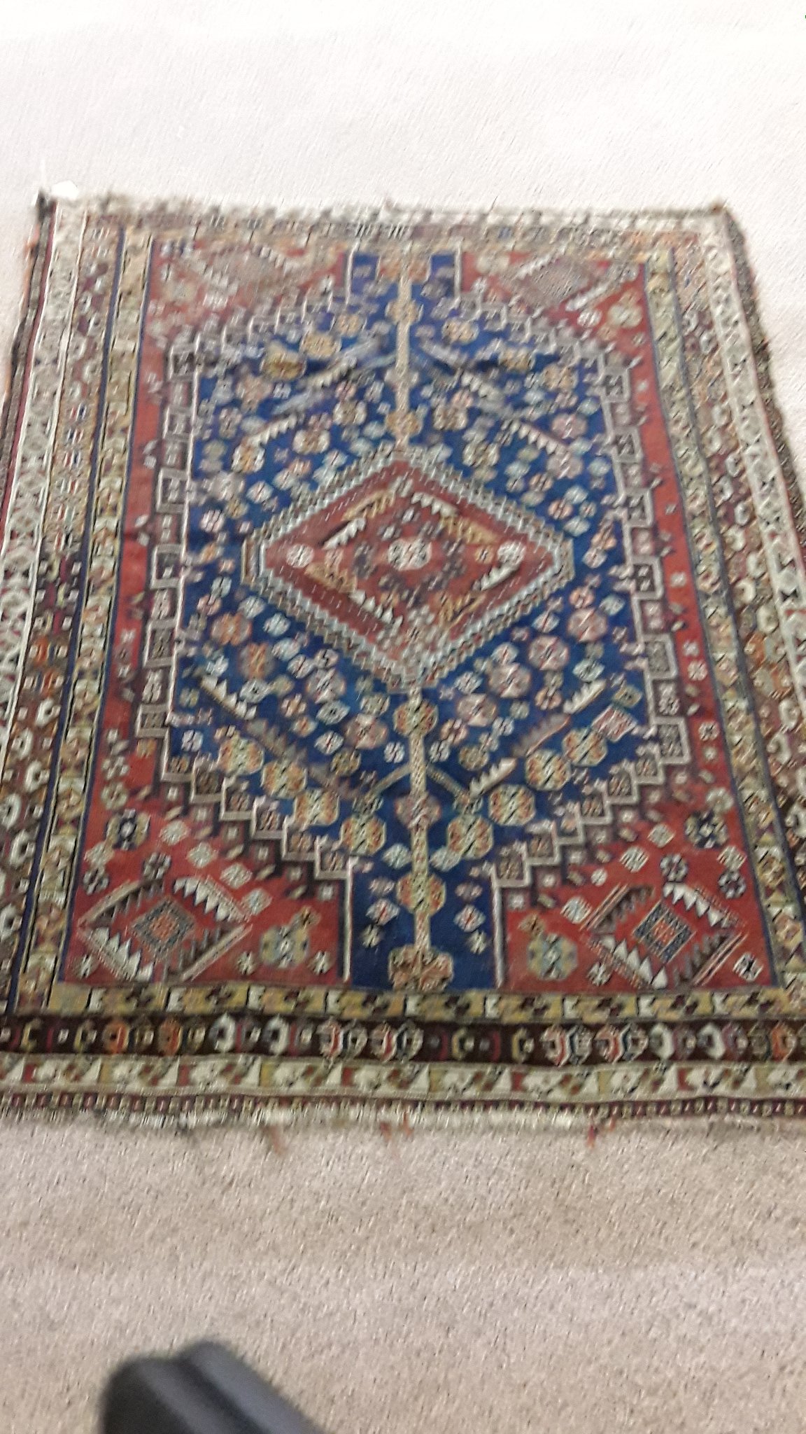

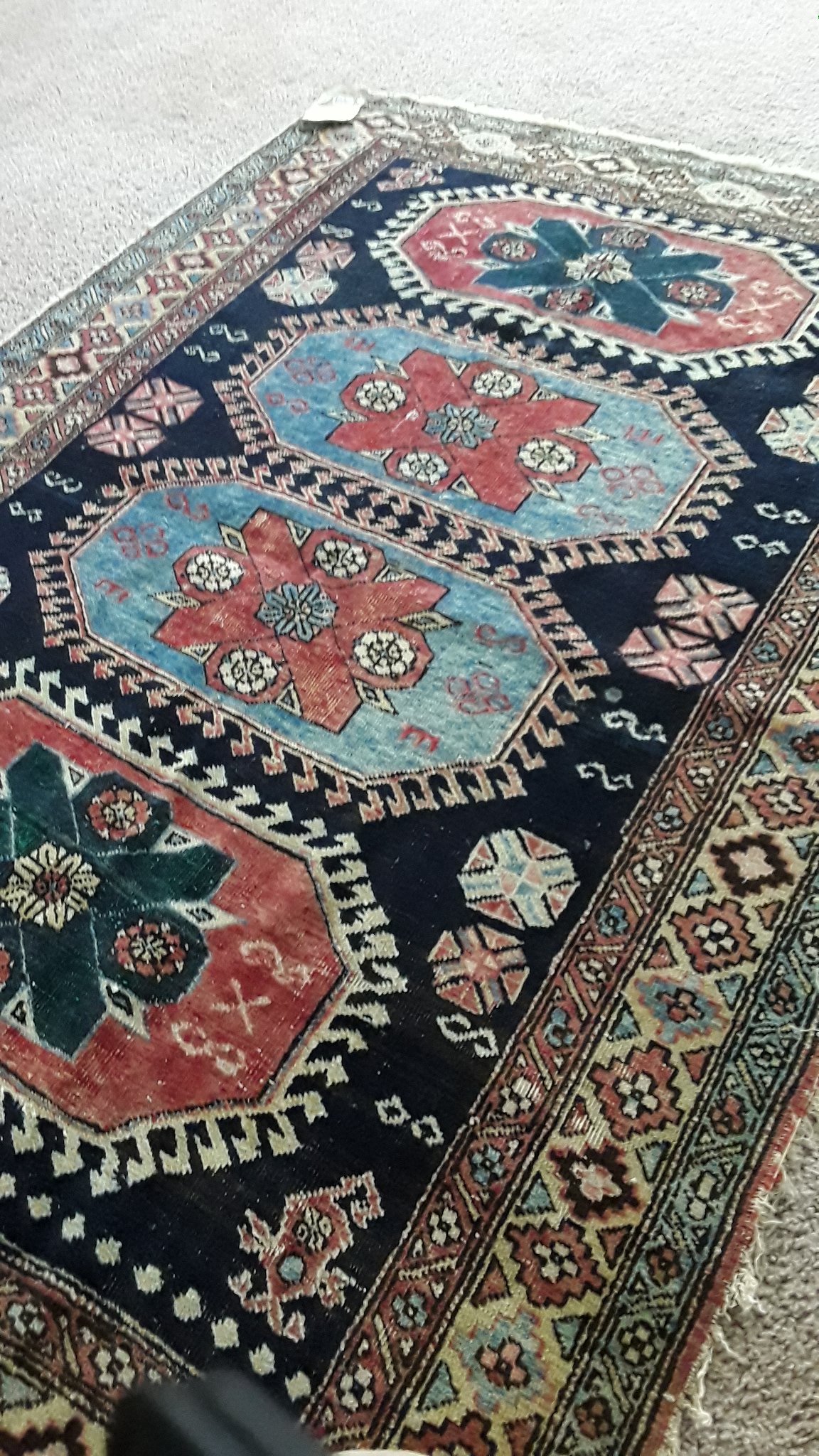

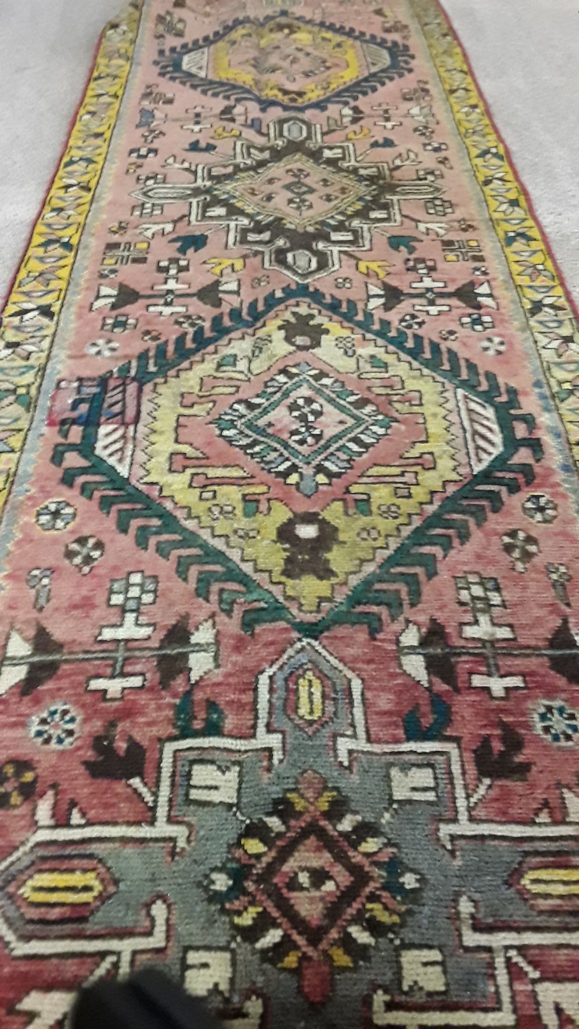

If you clean primarily hand-knotted and Karastan machine-made rugs, that volume could justify the cost of buying a tumbler. Take a look at the type of rugs you clean and see what percentage would go through a tumbling process OK. As Scott/Jordan mentioned, a tumble duster isn't for everything, as it won't help with stiff backed rugs, hand loomed rugs, inexpensive tufted rugs and many others that can be damaged by tumbling.
A majority of the rugs we clean come from overseas. We have a customer who buys hand woven rugs from England (most are antiques) and sells them. We clean around 40-70 of those. They are all wool rugs. We do get some machine made rugs in but not as often. I'm wondering if the tumber would be too rough for the rugs we clean. Here are some pictues of examples of the rugs we clean.
