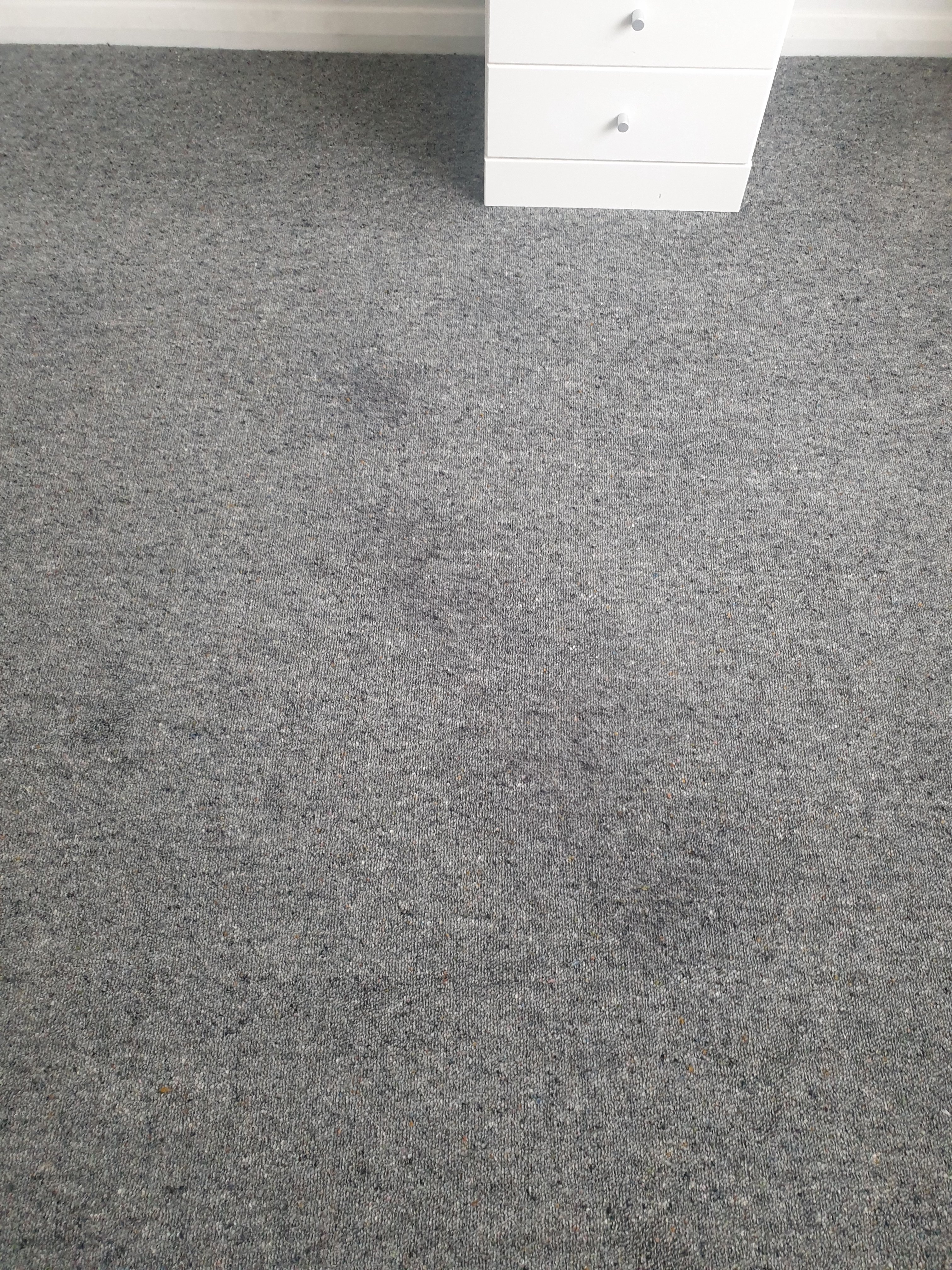

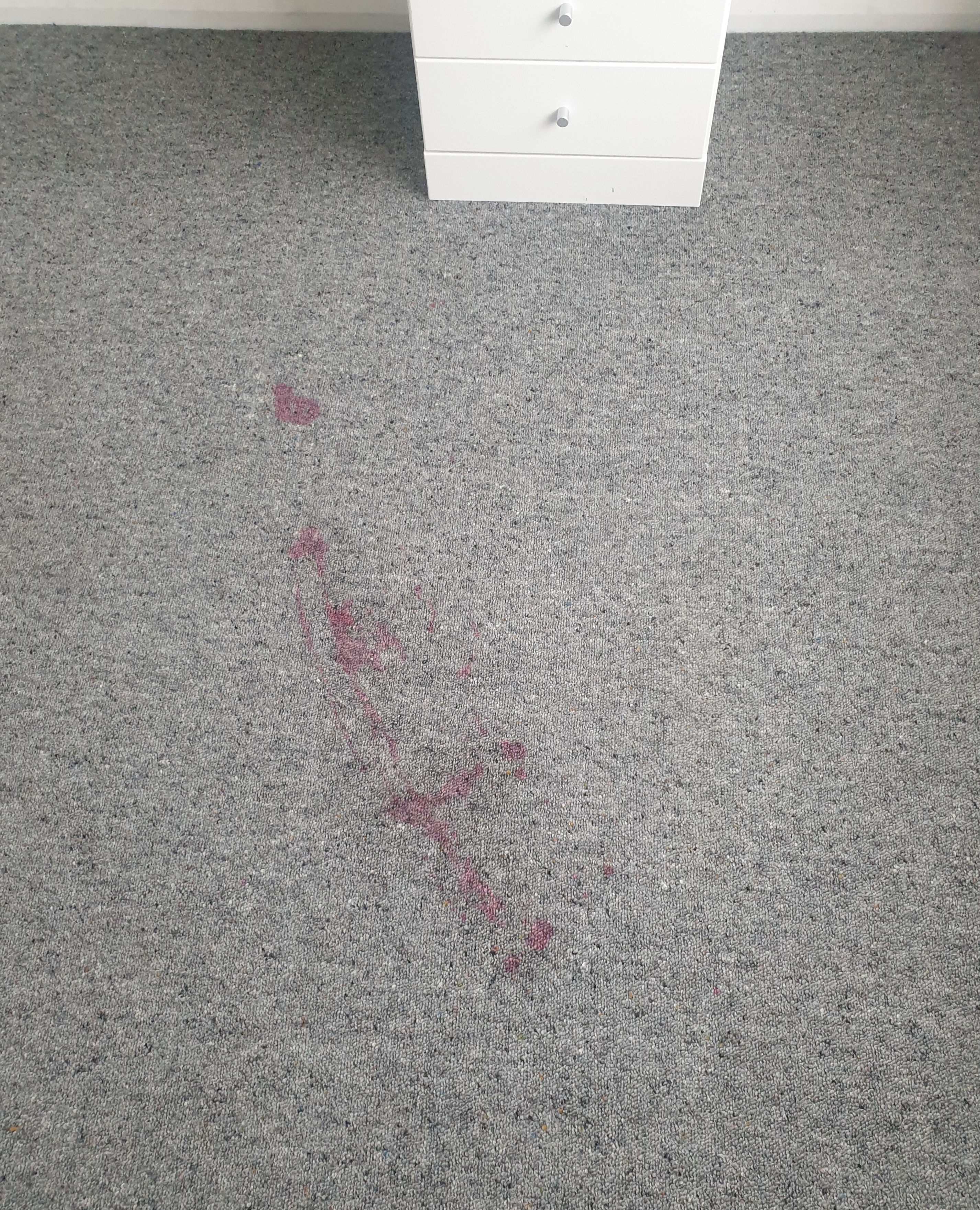

Raspberry cordial stain on wool..
removed the staining, presprayed with soap free and extracted with acid rinse turned up.
Went over it multiple times, but still a slick mess from what the homeowner used
what are some of your methods/products to remove excess residue?

I didn't have any defoamer on me
this wasn't really foamy just really slick, think defoamer would still work?
had good success with soap free before but not today
what did they use?
something non water soluble???
