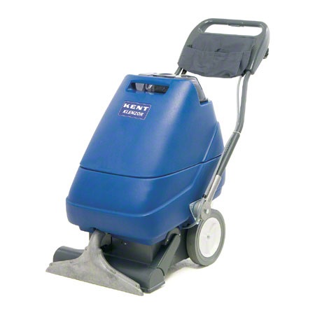

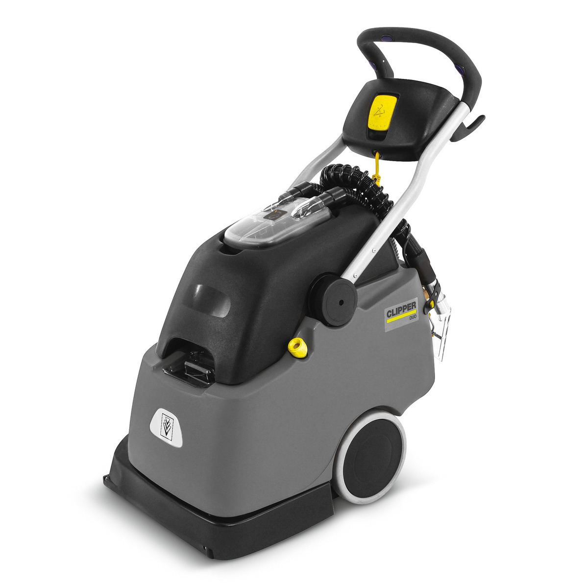

I work at a medium sized casino. We are looking into getting new equipment and I'm wondering what carpet extractor would be the best to get. Currently we use the Kaercher Clipper Duo and honestly, I hate it plus it has worn out pretty quickly. We previously had the Kent Klenzor and it worked extremely well ( Stayed in operation for at over 12 years and was still going pretty strong until the brush housing cracked and they told us they didn't wanna fix it anymore😅) We operate the machine almost every day and cover lots of ground including inside small offices. Any recommendations?

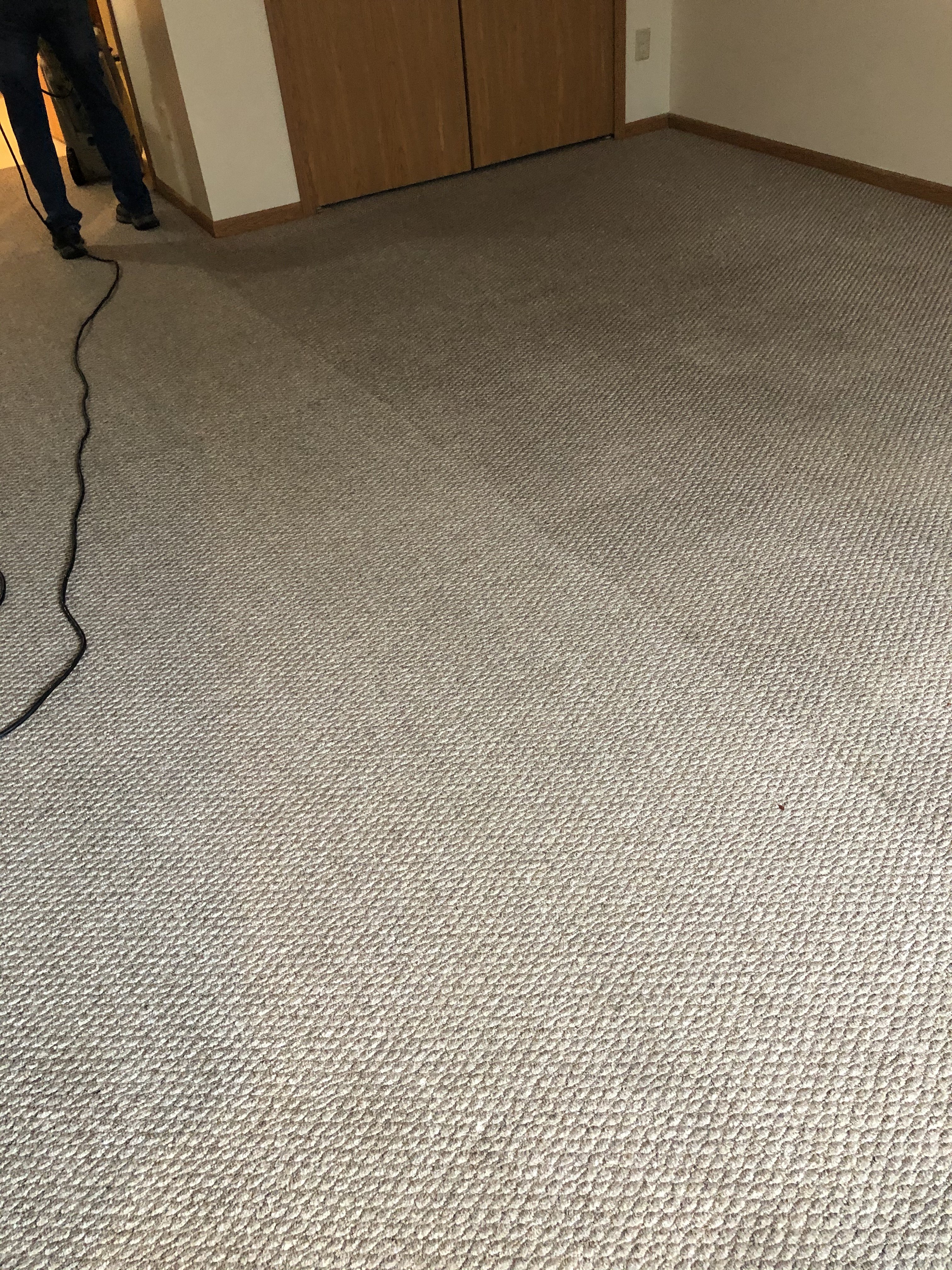

not very good good for production due to size, but believe it or not, the commercial Rug Doctor is a pretty good cleaning machine.

I impulse bought mine when I saw 6 of them for sale in the rental section at Home Depot.
Thought it might work for a hi-rise ole folks apt building that I always felt guilty and dirty inside by padding them
(something you hacks have no problem with)
I was pleasantly surprised and I no longer felt like a dirtbag hack for padding res

I have rented a rug doctor before. But the OP was speaking to commercial carpet. The OP was also being mislead by management and carpet salesman. Now the OP is being mislead by tape, mud and sand.
