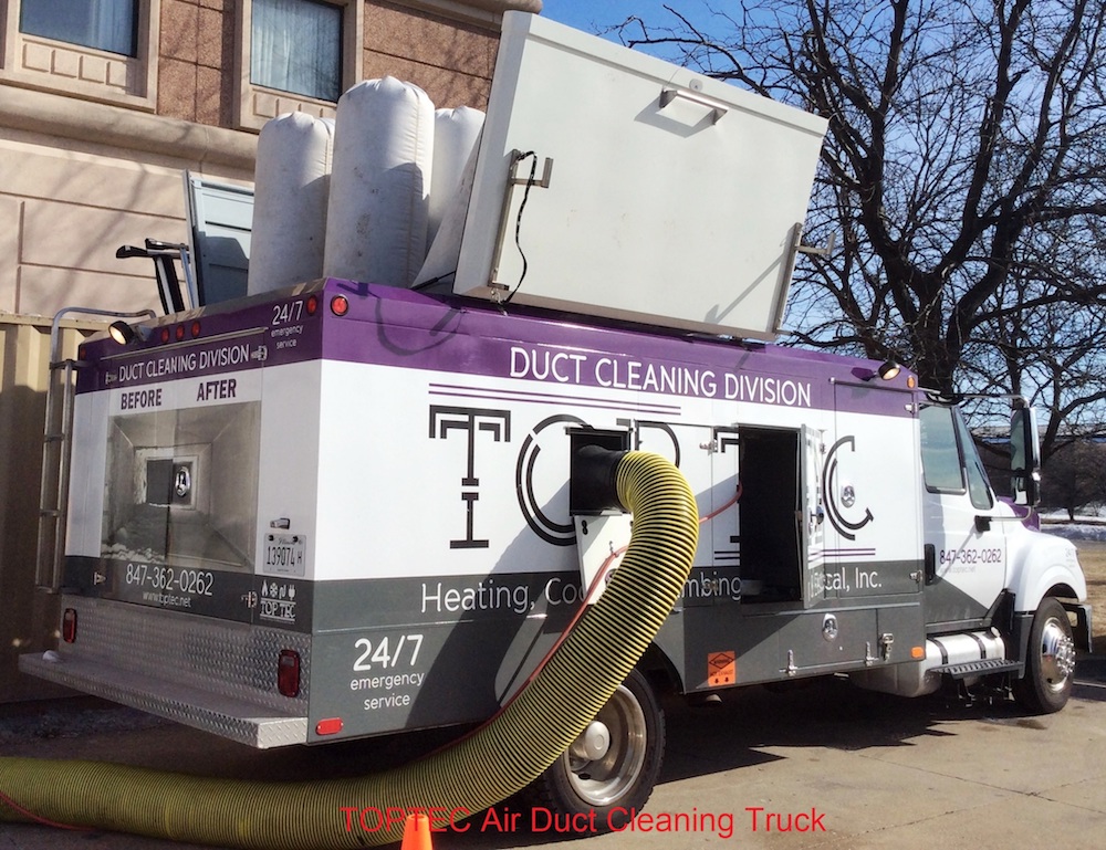

I'm pretty sure that in order to really clean air ducts, you'll need one of these...
Whats the best portable machine
there ain't one
and if anyone showed up with a glorified shopvac to clean anything but my drier vent, I'd toss them off the porch
There are jobs we do that duct cleaning is part of the work scope.
I get contractor pricing from my local and add my 20%
I'd suggest you look into that if you want to add duct cleaning to your services

Overkill for residential. I dropped my crappy rotobrush setup and I subcontract a duct cleaning company that rolls in their system to be attached to the air handler in the house, which creates a negative air suction. Then they use the air whip hose to be fed through all the ducts. I've seen it work close up and it is very beneficial if you can't afford the truck above. The web attachment below isn't the exact model. It's just a good example of the machine I'm talking about.
But...too much is better than not enough. That's what I was thinking on my latest truckmount purchase. So go BIG! Screw that little machine I just suggested
