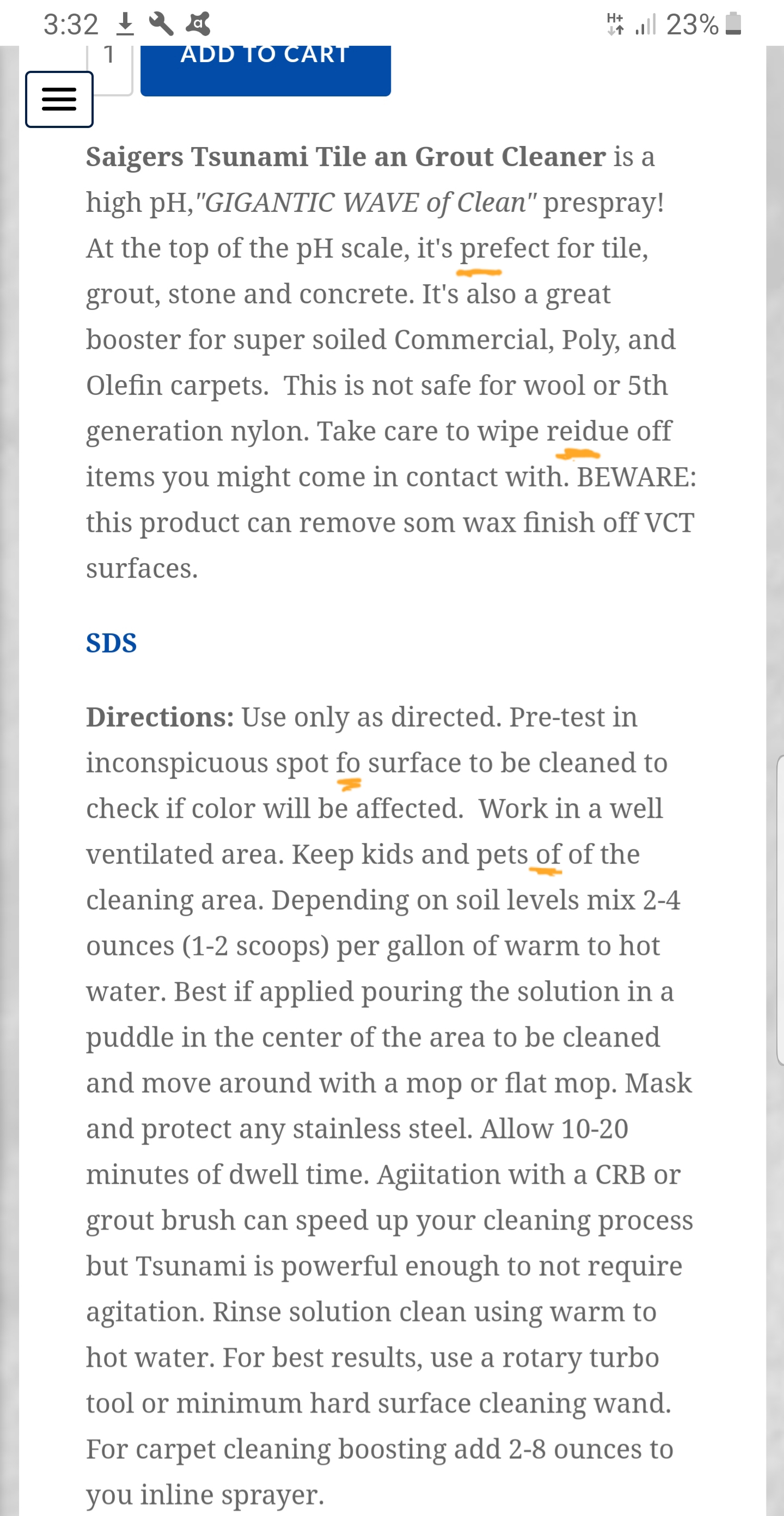

@Mark Saiger was l0okin at ur page
and decided to go school teacher on it šŸ˜‰
11,347
A mop.
Pay attention.
I agree if there’s stainless and mdf board control is huge.
On track housing with good base boards, and no stainless you can use a hydroforce, lower the psi.
Then crb. Try not to let it puddle on walls is always a good idea.
