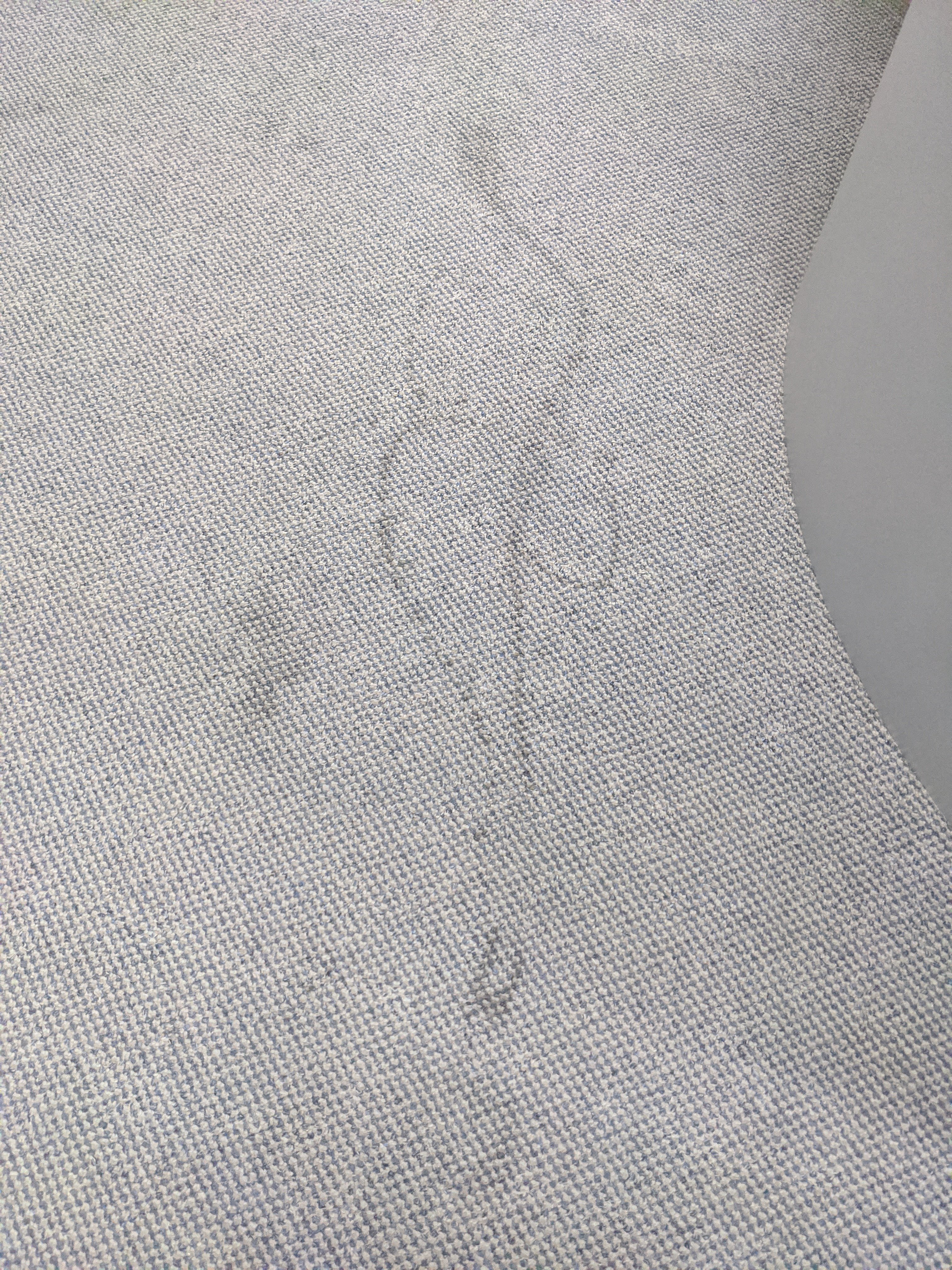

I am doing a coffee stain at 1 pm today. If I can, I will take some pics. I will be using Tanox coffee stain remover Sodium metabisulphite , first then see how it goes. Usually, that's all I have to do, then rinse.

Turns out it was a coke stain, (so they said). Sadly it just rinsed out. Forgot to take the after pic.

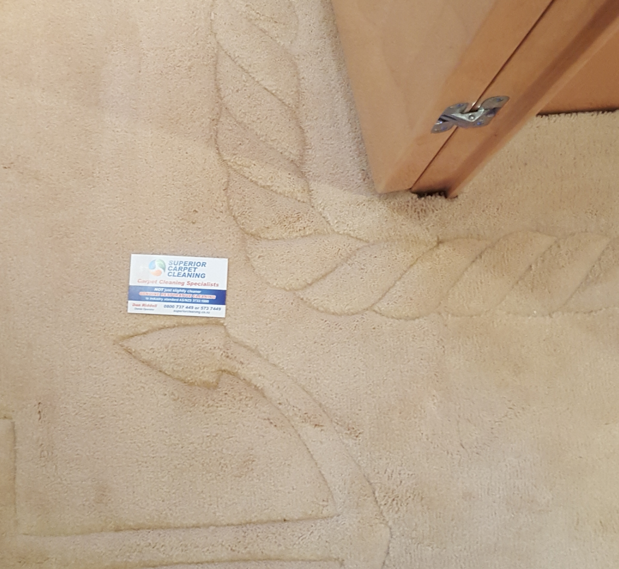

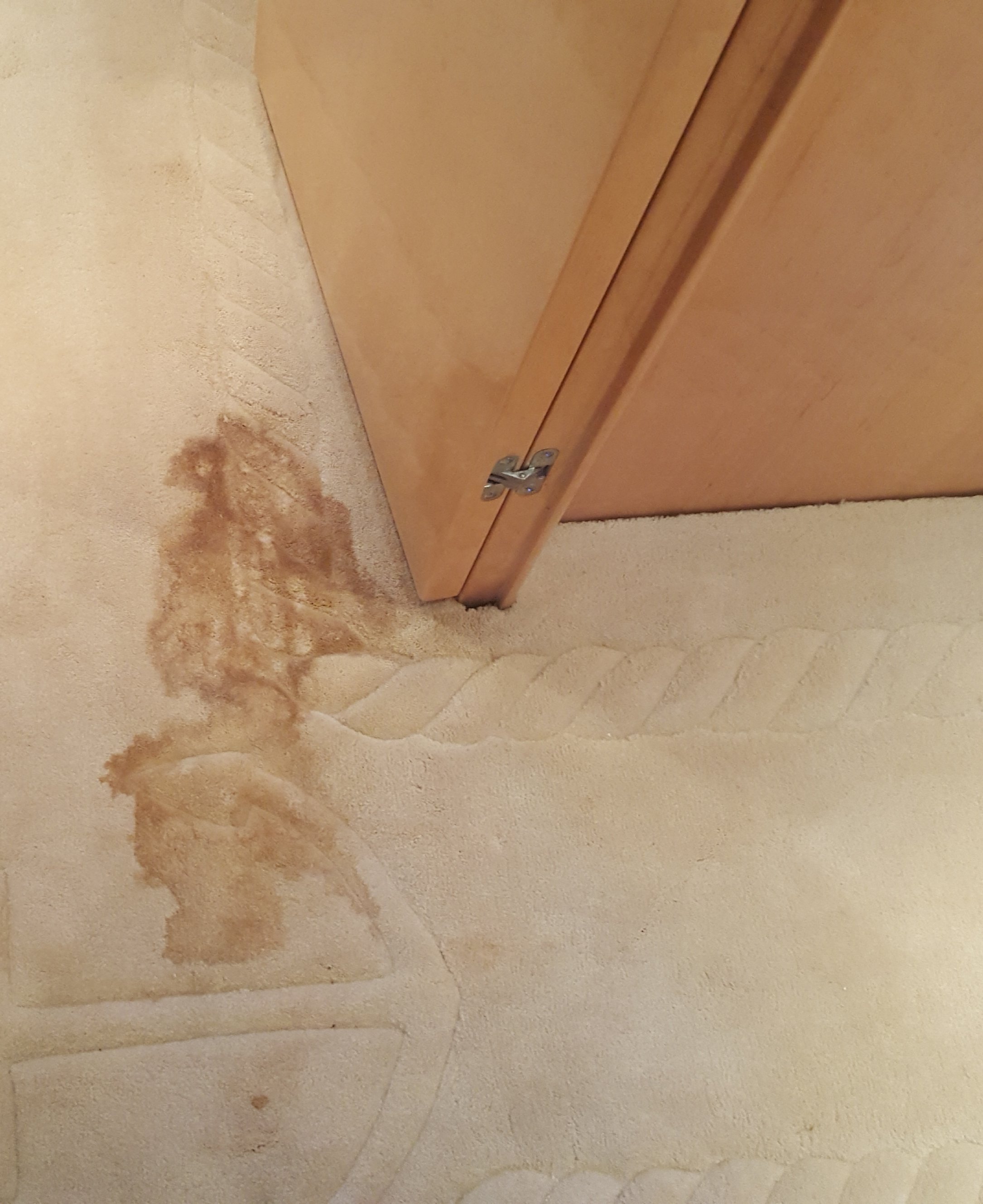

custom wool carpet on a gin palace launch with black coffee..
didnt use a reducer on this one, 6% hp rinse and remist while went did the upholstery
bout an hour or so later
