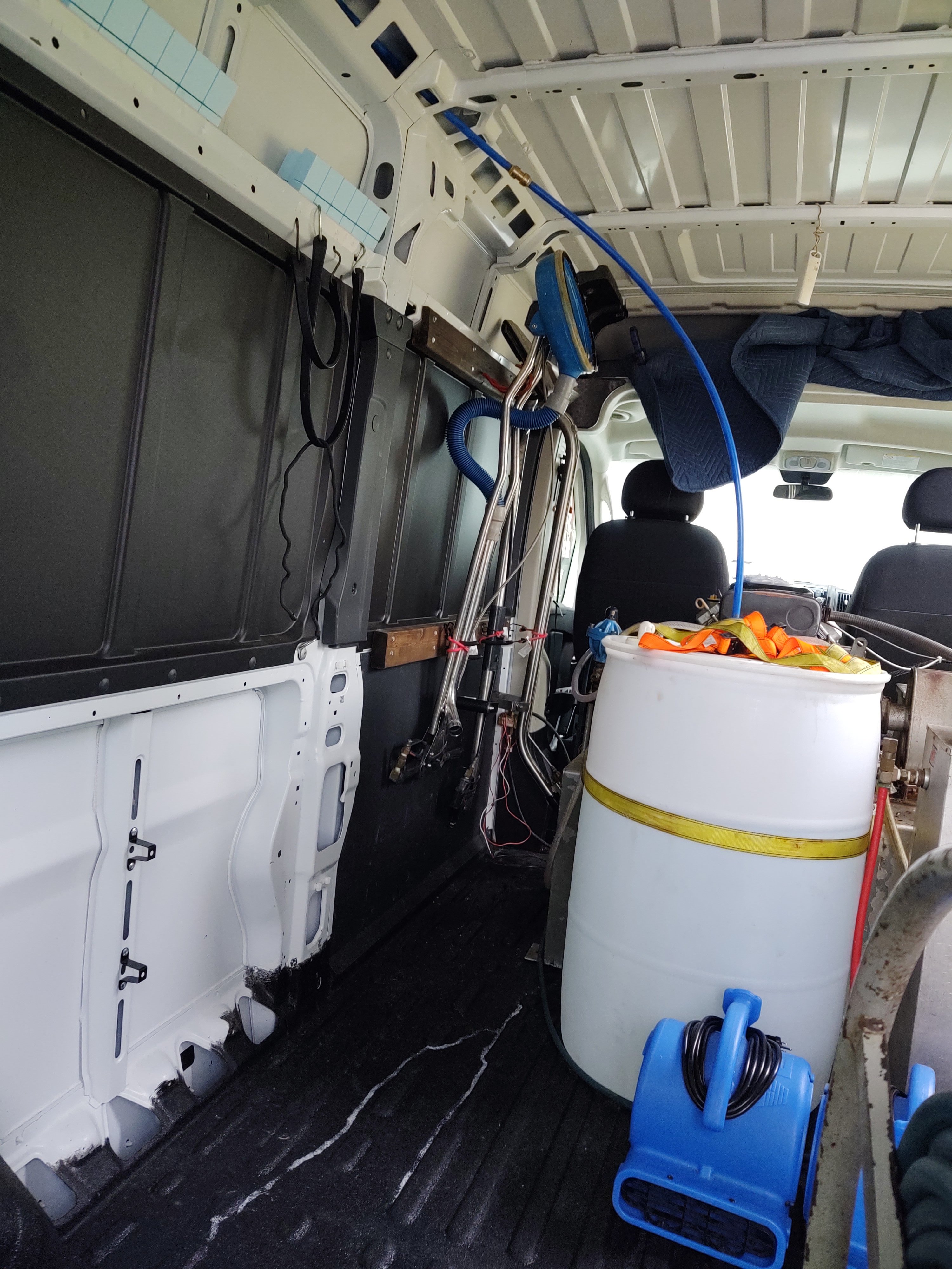

Ok what is the trick to getting the white soap residue off the coated floor??
I should of rinsed as soon as it happens.
But eye didn't.
Presprayed and scrubbed with deck brush then used 600psi to rinse with pressure gun.
1,846
N GA
BradFenstermaker
Thanks
So there is nothing that will actually remove it??
I may try some all fiber rinse and scrub by hand with brush.
I have black paint already if all else fails.
Marty you trying to get me to ruin my floor or will that work?

Seeing the rest of your van, why are you worried about that flaw so much? I covered my latest van a year ago and I'm going to redo it next summer some time. I went with light grey. About 118 a gallon.
6,544
Bc
Park on a slope with the front of the van higher, obviously.
Mix up some tile cleaner.... Tsunami seems to be the flavour of the month. ( mix half strength).
Put in small pump up, or trigger sprayer.
Apply chemical, scrub with stiff brush.
Rinse with HOT water, using your TM, with a pressure washing wand.
Apply double strength cleaning vinegar, full strength. Scrub again.
Rinse again.
Let dry.
Apply Aerospace 303, or the stuff Mike likes to use.....
PROBLEM SOLVED....
How do I know? Cause when mine gets white streaks, that’s what I do, and it looks brand new again....
Thank me later....
