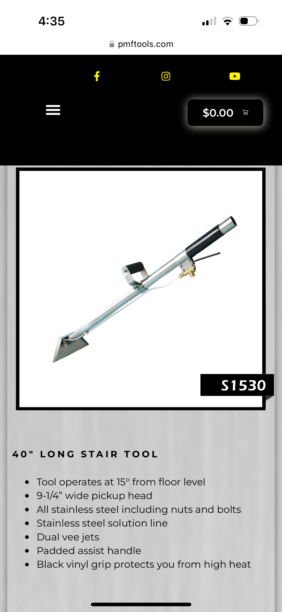

I'm not interested in making tools when I can make unexceptional tools, exceptional...
for example

We only clean them if they're dirty. They do get presprayed, rinse is sprayed over them then we use the end of the vac hose to extract the bullnose and the riser. I like the PMF swivel stair tool as the jet comes down over the bullnose, giving it a good flush.

cleaning a riser with an "s" shaped stair tool is a pain.
remove the bend at the head of the wand and it will be more enjoyable . I told you Mike when you started setting your stair tool that the "s" shape is not the best out there
