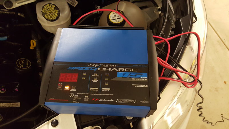

My mechanic buddy talked me into getting this thing to charge all my vehicle batteries every 4 to six months.
He says the four seasons drains them quick out here.
Never worried about it in Cali
But I was never impressed with my battery life either..
Any of you follow suit?

Might be a good idea, but never seemed to have an issue with my battery life on any of my vehicles.

You will definitely see a difference topping them of now and then. I use them a lot at my car lot. But that being said the cold weather is what kills them. So keeping your truck in a heated garage definitely prolongs the life. I got 12 years out of my original truck mount battery.

Lead acids batt's really would like to do there job charging and discharging at 70 degrees. Much higher and colder temps have significant effects on performance and then life span. If that charger is designed to blast some constant current on demand (to push back hard sulfation) I would say it could help with longevity. In automobiles 3-5 years is the average life and what manufacturers have in mind. Fancy charger you got there....

I would amend that statement to "extreme weather" because very hot weather (like in Phoenix) kills them too. It's a miracle to get three years out of one here, usually have to replace every two or sooner.
I use a battery tender to maintain batteries that don't get exercised a lot (like on my generator) and they help greatly, however IMO a battery that gets used (and charged) daily does not need one. Just have a rule that once you start the engine you let it run for 10-15 minutes minimum to replace the charge.
