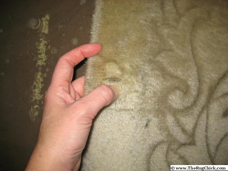

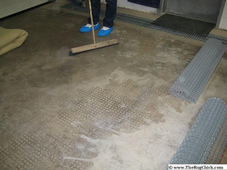

Here was one of the rugs we washed - a Chinese rug that had strong GRAY areas in the field. We dusted it with the Badger and got pounds of soil out of this puppy. Tested it side by side with an upright vacuum, and the Badger out beat it hands down.
We washed the rug thoroughly - using rug shampoo, a Cimex scrubbing, and rinsed to see the results. But those gray areas as you can see, had heavily impacted soil in those base fibers.
A couple points regarding this:
1) ANY dusting method, even as aggressive as the Badger, canNOT remove soil that has been attached to the fibers with past cleaning residue. All dusting methods remove DRY soil, not greasy, ground-in soil.
2) This is the biggest danger with rugs being cleaning in the home, or in a plant, using surface cleaning methods and no thorough dusting step. That soil becomes mud, and creates hard impacted soil all along the foundation fibers that gives that gray cast to these rugs. Long term this contributes to dry rot, and in some cases strong odor problems. It also is VERY difficult to remove with standard "wool safe" chemicals and soft brushes as are on the Cimex.
I wanted to see what a standard wash process, using recommended rug approved chemicals, following a thorough dusting, would do for this rug once over.
A regular wash was not enough. Not because it was not thorough, but because this rug had not been thoroughly cleaned in the past (when we first got it wet suds came up from past residue).
Because this rug did not have dyes to potentially bleed, a few things could be done here which worked (but took time) - using an enzyme to help break up the soil, and using a stiffer broom floor brush (stiffer than the Cimex) to brush at the base of these fibers throughout the rug. Much more manual labor was required, and more aggressive chemicals, due to those past surface cleaning efforts. So the second wash created a much cleaner rug. If this rug had dyes not colorfast, we would not have been able to spend as much time as we did on this one.

Lets compare that to a commercial gluedown that has been Chem Dryed, Stanley'd, Rug Doctered, Kirbied, Coited, mopped and basically pounded to hell and back and then a over zealous Mikey Boarder wants to get it all out in two wand strokes from his $100,00 Vortex.
Not a chance in hell.
Best off just cleaning the very surface and recommend replacement. Some caret and rugs are just not Hero material.
As for teat rug, I've seen workers at the Talisman work on mud cakes like those. Scrub rinse, scrub rinse, scrub rinse, scrub rinse, scrub rinse, scrub rinse, scrub rinse, scrub rinse, scrub rinse all day long..
That kind of work must be worth $30 a foot.
I'm gonna guess that you had no idea it would take that amount of labor but stuck to your original bid.
Just like Residential work, you got to take the bad with the good.

Actually, we were visiting a rug plant for the class, and I knew it would be an interesting case study - so I decided to tackle it with one of my Piranha crew. This means the owners of the location billed for the work - but we did the heavy lifting. So their profit margin was HUGE. :)
In fact... I picked the two toughest rugs to tackle - that one and the dry rot pet urine soaked 9x12.
You see... when I teach, I don't want to pick the safe and easy textiles... I want to pick the ones that are a bitch to handle, and the ones with the risks. (That's why when I did the rug and restoration one day events, in Tampa, we decided to play with the pet stained, blue dye bled, silk rug...) http://therugchick.com/2009/08/06/tackling-a-silk-rug-in-tampa/
If I can teach someone on a tough rug, then they are way more confident in tackling any other rugs.
Two options if this had come into our rug shop - 1) I would have charged double for "restorative" cleaning, or 2) I would have given a thorough regular wash and told them it needs to come in again within the next year for another wash - eventually you will dislodge and get it better, but you are right, it does take time and labor.
These were fun ... but only a rug whack job like me would say that. :)
