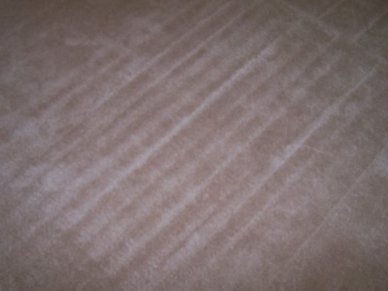

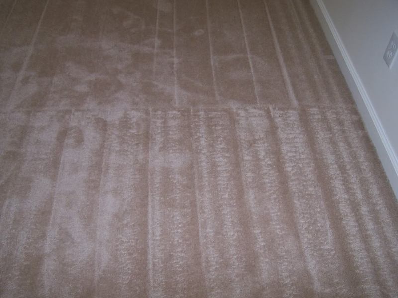

Could it also be proper wand heighth, it looks like the aren't holding it upright enough and the jets are impacting the carpet.

It's inexcusable to do a whole room and not know to turn down the pressure just a tad on these cut pile carpets.

I'd be curious what kind of wand with what PSI did that.

Well that can be accomplished from not extracting well. No matter the psi; if you do a dry stroke that will disappear.

I would re-think that comment
We extracted that carpet with .12 flow and 260 Deg heat (something you can't understand with your resoil) and we never fixed the carpet.

Chris did you try running a neutral detergent in a Cimex using hot water, and then extract normally ?
I ran into a similar situation last week. The brushes from the Cimex took the distortion out of the carpet, and then extracted; looked fine.

I would vacuum first, then pretreat, agitate then extract going the opposite way of the lines. Shocked it didnt restore it. You got post pics of your work on it Chris?
I think the PSI was the same on all the carpet, they just slowly dragged the wand causing the stripping. With it being cheap carpet the heat may have damaged the twist in the fibers.
