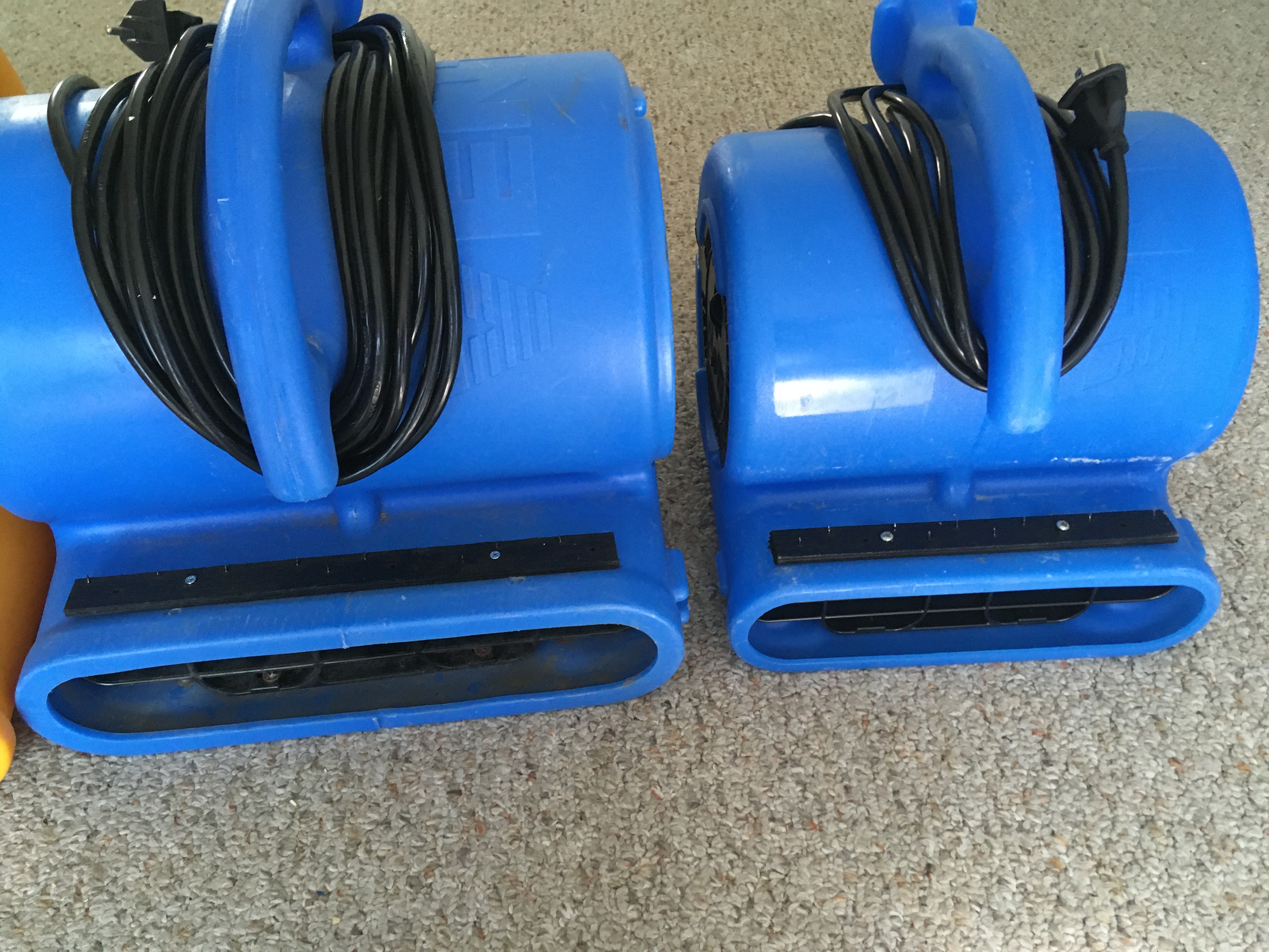

I have 3 clamps that Ive saved over the years. Good ones are hard to find now. But I since switched to tackless strips and Feel they work much better. Especially with the newer style airmovers that tend to have a shorter snout.
Before buying a clamp just try the tackless, I think you'll prefer it to a clamp. You don't have to lift the carpet quite as much because you just tilt the snout of the airmover under the lip of the carpet then when you sit the airmover down the carpet is tight. Obviously the nails in the tack strip should be facing the air mover, I painted all my strips black here is a pic

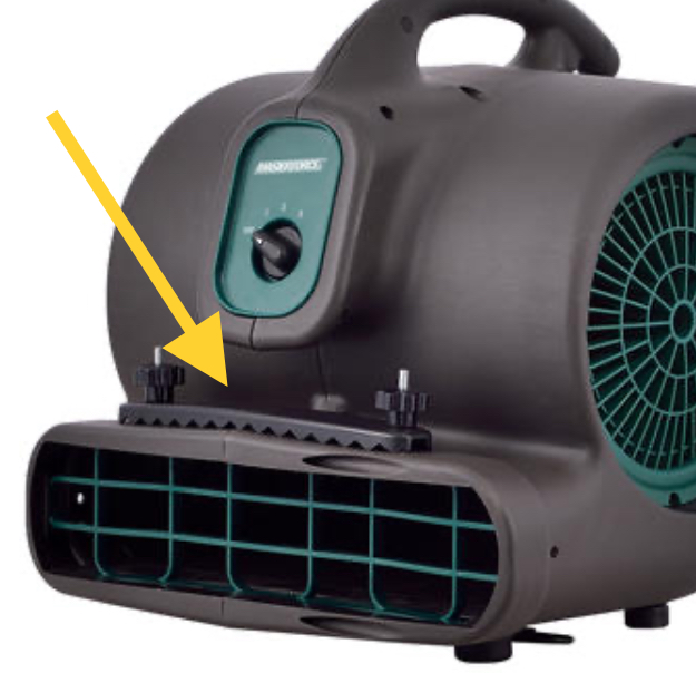

49
By the way the clamp in the first pic is the worst. It isn't deep enough to really grab the carpet and hold it tight. That clamp is sold by Airchaser but its the worst clamp I own. Heres a link, but hopefully you'll try the tackless. Its the best way to hold the carpet when floating. Carpet is tight no flapping and no need to set the pins just tilting the airmover is enough, you'll see
