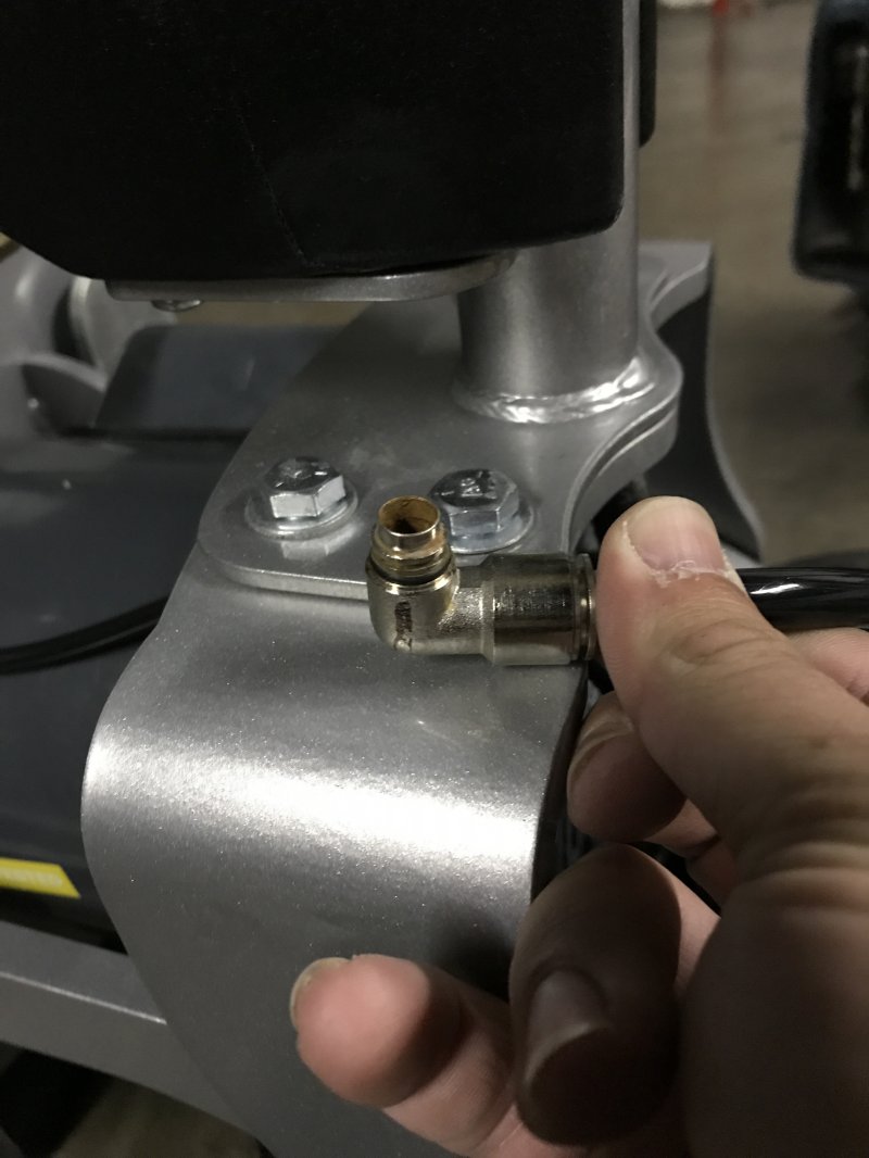

I went to a portable job to HWE and used the Vibe to scrub.. The elbow on the bottom of the tank somehow broke.. I didn't notice it was broken until I seen the puddle of solution on the ground.. I haven't seen that style of elbow and unsure on how it connects to the bottom..
Anyhow, I tried looking up parts on Orbotusa but no dice..

It looks like a 1/4" 90-degree elbow, quick connect.
But the clicky thing is missing. I'd look for a hose with a plastic end on it that is supposed to snap into that open end. It may have just jerked loose.
God knows there are enough jerks loose around here...
Anyhow, if it doesn't stay connected, just substitute a compression fitting or something with barbed ends.
Nate, it appears that fitting broke into two pieces. We use nickel plated solid brass fittings on the Vibe, this fitting may have broke due to an impact of some sort. You will need to remove the male threaded portion that is threaded into the tank, and then replace it with our part number: 02-001. If you email me your information I would be happy to get a replacement out to you.
