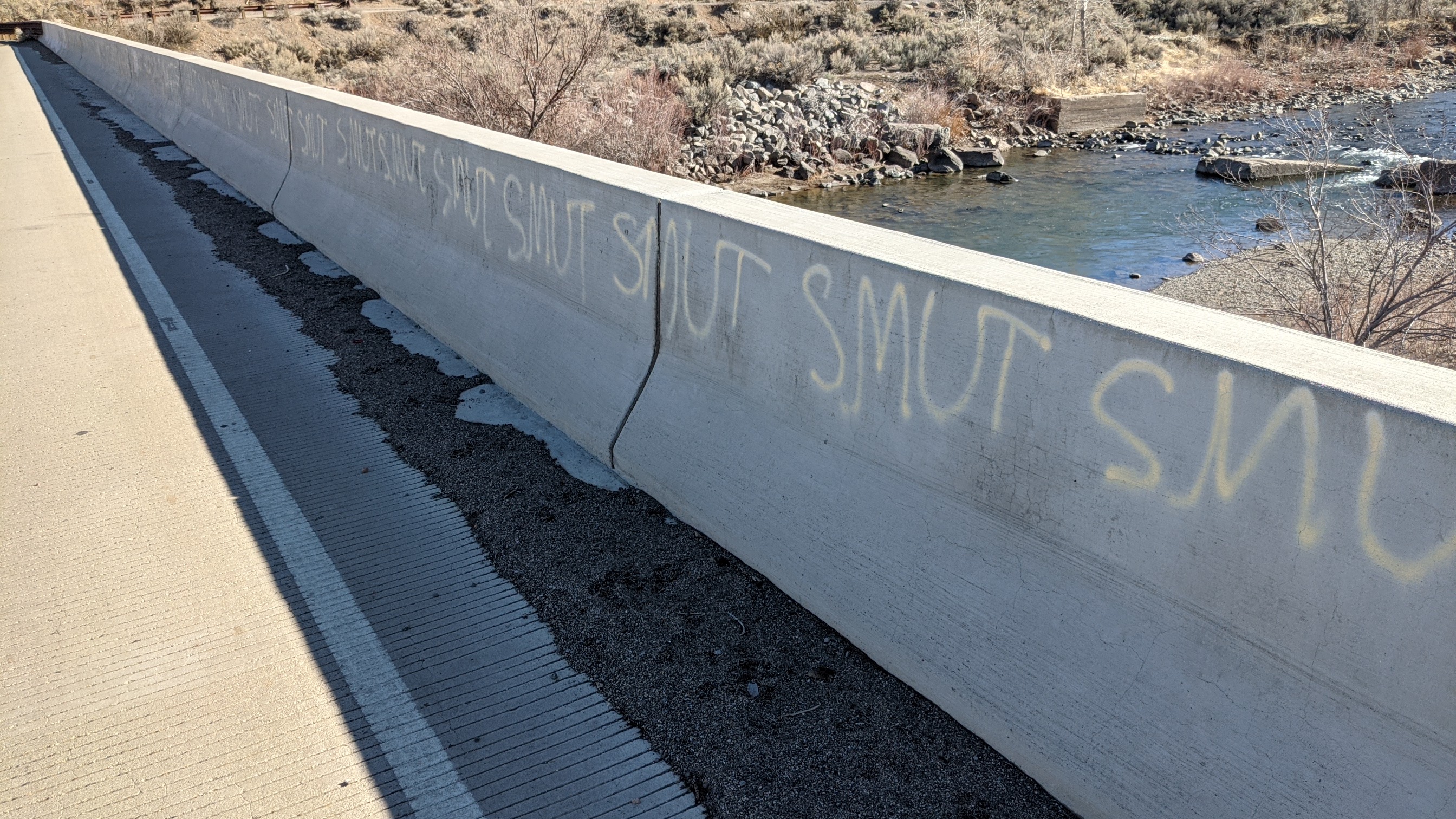

Anybody know anything about sandblasting graffiti off of concrete?

I saw that on your FB group. I saw someone posted to sand blast it. I didn't reply because I don't care. But.... Sand blasting it would etch the cement. I would soda blast it off. Also it's better for the environment.
You should also check with the local police/Sheriff Dept and see if they have a graffiti unit that takes care of that stuff.

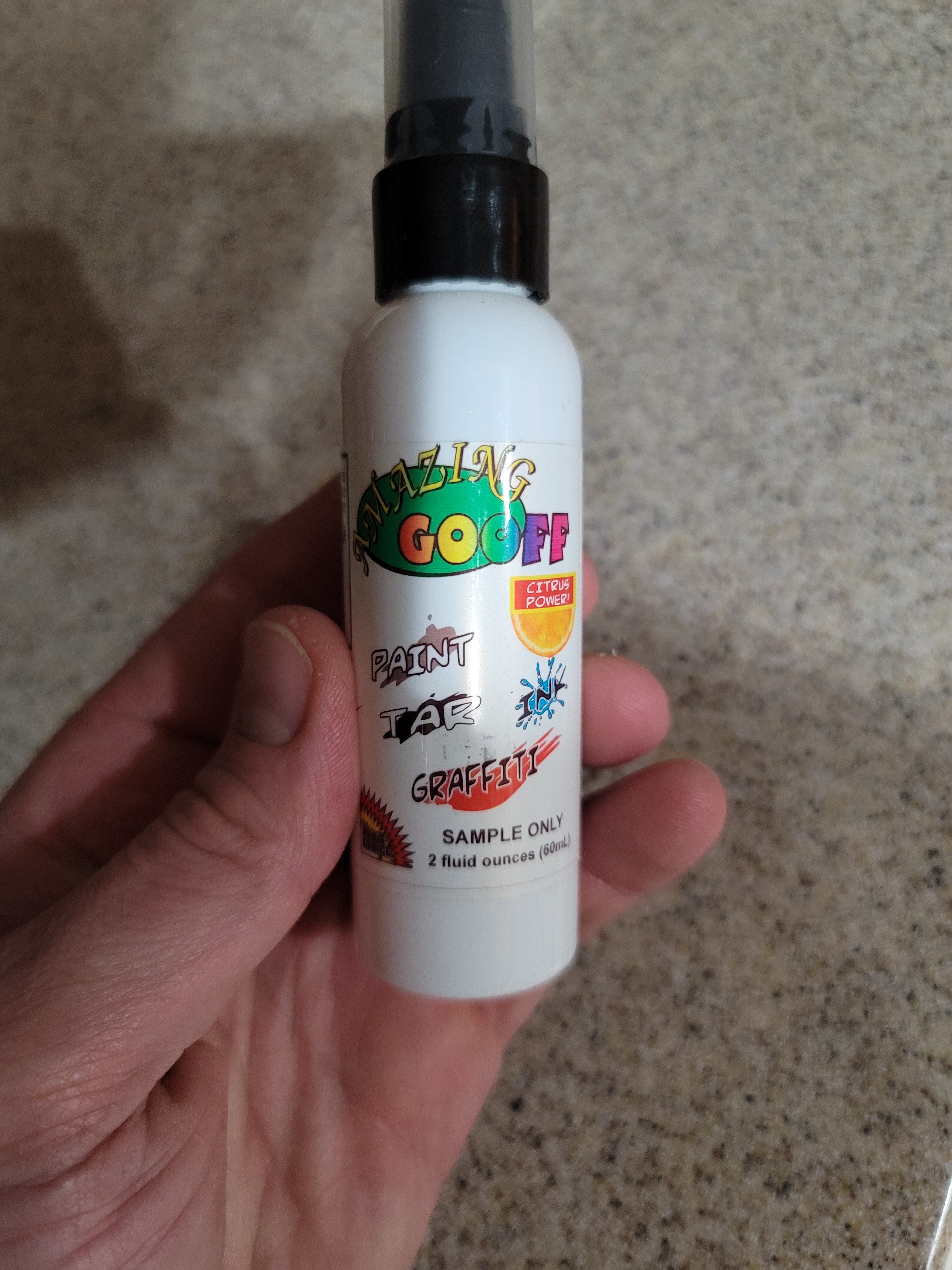

Have you tried this Goof Off? May be an option if you don't want to invest in soda blaster. I believe they make larger sizes. This is just a sample I received.

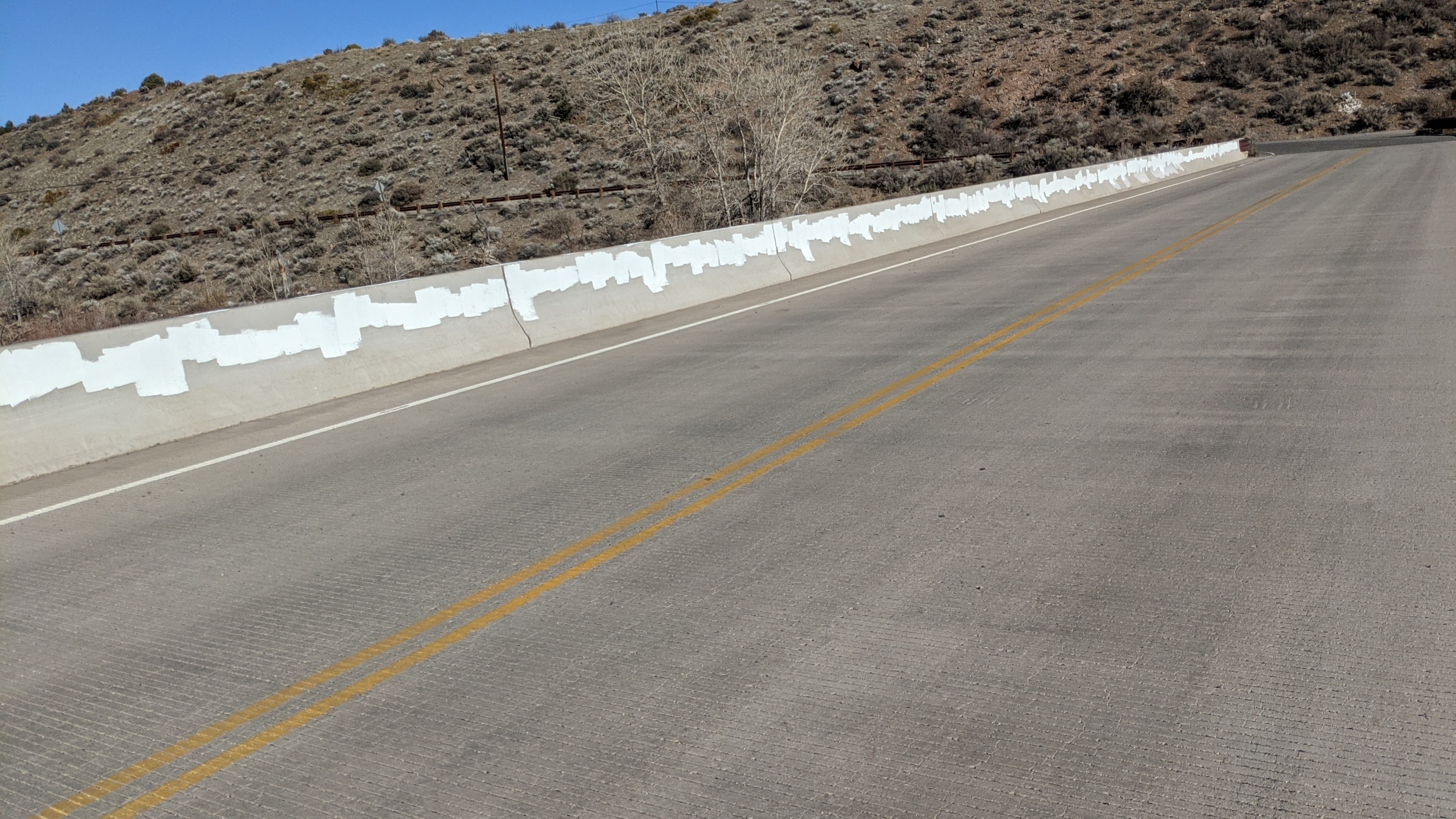

Imagine how quick and inexpensive it would be to spray a yellow line across the barriers
if it is destined to happen again by the local ’artists’ there is virtually no permanent solution
so why not choose the least damaging to the concrete and the surrounding habitat and wallet
this poorly execuTed paint job looks like it is covering “ Marty is an asshole” multiple times
