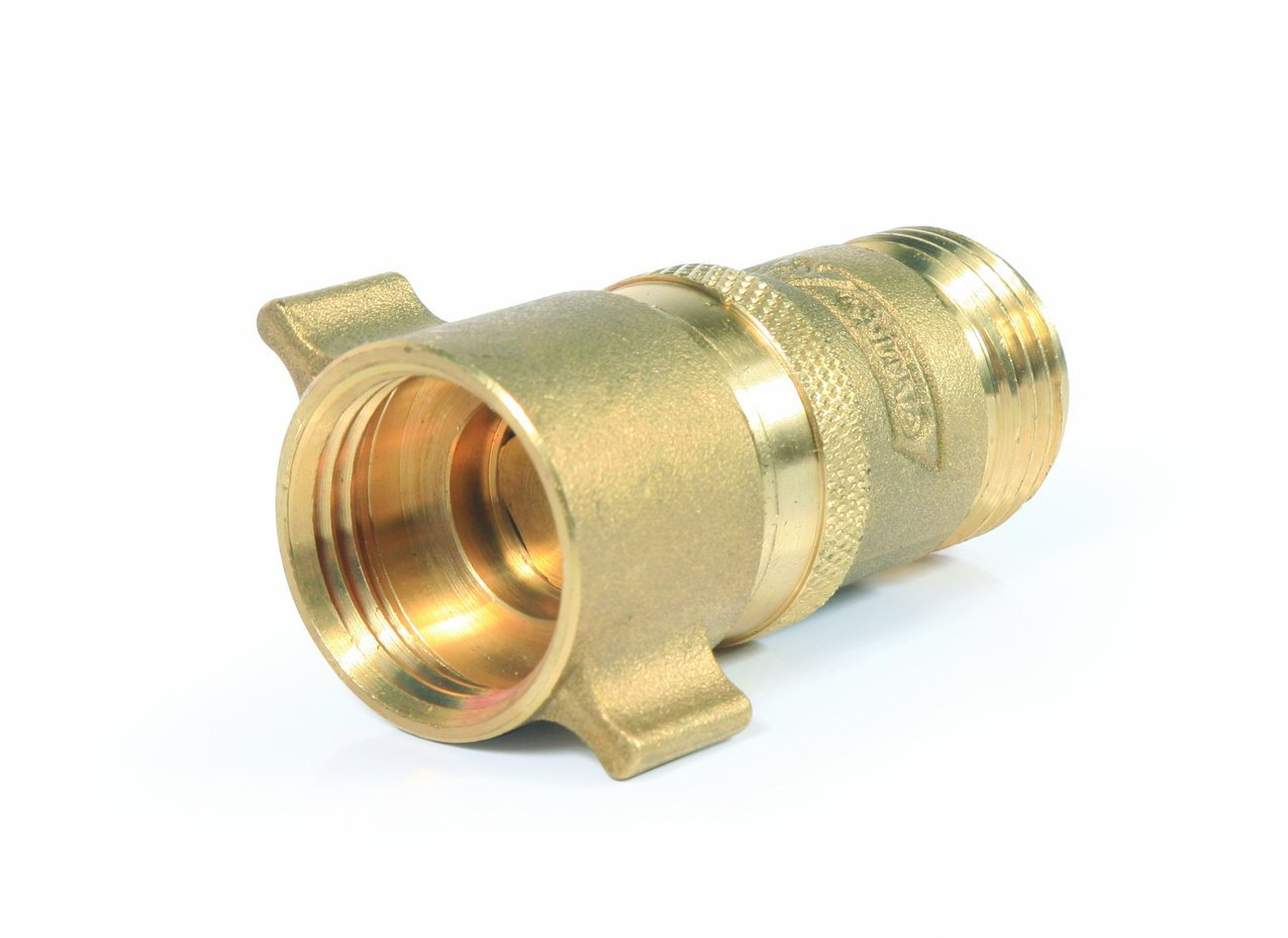

If your incoming pressure regulator isn't this...
Call Scott Harlib on Monday..

Kinda ridiculous that they are just doing this update now... For years we were all told to use one of these dumb things.
86590
Those with older units before the pressurized waterbox, water would rush into the box and push the float down. This caused the machine to overflow and dump water under the van.

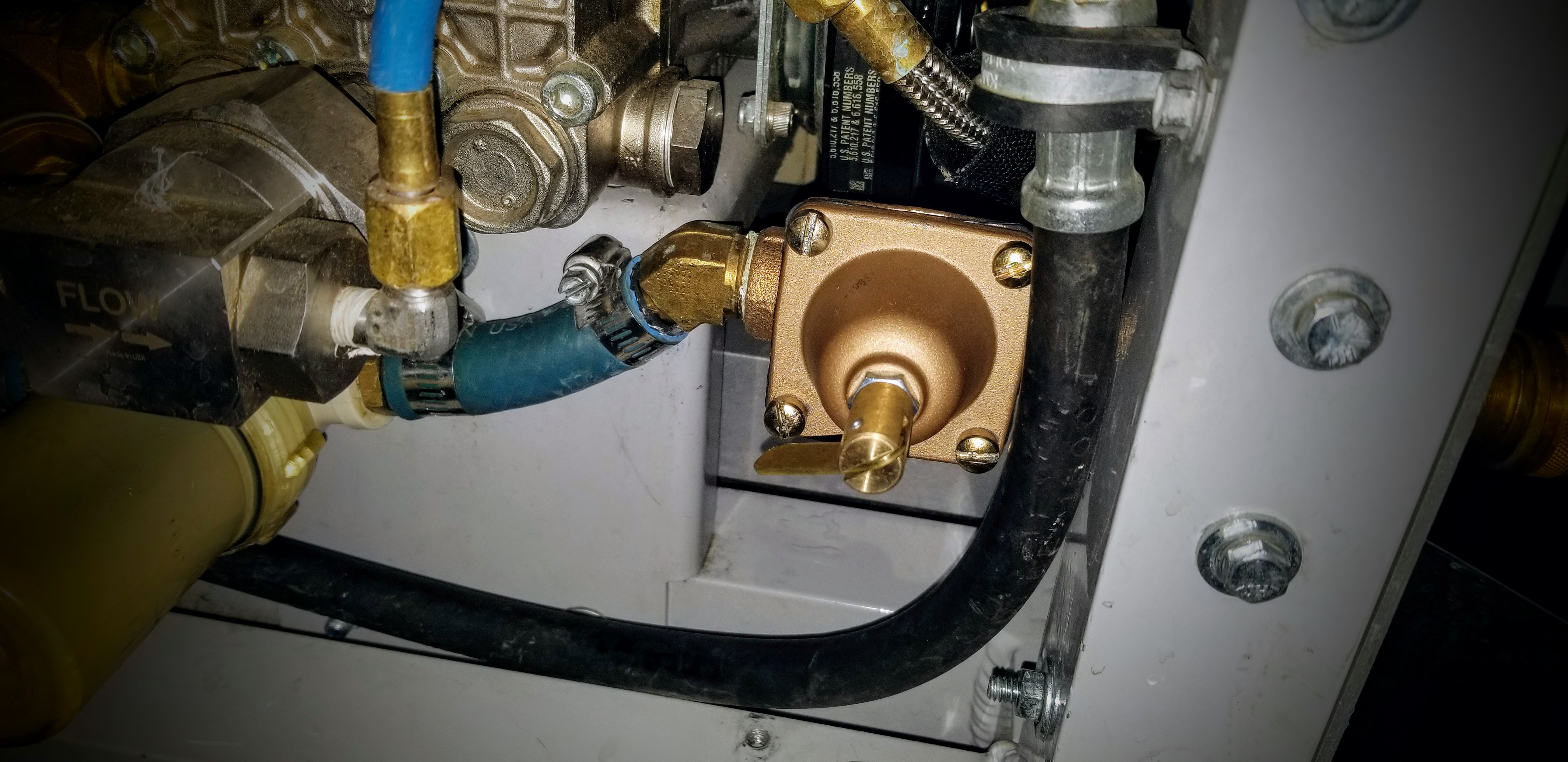

I'm thinking I may need to upgrade to this. I'm having issues filling my waterbox, especially with dual wanding. I'll call when I have time. Anyone know how much this upgrade costs?

you can probably get one at your hardware store in the plumbing department.

I don't issues with my stock regulator when wanding alone but when I do it's a pain. I've taken it apart twice now trying to fix it, but I just think it isn't a good setup for dual wanding at 24 flow. It seems to restrict the water so much the water box empties faster than it can fill. It also does this when doing large jobs alone with the Zipper SS. Hoping this new regulator fixes that.

Did you install the new thermo valve kit?
