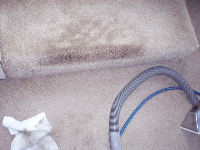

Tell me how you handle filthy staircases.
I had one today that pitched pretty bad.
Cleaned only a few times in 20 years.
We vacuumed, pre sprayed, granditated and V rinsed but the bull nose still looked bad.

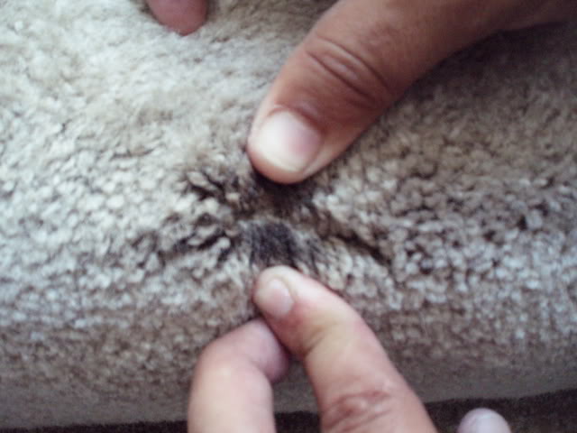

I parted the fibers to find thick gooey crud surrounding clumps of fibers. No real pattern to the cruddy areas but each step had a few goo gobs.
Mrs Piftleton nor I had any idea how this happened.

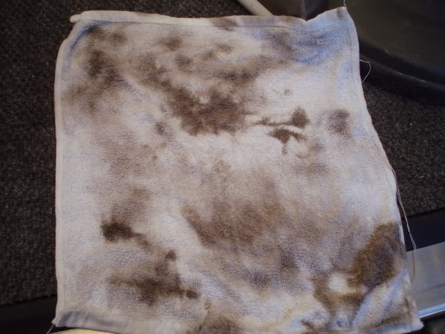

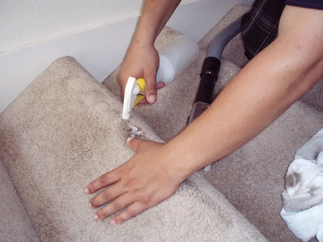

I tried spraying ENC and toweling it off. I stuck my fingers in there real
good and scrubbed like hell but all that did was spread it around. We are talking thick sticky mud here.
So I attached the PC hand tool and cranked up the pressure a bit and basically pressure washed out the goo.
I tired to imagine using one of the mini pad machines to do this and had to laugh. No way.
Flush baby FLUSH!!!!!
Took way too long but we got it looking pretty good.
Twenty years of wear but she was stoked.

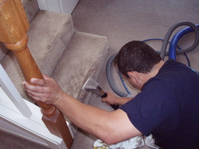

I normally do it with a portable & an upholstery tool... I guess I'm not OP only though...

Thanks Mikey, that is one of the favorite things many say about using OP on stairs, it is easier and faster, we use the StepSon for that job.

That rag work was before I pressure washed it.
This job reminded me of the many car mats I've pressure washed where it takes over 15 minutes for the water to run clear.
I've never seen a staircase so gooed up that was not directly connected to a garage before.

Mike, John is right . The step son would have corrected that problem fast. I started post padding all my staircases. I am using a variable speed sander/polisher with synthetic pads (purchased from Cobbs supply) and have been very pleased with the finished job every time.
You shouldnt be so quick to judge till you actually try it.

The StepSon looks like a very excellent detailing tool and would clean faster and more evenly than the furniture tool in Mikey's picture.

Definitely, this is a limitation of any vlm system. No way in hell are you gonna get dirt from so deep in a pile with a rag. Same goes with filtration lines. No doubt the buffers will make it look good but the dirt will still be there.
Mike, I'm wondering why you didn't use your hydro force sprayer to drench prior to extracting. Also does the glide come off the tool easily. Seems going glideless in this situation would give more control. Or would you even be able to move the damn thing.
Albert

Boy oh boy some of you guys have a hard time reading.
I really wish we had a pic of the final results. But the home owner was standing around as we finished up and I didn't want to embarress her any more.
Who was the bonehead who said that we didn't pre inspect properly?
Do you open up each and every bull nose to see if 20 years of hidden goo lies within?
Yeah right....
I would bet not a single one of you who commented have a glided PC tool.
It works just fine on bullnoses.
When we were trying to remove it with a towel it just spread the crap around. No matter how many times we flipped it or added more ENC, cotton was NOT going to make this go away.
What finally got it all out was ENC and tons of HWE!

I guess I'm the bonehead...but I think I could see that gunk while I'm walking the steps let alone while I'm vacuuming.That gunk in the shots is something I normally wouldn't see on a monthly basis.
My comment was only on the thought that because it ( the goo) was soooo thick,....(actually looks like some kind of greasy,oil crude thick splooge of the likes I've never seen from normal soiling on a stair case) maybe an application of the appropriate spotter,in a heavy dosage,with extra dwell time,would be in order.
Was I there with you?....no.How am I supposed to know if you casually glanced at the steps or not?If you can't take a little constructive criticism every know and then without getting your panties in a bunch,then get off your soapbox...Herman!

116,006
Mike said:
We did do a heavy PS with the HF, grandi groomed it in as well. Every thing came out fine with the TI wand but these random gunked areas.
It was way wierd how they were so thick and spread out. And for what ever reason only on the bullnose.
The glide pops (pulls) off that tool pretty easy. It's a slot type so I dont see how going glidless would have helped.
