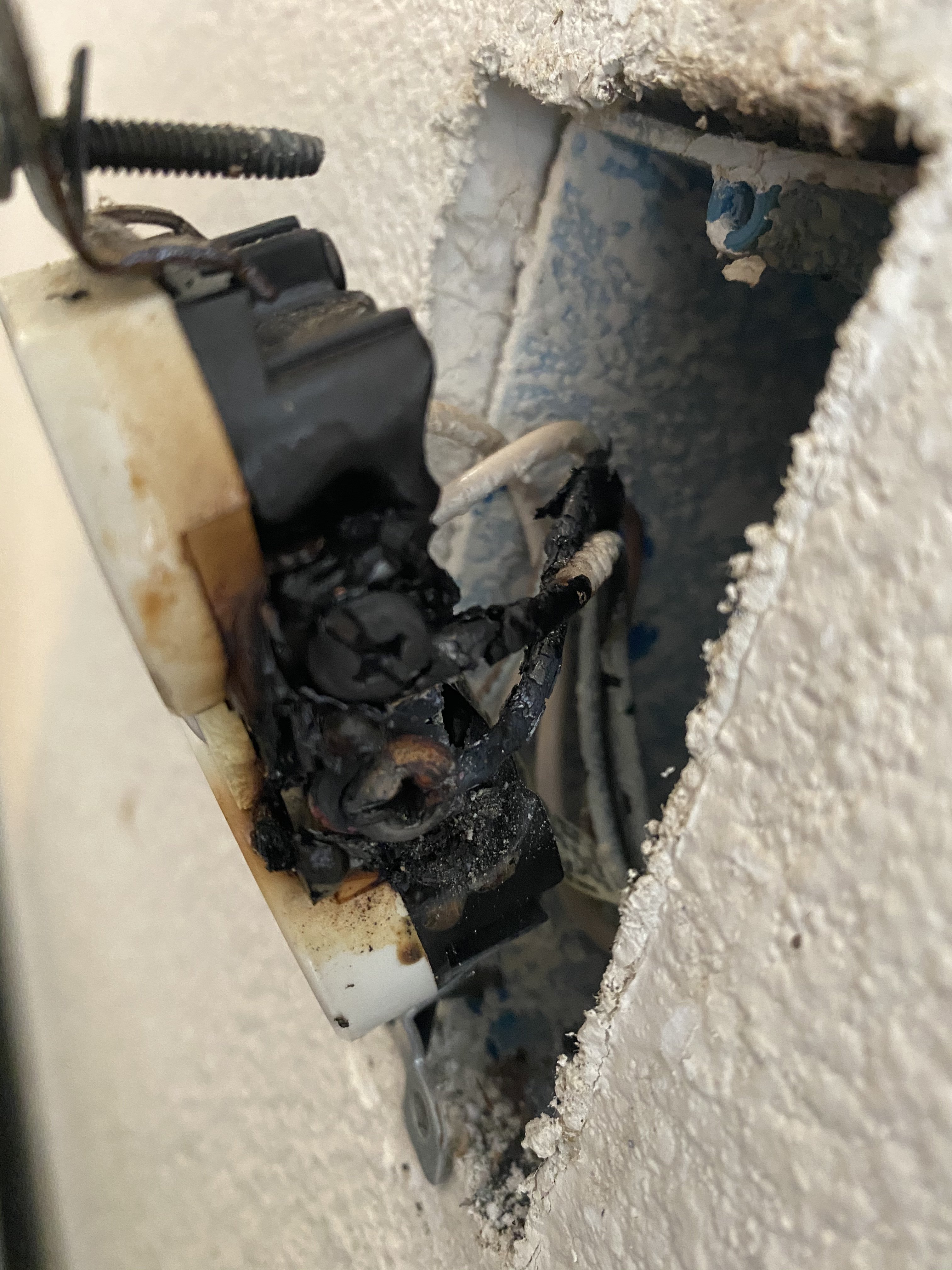

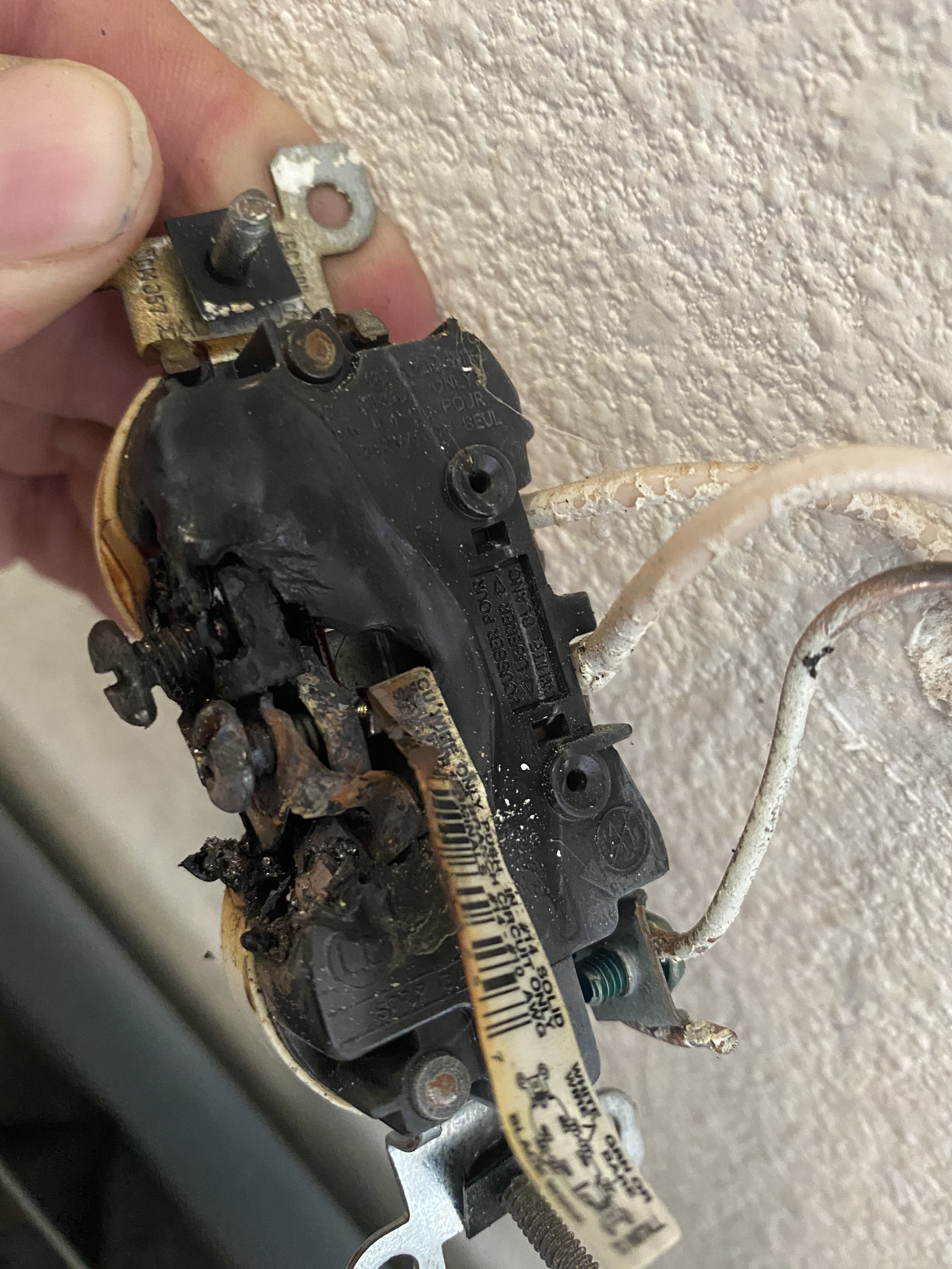

I tried to log into one of my security cameras but couldn’t because the wifi extender was not working. I figured that the fans I was using to dry my rugs tripped the breaker.
Drove to the shop to check on things and discovered my wifi extender had melted and the plug had shorted out. Very scary. I’m lucky my entire shop didn’t burn down.

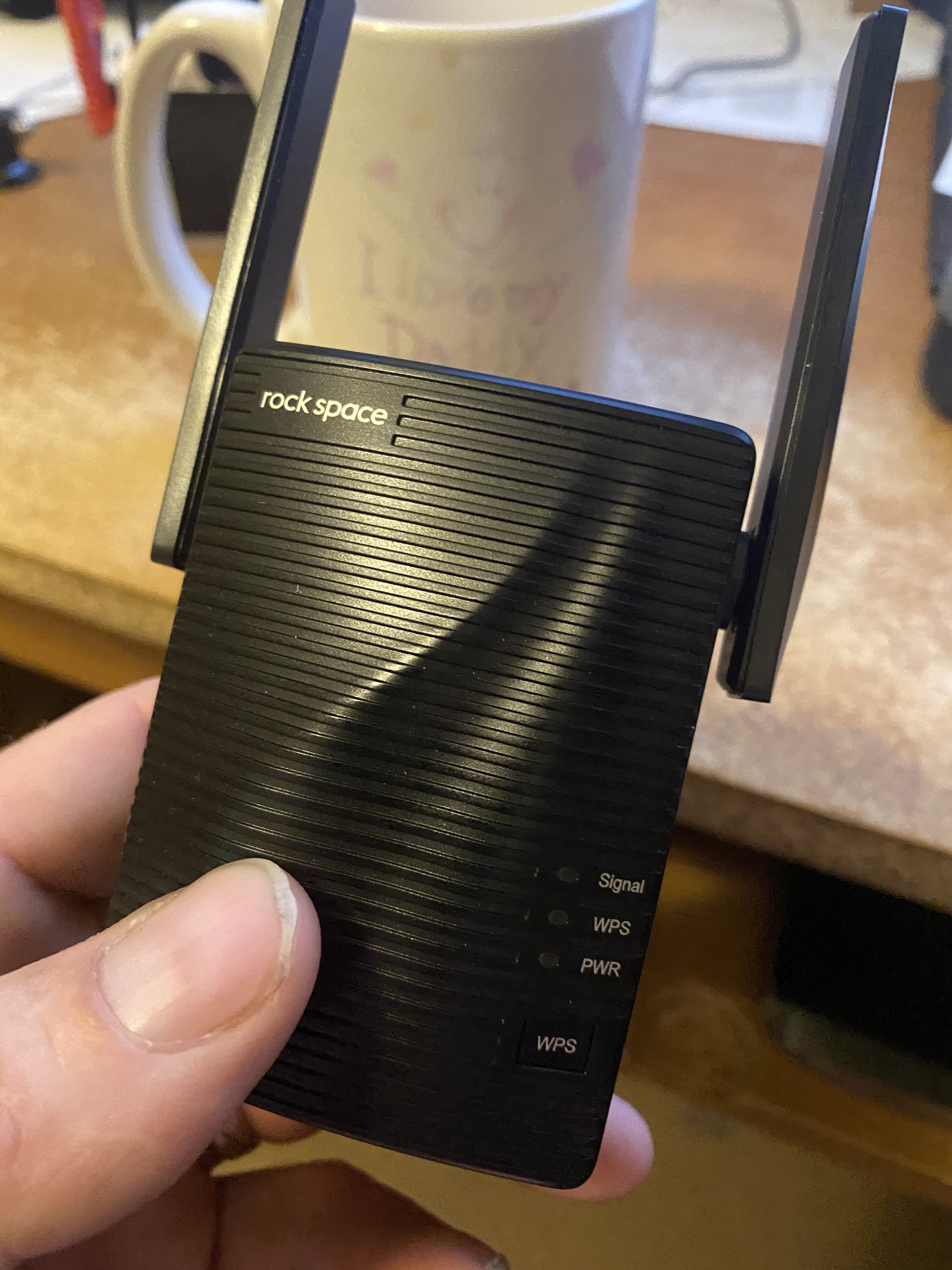

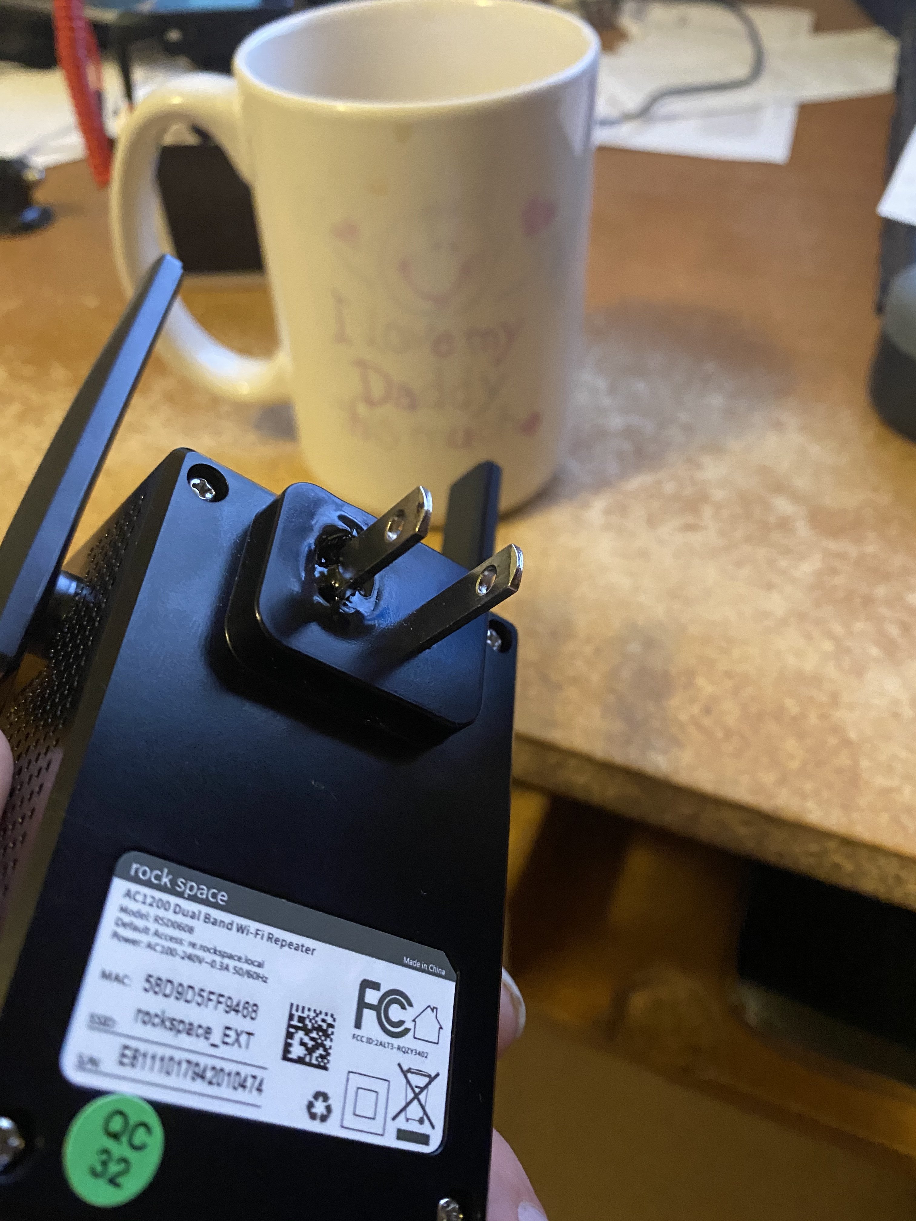

I don't think it was the Wifi extender that caused the plug to fail. I think the plug itself was bad. I had noticed a slight browning coming from the plug about two weeks ago but thought it was caused by my vacuum not being plugged in all the way. I guess not. Thankfully the GFI worked and shut things down. When I went to the shop to figure out why things weren't working, I reset the GFI plug and saw a blue spark shoot out of the bad plug.
You can see in the pic that the Wifi extender got so hot it melted the back of the plug part. I tried plugging it into a working outlet and it no longer works.

All plugs are 20am and also have 50 amp plug for RV or whatever.
I think the issue was the plug was just bad. I thing somewhere something got cracked inside. The breaker never tripped but the GFI did. Im happy it did. My electrician buddy is coming over to look at it.

I just spoke to our electrician since he was here doing some work and he says the most likely cause of that happening is the outlet wasn't make a good connection to the plug. Or in other words, a worn plug.

A lot of newer outlets use compression connections rather than using a screw. Cheaper outlets don't hold the wire very well and can short/break and melt like this one. I've learned my lesson and don't buy the bargain outlets and switches at HD anymore.
Have your electrician buddy check out a few good outlets while he's there.

And our electrician says to never use the stab connects. Always use the screw connector.
