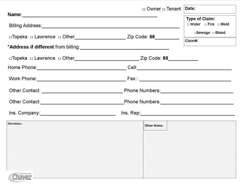

I use this simple sheet cut down to where I can carry a couple folded in my wallet. It keeps me on track asking the right questions. The guys that do this every day know this stuff easily but I don’t get it all unless I have it to use.

That card is a great idea - I may get a few made up for my guys when they are on call to have in hand to use if they aren't ni a position to pull out the job folder when the phone rings.

PM me your email and I'll send you over the Publisher doc and you can just change it to your info.
