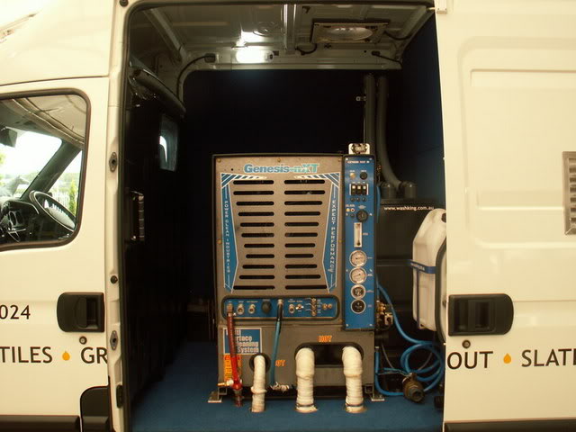

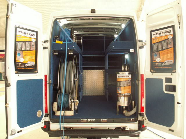

I couldn't agree with you more. HEAT KILLS TRUCKMOUNTS. We walk away from some deals because some customers which to purchase large machines and fit them into vehicles that plain and simply DO NOT have enough cubic volume of air to keep the machine running with a constant supply of fresh air.
Over here in Australia, we have to be extremely vigilant with heat built up. We highly recommend to all of our customers that we install roof vents for them also whilst we are fitting their new machinery for them. We do a bit of customization to facilitate this. However when we are finished, we can keep even the largest of truckmounts running consistently without overheating issues.

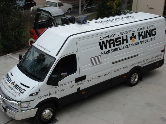

For instance, this Genesis 59 we installed into an large Iveco van, is able to be operated as per normal, or if need be, can be operated like a PTO/CDS setup, and can operate completely locked up with all the doors closed and locked.
You will notice a custom vent on the side door, and also the automatic roof vent. The roof vent is thermo controlled to open up after a preset temp is reached inside the truckmount bay. Also, if it starts raining, the roof vent automatically closes.

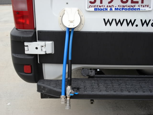

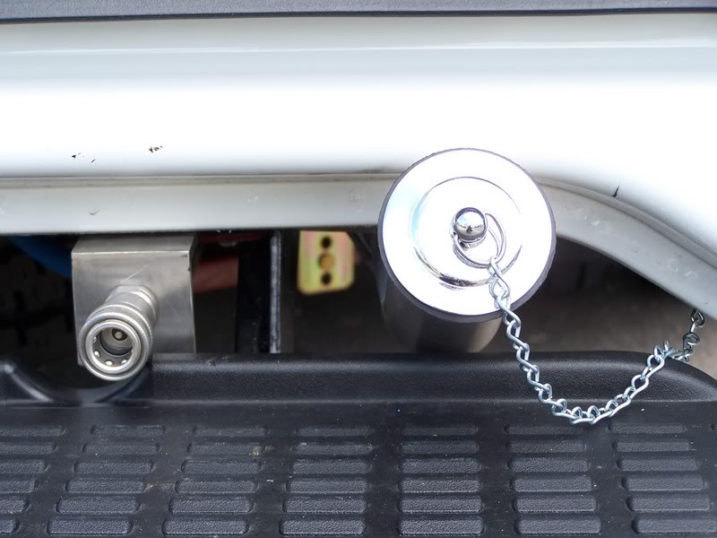

In both the photo above and below, we have ducted the hoses thru the rear door, for the hoses he wishes to run as 'live' setups, or he can unhook them and attach them underneath the van as we have extended the vacuum and solution ports to the rear of the vehicle.
As you would have noticed by the company name on the side of the van, this customer doesn't do any carpet cleaning. He is hard surface cleaning only. So unlike carpet cleaning, where he would be running the Genesis at low RPM's, he is consistently running this machine fully locked up at very high rev's, with no issues. And our temps are similar to what you get down in Alabama. This customer is operating daily between the 100 -100 deg F temp range.

"This customer is operating daily between the 100 -100 deg F temp range. "....................Pretty narrow range isn't in Jim?
Nice set up though.

If that side door had a fan mounted on the inside it would blow air towards the radiator when closed/turned on, that would surely help in addition to all the good ideas already present.
Nice rig!

Thanks for the kind words. Oh and the temp is 100-110 deg F. It is quite warm over here now.
Don't worry Johnno, I am back from Fiji now so the annual leave is over :?
Greenie, there is a fair bit of work that goes on behind that door the enables the Gen 59 to operate all locked up like that. 8) And for vans where we install the machine and hose reel out the back end, we make the hose removable, so that when you want to get in and service the TM, you can simply uninstall the hose reel in a minute, then you have alot of spare room to service things.

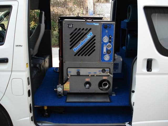

This is my 2003 3500 GMC with doors on both sides. They're not sliding but I love how easy it is to get this in and out. I have a rear mount and can reach anything I need without climbing in. On hot summer days you get plenty of ventilation.

Nice van Shane.
Having doors on both sides (sliding or barn style) are a great idea, nice and practical.
We only have two or three vans in Australia that have door on both sides, due to safety regulations (or so they say!) Most of them, like Mikey says are driven by soccer mums.
I will try and find some photo's of a van that I sold last week to a cleaner a few states away.
Jim

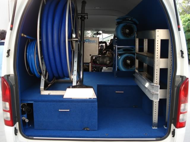

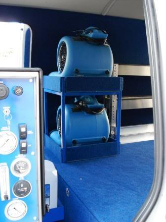

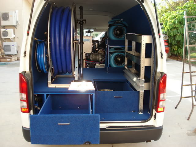

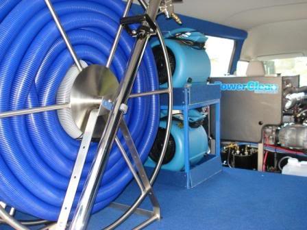

Here is the photo's I was talking about above with doors on both sides. When you mid mount your TM, it makes washing the waste tank out extremely easy as it mount directly behind the machine. You don't have to climb over anything to get to it. You can stand on the ground and reach right into the tank. And setting a machine up like this allows for great airflow, and everything is quite open and easy to service.
This is the largest van we have in Oz, before you upgrade to the larger Iveco, Ford, Mercedes vans (like picture a few replies above) and it has a bit of head room to utilize. So we made a suspended floor so the hose reel goes closer to the roof, and then it gives us the ability to put these drawers underneath the now raised floor to carry all the odds and ends.
With the drawers closed. You can also see some ramps affixed to the side of the stainless steel chemical shelf. Down the bottom right hand side you can see we have extended the vacuum and solution hook ups and ran it under the floor.
In the photo immediately above and below, we can carry 2 air movers on the right hand side in front of the chem shelf, and another 2 in front of the stainless steel vac hose reel.

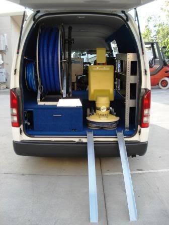

And this is what the ramps are for. Either for wheeling up a dehum, Cimex, portable or whatever without busting your back.
Jim

Sweet set-up! That's what I'm talking about. I really dig the huge hatchback and that interior is tricked out.
royalblue
Nov 19, 2006
7
The van is the latest model Toyota Hiace SLWB (super long wheel base).
One of the more popular tradesman's workhorses in Australia. This model comes standard with sliding doors on each side.

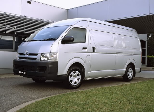

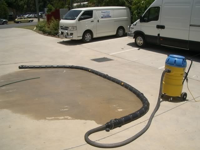

FastEddie said:
Hey Jim,
How 'bout some shots of the van from a distance?
No probs.
This first photo is of the Super Long Wheel Base Hi-Ace, like is decked out in the photo's above.
But the smaller van of to the left in the background of this photo is the most popular carpet cleaning van we have in Australia. I would say upwards of 85% of cleaners over here have a standard length Hi-Ace like this one.
No overly big compared to the vans or extended vans you guys have over your way. That is why we are so neat with our installs (in my humble opinion :p ) Because we have such limited room normally in our vans, to carry everything that is needed for tile and grout cleaning, we have to really think our installs out to be able to make room effectively.
We carry that same philosophy through to the bigger rigs when we are asked to deck them out also, even though we have a lot more room to play with. We would love to deck out a Vortex sized truck out one day.....
However, you really need to get vehicles that you guys can stand up inside. That is why we prefer the larger Iveco/Mercecdes sized vans. At least we can walk up inside them. That, or build a smaller pantec/body on the back of your UD trucks. We can do a lot over here with a smaller truck and smaller pantec configuration.
Jim

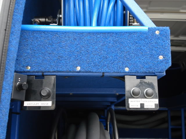

Greenie said:
Those reels are screamin' out to be electric.
Once you have electric, you will never go back....!
I agree Greenie, electric reels are nice, but at the end of the day it still comes down to customers preference. We make it known that we have the ability to set up their reels electric for them, but some guys don't like them.
When we have a customer that does listen to what we say, well......
Electric all the way!
Electric fresh water feed, electric vacuum and electric solution - and all stainless steel as well no less. 8)
And for the larger runs of vacuum hose, we can adjust the rate of speed the motor winds the hose on, so it is not struggling slow when you have out 300ft of hose, and then screaming fast when you only have 20ft left to come back in. You can change the speed whilst on the fly, so it is more manageable.
Jim
