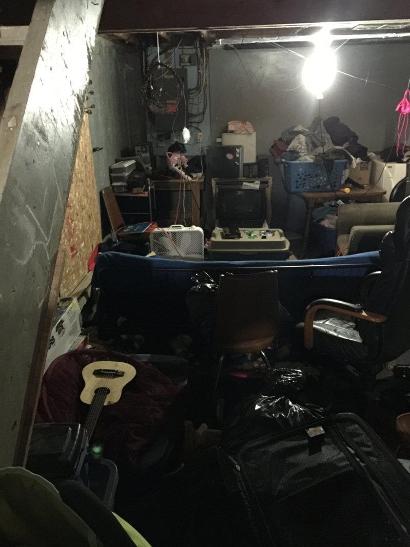

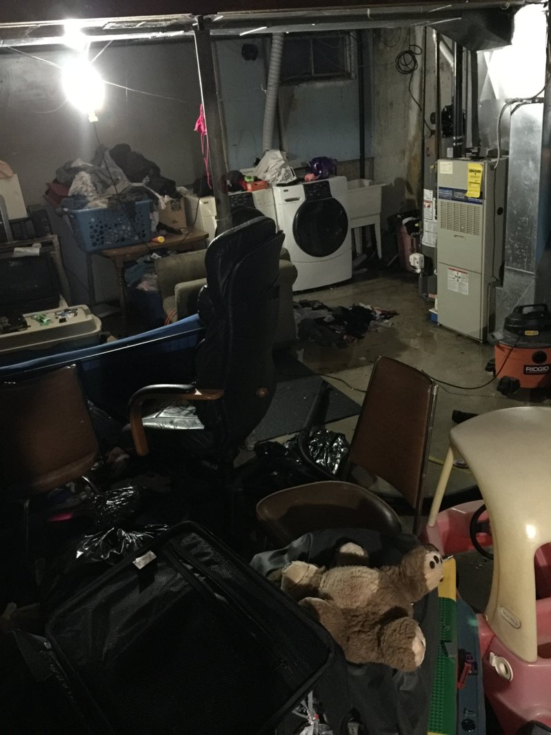

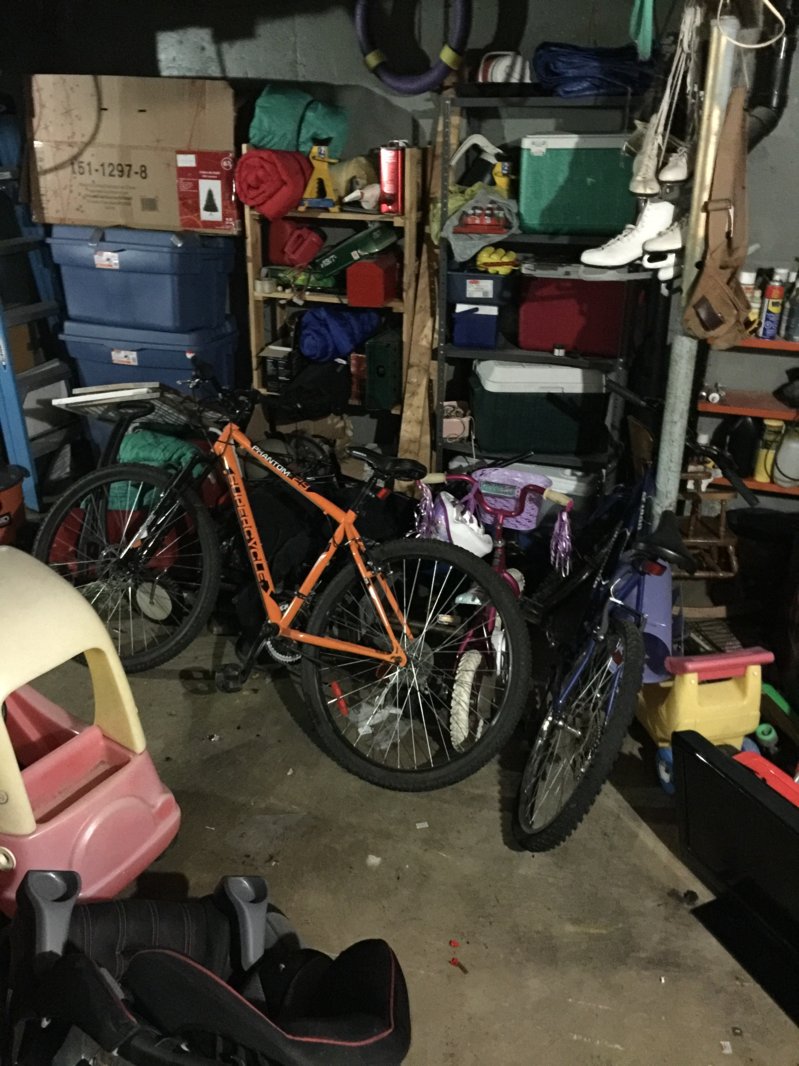

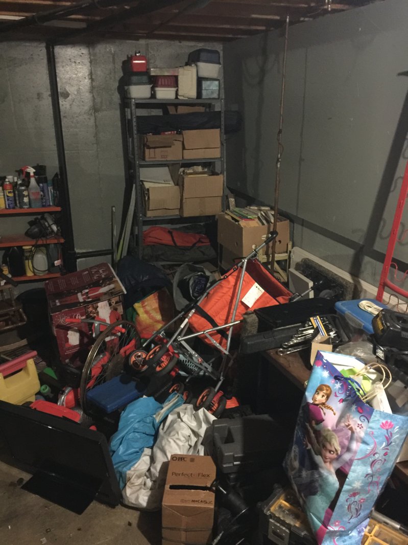

Here is what I found upon arrival. Turns out one of the units has hoarders. The other is pretty well empty. Because everything is contaminated I am having a bin dropped for disposal. I am charging around $2200. Should be about a day and half work with 2 Techs

WOW! Wish I had seen this sooner. You did that for almost nothing. Bio-wash was correct after disposal, but requires fans and Dehus and we always place an airscrubber regardless..... Once you factor, PPE, bags, dumpster, etc, content manipulation... That is easily a $4k-$5k job just using xactimate pricing.....

Thanks Greg. This was a hard situation. The property management company did not want to pay much more then what I quoted. Normally from what I heard they would have just sent over one there employees at 11/h to clean up. Which is no where near the quality or the proper method in this case. I think this is a situation where I'm going to have to educate on what needs to happen for proper remediation to take place.
