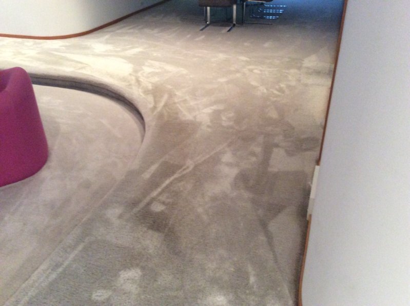

is a winner.
I wish I would have tired this years ago when I had two "i's"...
no streaking and digs like mad..

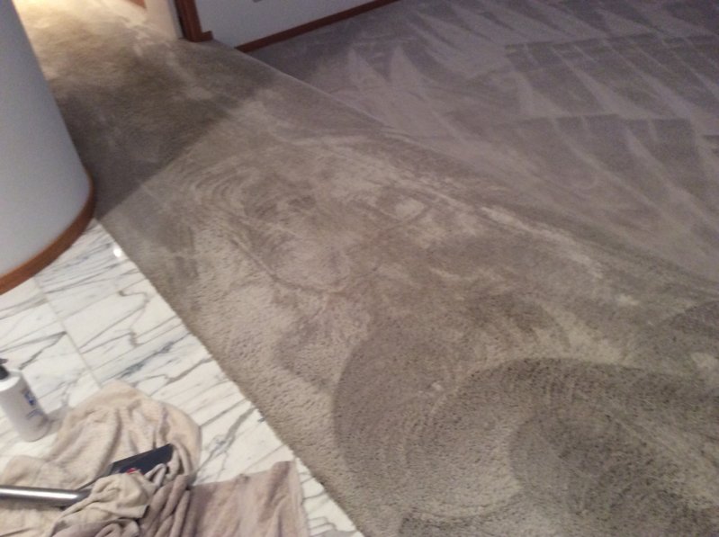

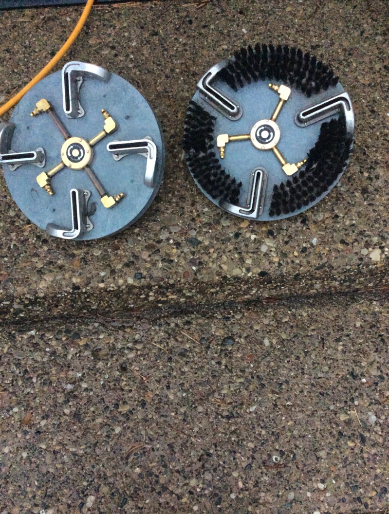

No tip bloom that I have seen, but I always prespray before hand. Plus the brush isn't so stiff that you break it in on concrete like a regular brush head. I tested it against a quad head on a hallway by a sunken living room last week
The brush head (used on the right) is more aggressive than the quad head (used on the left)
But there was no difference in the pile look when I wanded out the swirls.

As I did say, the brush head is more aggressive than the quad head. It is what I have always wanted in a cleaning device. Before I got the 360i I used to (sometimes) clean with both a 175 with a brush and a wand, simultaneously, one in each hand. It was awkward but highly effective on impacted traffic lanes. This brush head 360i cleans even better with ease. With it, you can touch the face of God.
