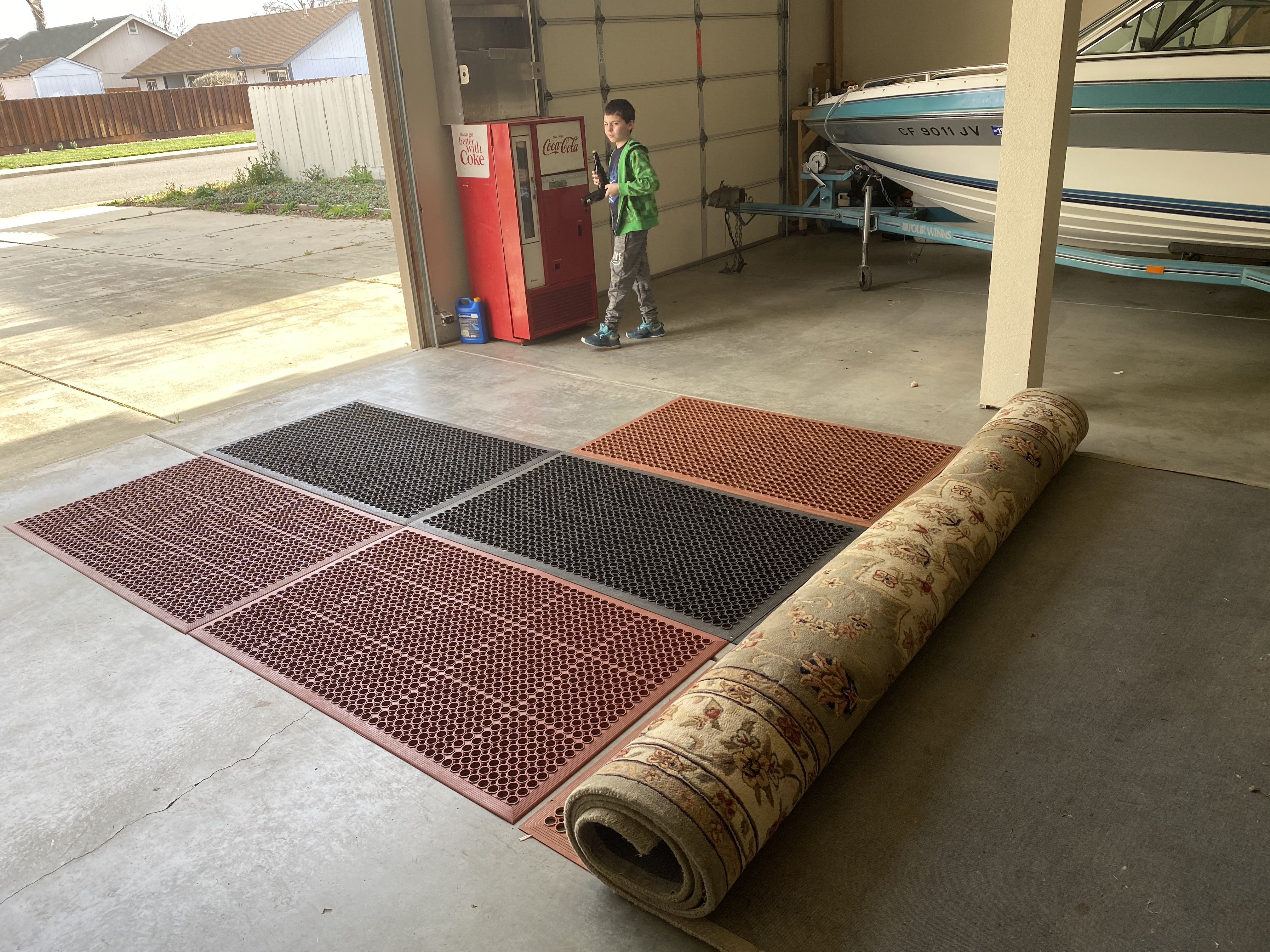

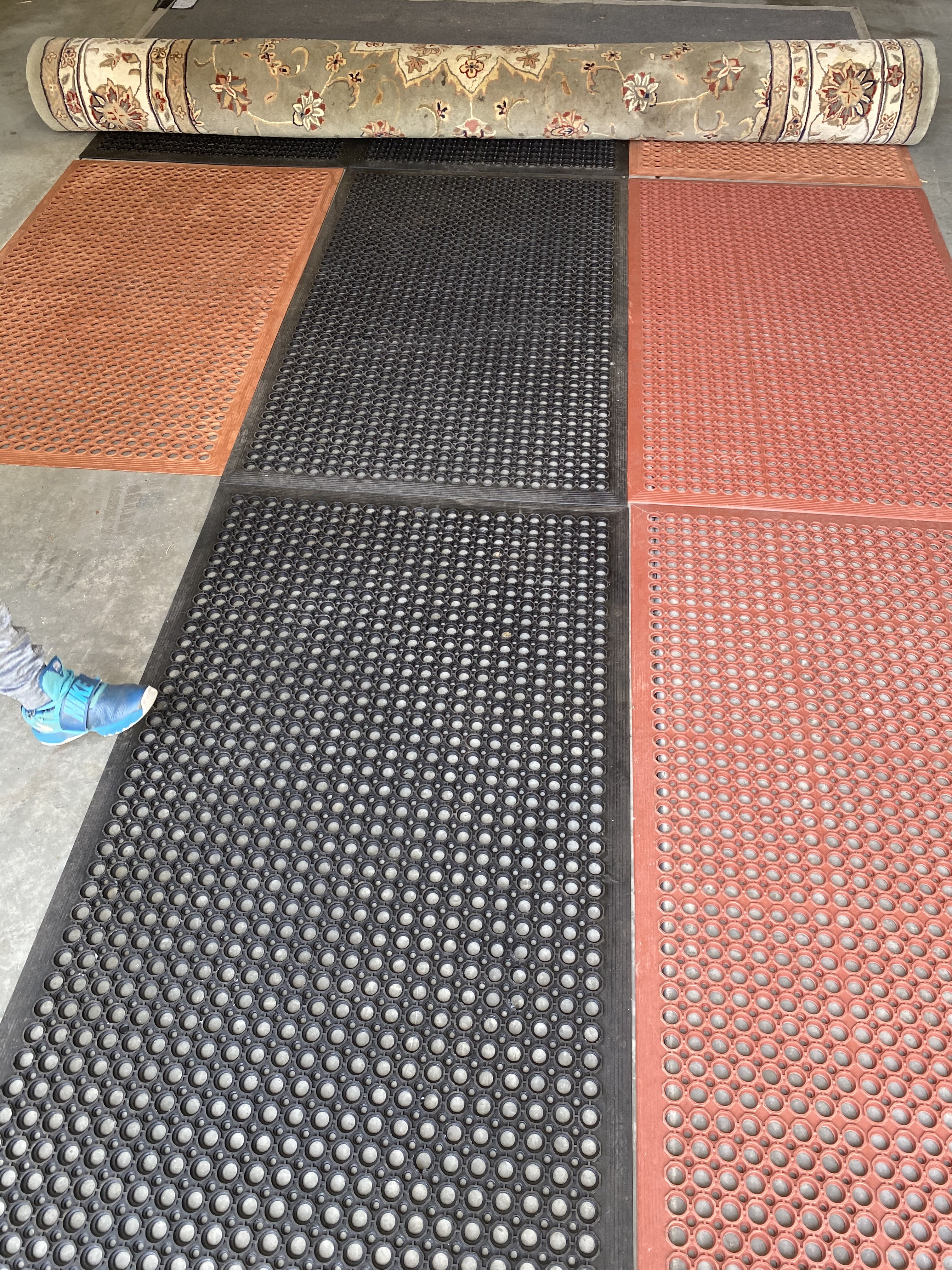

Dusting this big rug today. I’m 1 mat short. Got one coming. Been ordering them one at a time until I have enough. $39 per mat. I’ll use these until I can afford the $500 metal mats that Centrumforce sells. So much equipment needed, but I’m getting the bases covered.

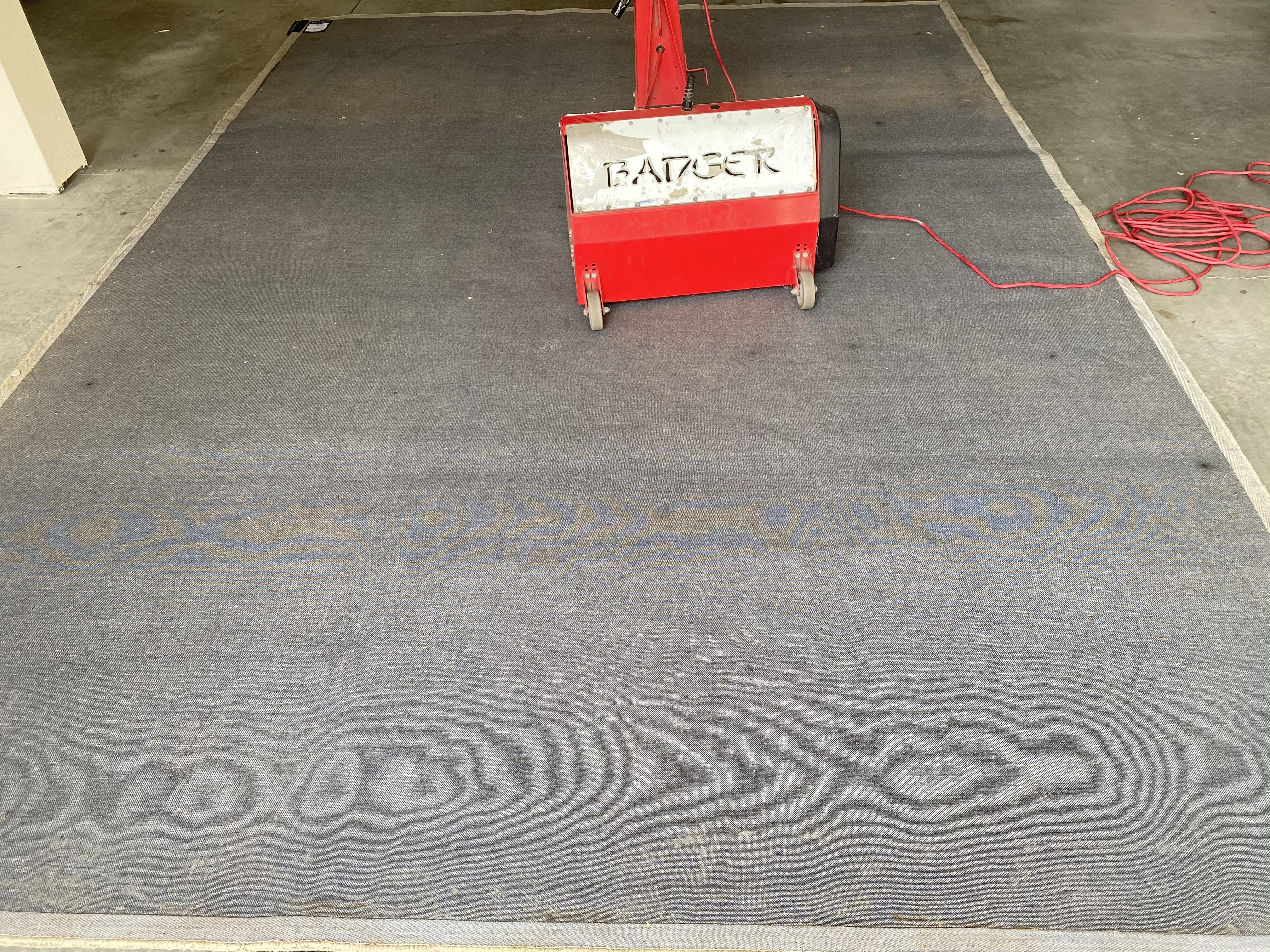

yeah I realise it slaps, but being bdcc I use my upright or occasionally my pile lifter on the back to shake fine dust & grit out.
My pile lfter shakes out more than my vac, but I need to replace a bearing on it as it keeps screaming the end is nigh!

So the metal mat which you REALLY need cost only 100 more than you are spending on 60% less effective substitutes?
Yeah but i can buy them over time and I’m not going to put it on my credit card.
There are two schools of thoughts on the mats. One school says the metal grates are better because they don’t absorb the vibrations. The Lisa Wagner school of thought says the metal grates damage the rugs. What do you think?

You remove more dirt with the metal grate.
"Damage" is often a red herring argument to disguise a competitor shortcoming. Bane Clene "warned" about parts of the cleaning pie they couldn't attain. Wand-only guys "warn" about potential damage from rotaries they don't have.
If the rug can be "damaged" laying on a stationary metal grid, I'd counter that it may be MORE damaged by retained abrasive dirt.

Well damn. Looks like I’ll be waiting a little longer for the metal mats. I’m going to need about $1300 worth. I’ll work on it. Maybe after I install security cameras.
